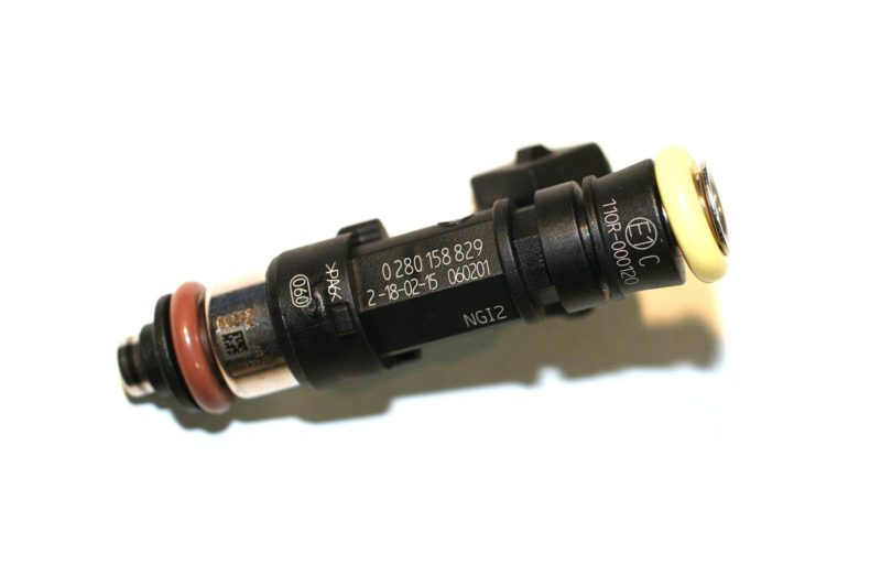

What's up with the tall Bosch 210s that have the EV1 connectors? I had always used the shorty 210's with the denso connectors. Now I see the EV1 units as more popular. Do these still have the SS internals like the short injectors?
Just bought a set anyway... hope they are decent.

Where is everyone getting their Bosch 210's from? I mean actual Bosch not Ebay or Amazon knock offs?
Old Dec 12, 2020 | 03:47 PM
  #36
rel3rd's Avatar
iTrader: (43)
Joined: Nov 2005
Posts: 2,874
Likes: 314
From: Baltimore County, MD.
VS Racing or Carter Motorsports both do, and I believe they both have option for flow matched.
got mine from carter.
Old Dec 30, 2020 | 10:29 AM
  #38
SLOW SEDAN's Avatar
Joined: Jan 2010
Posts: 4,025
Likes: 953
From: No VA
Ebay units have gone 7's powering china turbos, they seem to work fine. Honestly can't even tell between ID2000 and ebay 210's when I hop in a car and throw the data in it, starts right up and purrs either way just one guy has a lighter wallet.
