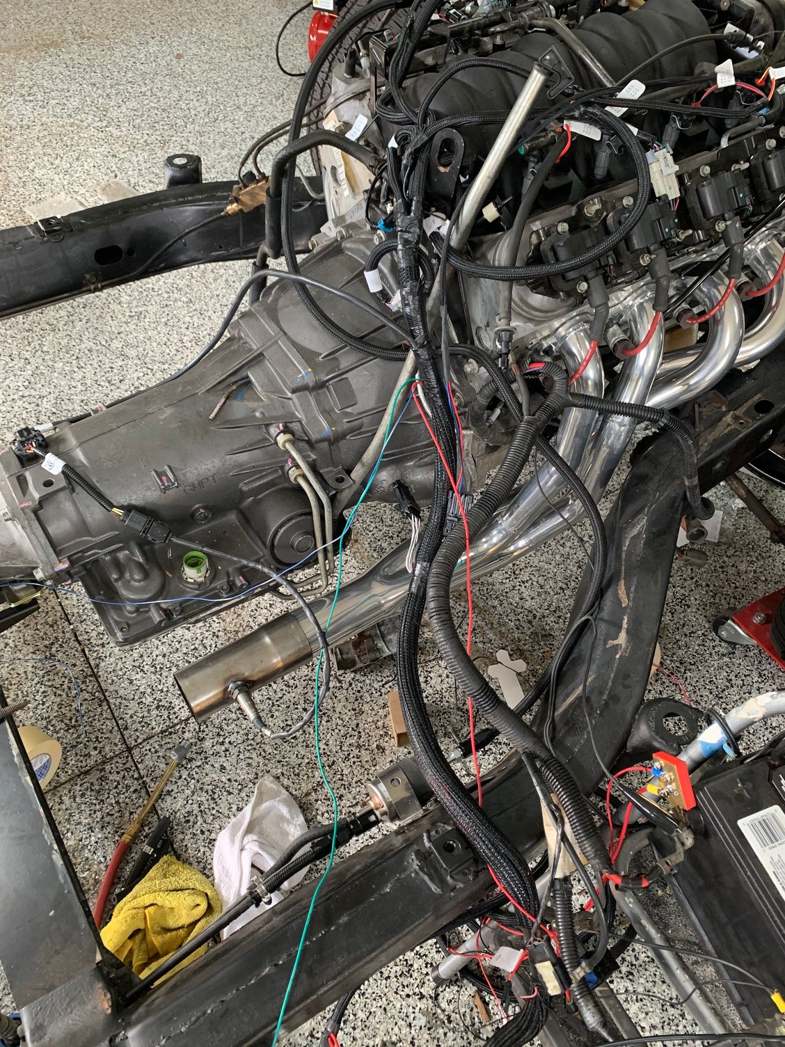

Yes, no point in replacing the hard lines more than you need. I have seen several corvette regulator cars going this route. I snapped you a pic. Excuse the wires. I was testing the engine before I drop the body back on this weekend.
FPR mounted on frame rail.
single feed and return to outlet of corvette regulator using quick disconnect and added a fuel pressure sender for term x.
hard rails to 6AN on the 3/8 side and 1/4 inch iirc on the return side.

Ah I see what you did. How is the hard line sealing to the AN line with just 1 hose clamp? did you form a barb on it? Also is that the stock 1/4" return line and how is is it holding regulator pressure? Did you verify fuel pressure with a gauge on the rail?

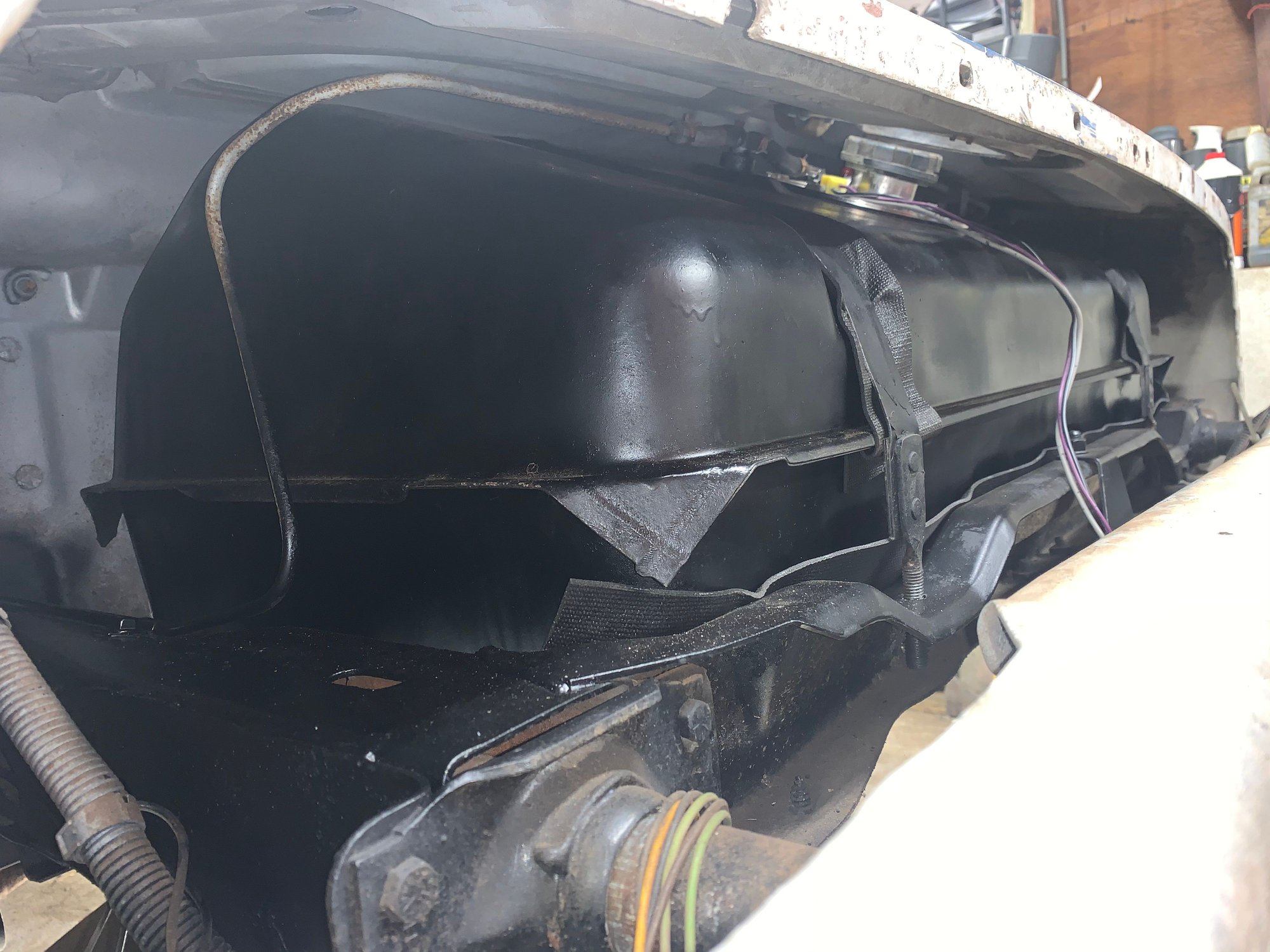

Ended up mounting the regulator/filter by the tank So my mines are all new and I can bypass the 1/4” return completely. tank has been retrofitted with 255 pump. I also got the tank installed as of last night as I have been looking for a decent anti noise kit for the tank but all the reviews say they all suck and are thin. Guys make their own but I realized I had a ton of leftover tool drawer rubber Matt left over (scrap) so I cut it down and used weatherstripping adhesive to glue it down. All done and I even plumbed the PTFE line right along the stock hard line right up to the fuel rail. Need to get some 5/16” hose for the short return and some fittings to finish the rails. Anyone try the amazon evil energy PTFE hose before? Stuff cuts and assembles real nice compared to the much more expensive fragola stuff I have used in the past. Hose looks good too!
