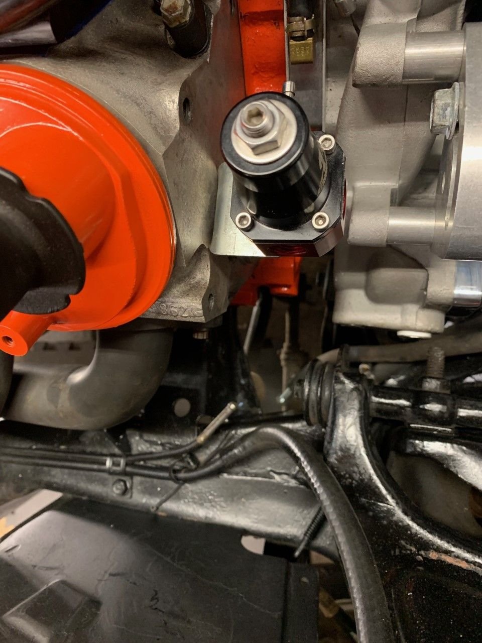

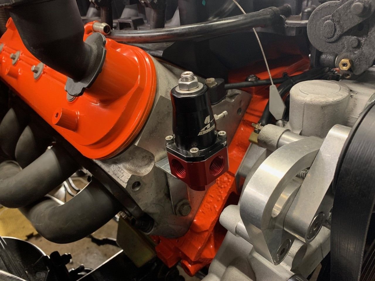

interesting.... My regulator will be external. I have the crossover set at the rear of the intake and regulator mounted to the front pass head. Not enough room on the front driver side or the rear pass side so that left me at the rear driver or front passenger but off the rail as all the throttle linkage is in the way. See pics, plus the OEM pressure and return line are right there on the frame rail so I was hoping to run short lines to the rails.
