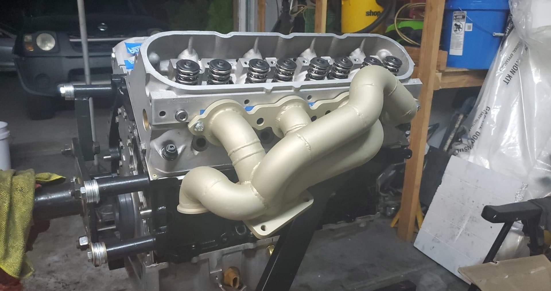

Finally starting my build after finishing wifes car so I'll post it up now. Car is a 2004 C5 6 speed. Started out an A&A supercharger car making 635hp on a stock LS1. Ran a 10.99@134 the one time I've taken it to the track. I saw a great deal on a new Huron kit so I sold all the A&A stuff. Practically entire car is coming apart and a paint color change too. This will be my biggest all at once build. Been collecting parts id guess for 6 months.

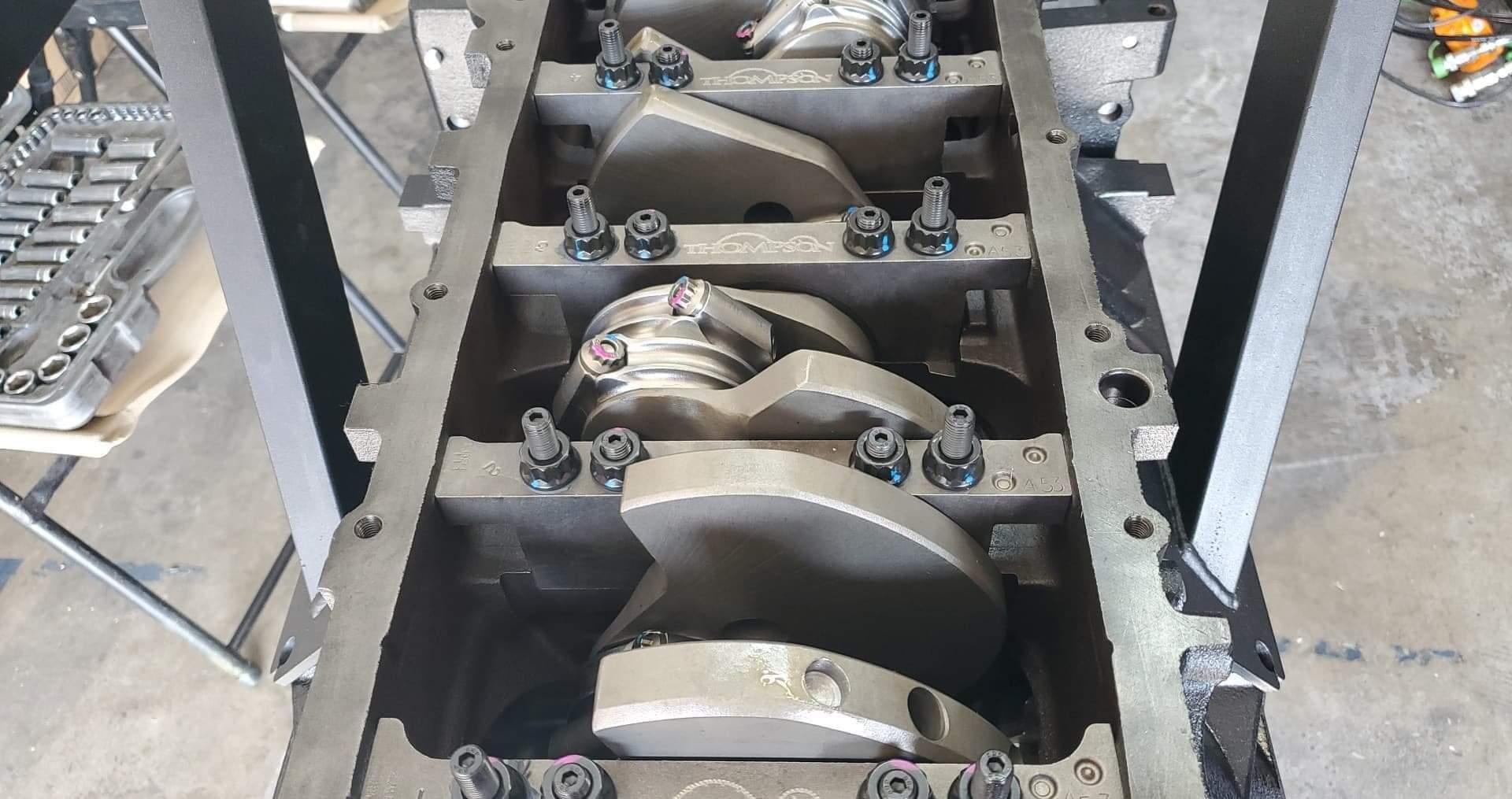

Thompson iron 5.7 with K1 crank and rods, Diamond pistons, ARP everywhere
Summit stg 2 turbo cam
317 heads w/ ARP studs and LS9 gaskets
Johnson link bar lifters
BTR springs
Precision Shaft 1000hp aluminum driveshaft
3.42 3 rib diff with C6Z guts
​​Mcleod RXT w/ stock 120k mile T56 lol
ECS torque tamer and diff brace
Solid mounts everywhere
Brett specd return fuel system using stock C6Z fuel pump module and intank 525
Bosch 1000 injectors
Huron Speed twin turbo kit w/ Precision 6262s, Huron wastegates, Turbosmart bov
Haltech package w/flexfuel from Brett running alongside stock pcm for emissions ****.
ACP carbon fiber heat extractor hood (******* expensive but the fit is amazing) along with an authentic Tigershark bumper for some good airflow
Widebody running C6Z wheels with 345/30r19s
Corbeau A4 seats
Doing a complete color change to House of Kolor Lapis Blue

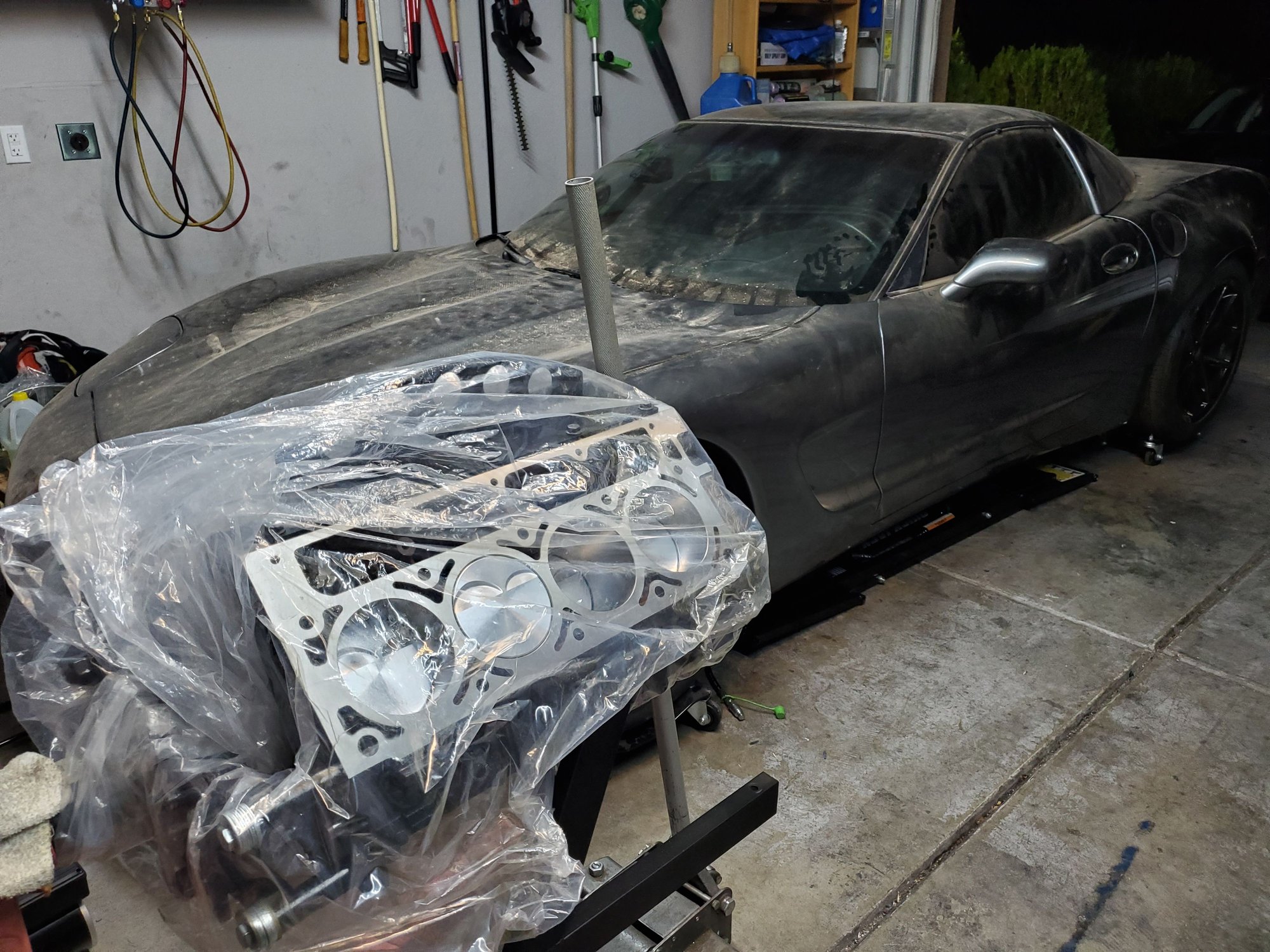

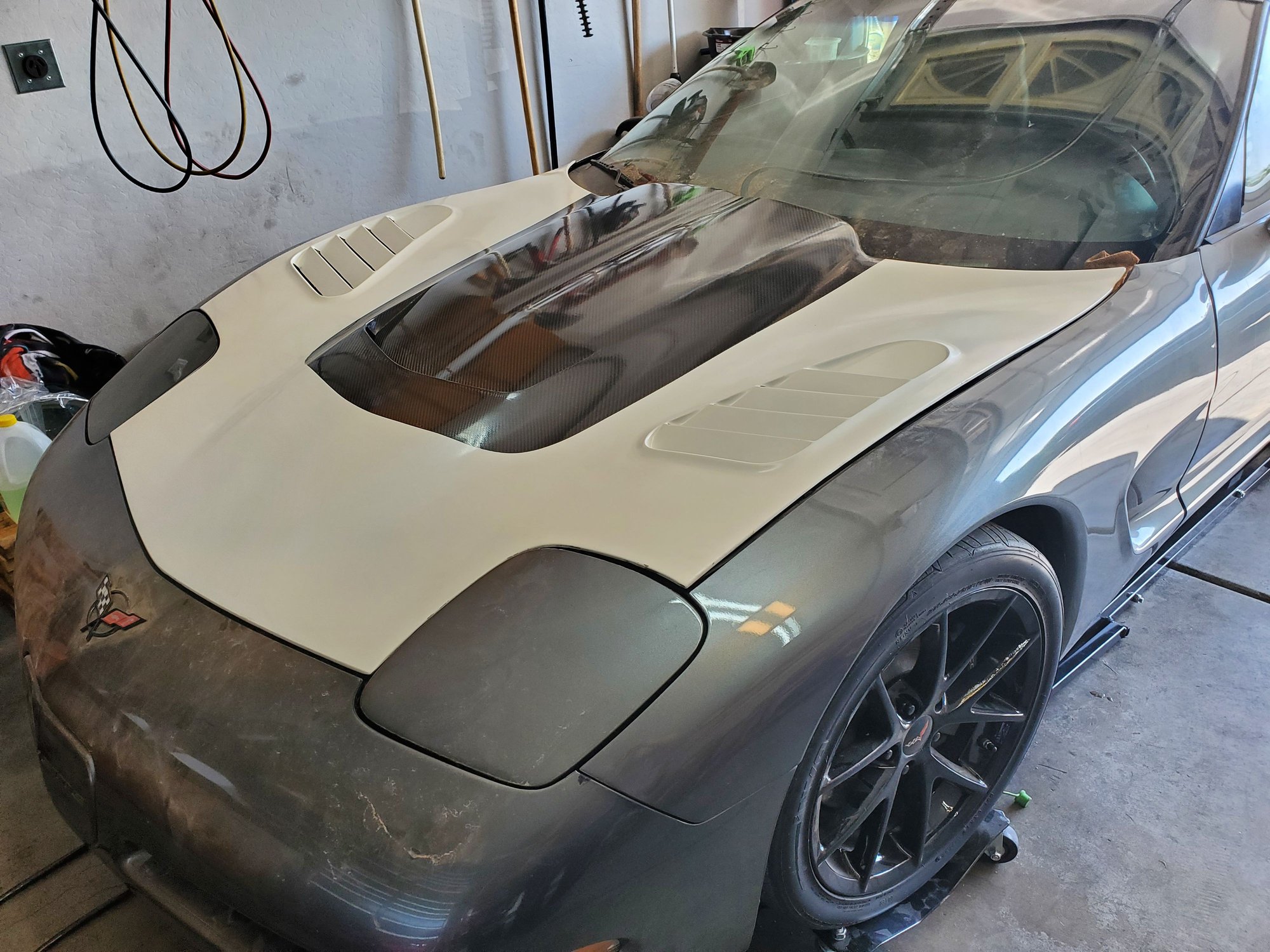

Cars been sitting for a while collecting dust but here's a couple pics to start out with. I absolutely love my hood and not cheaping out saves a bunch of headaches lol.

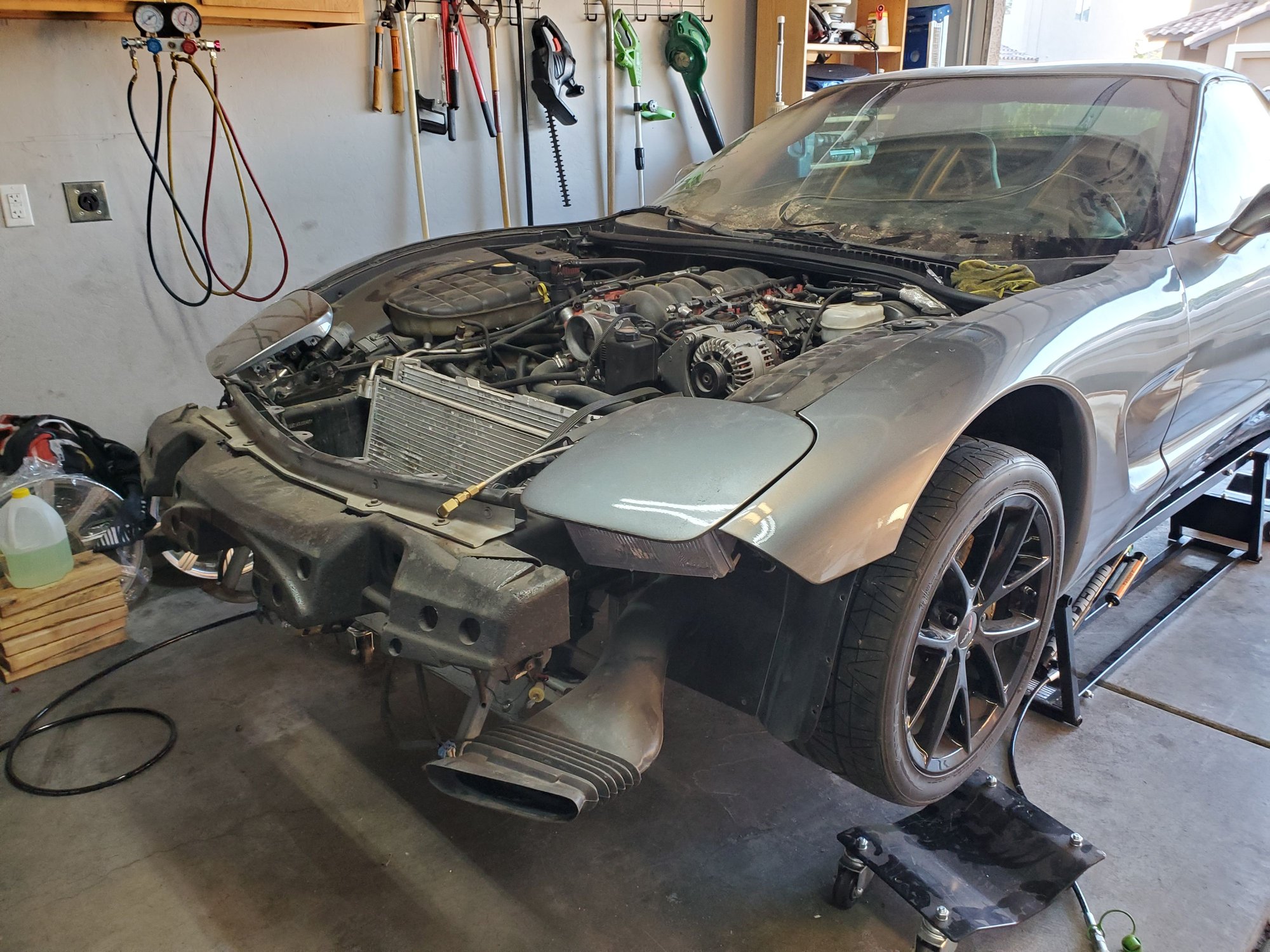

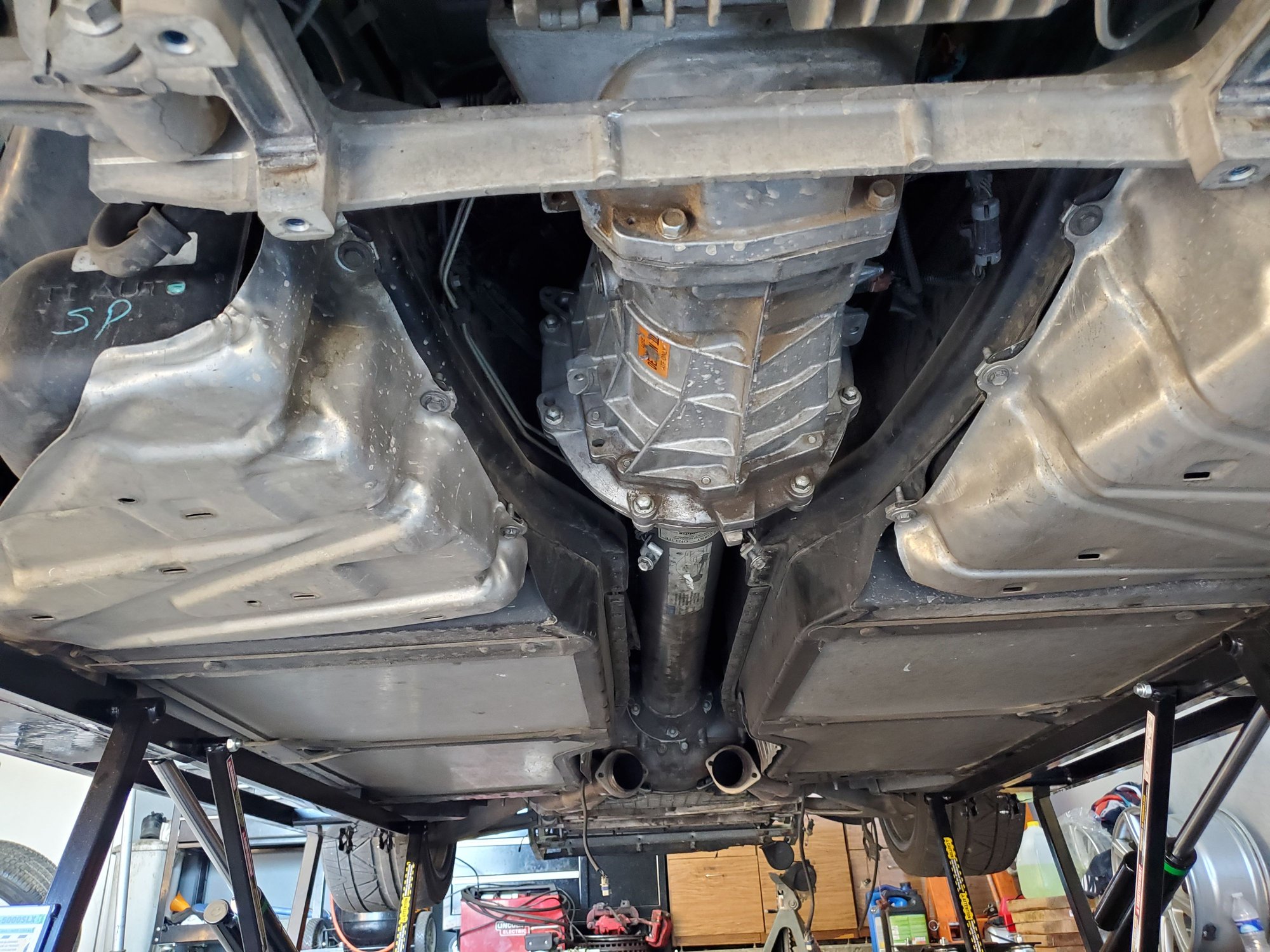

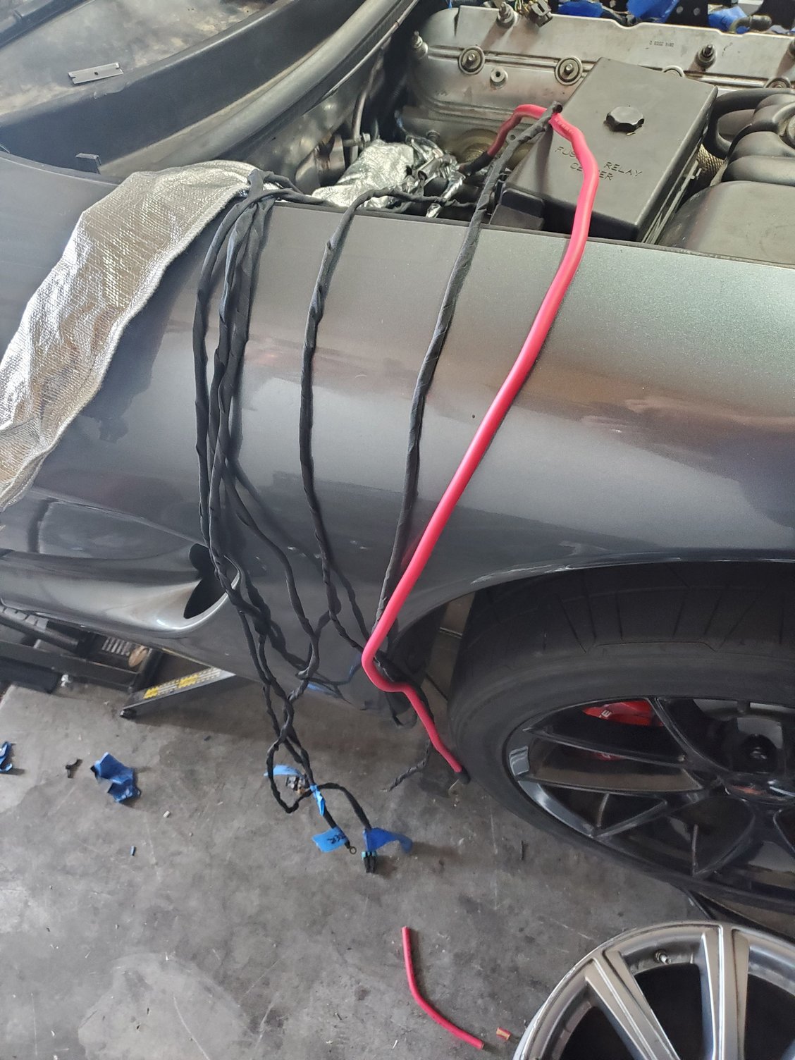

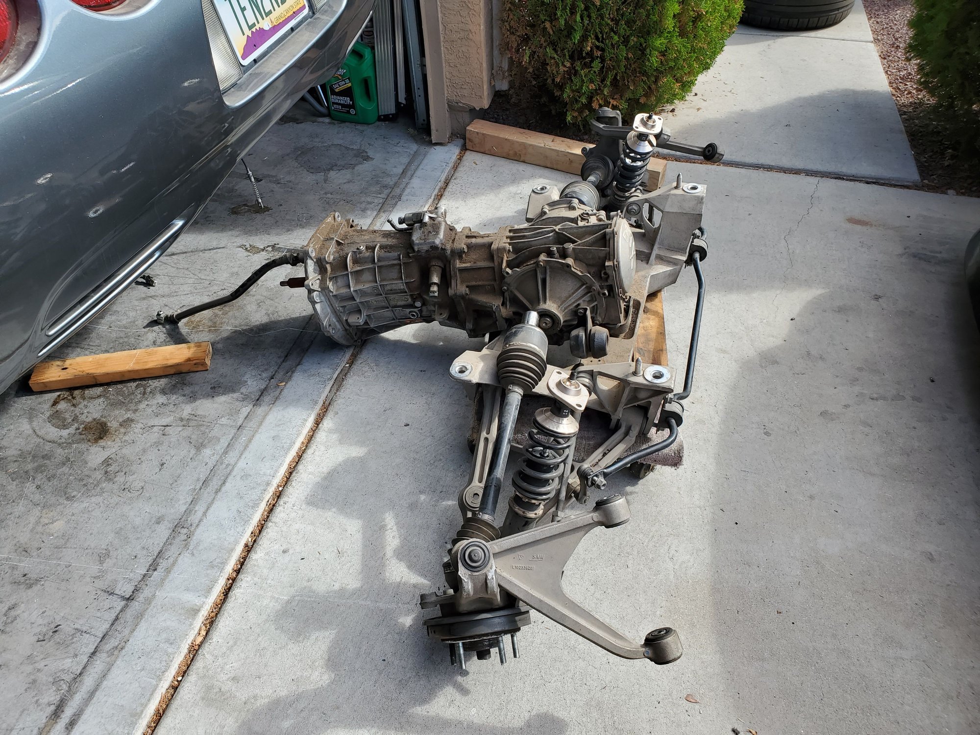

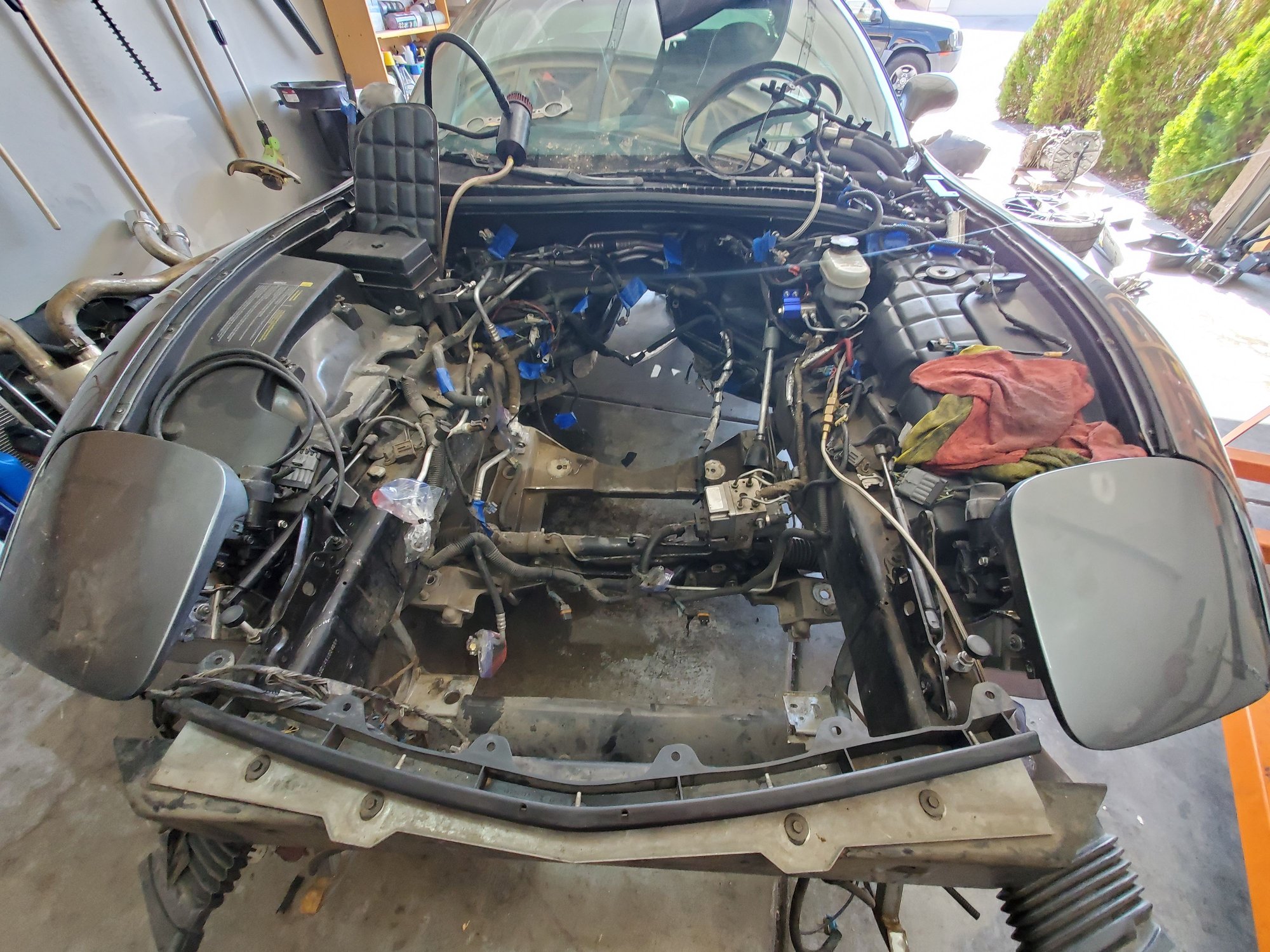

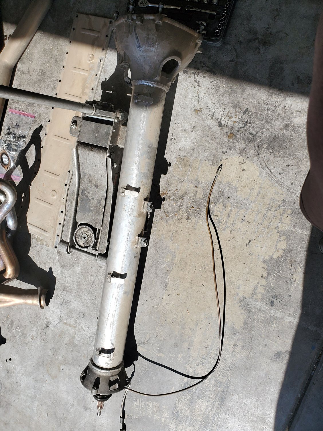

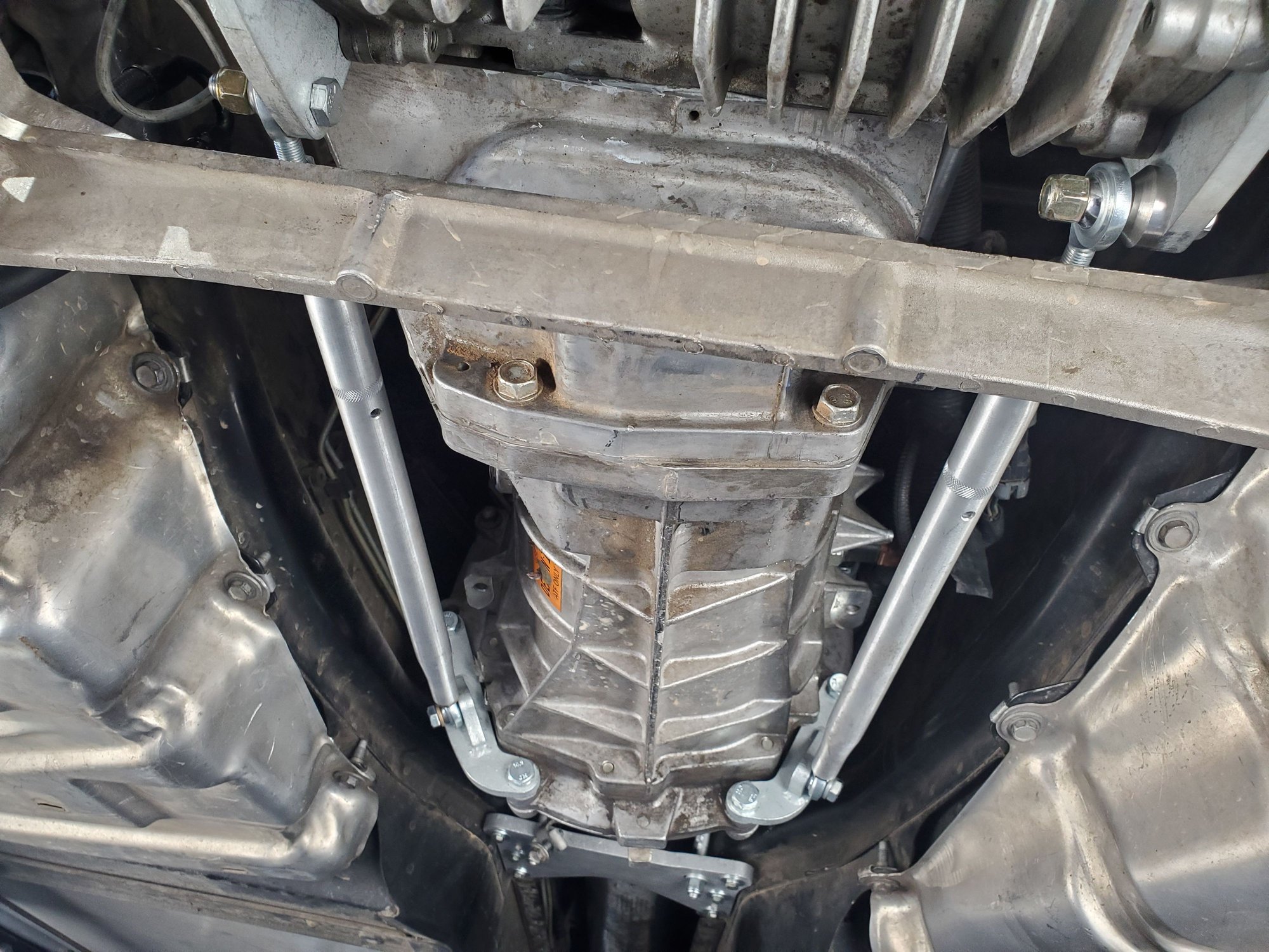

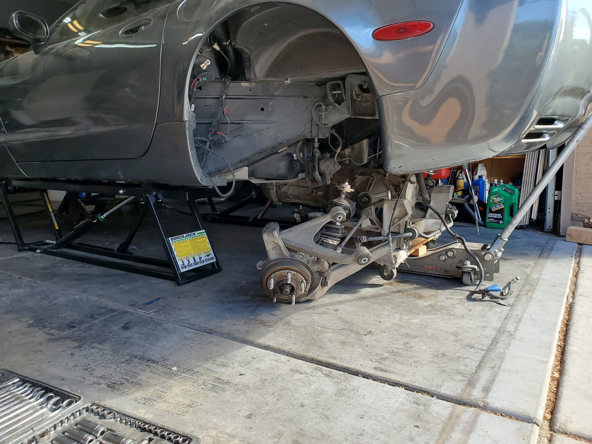

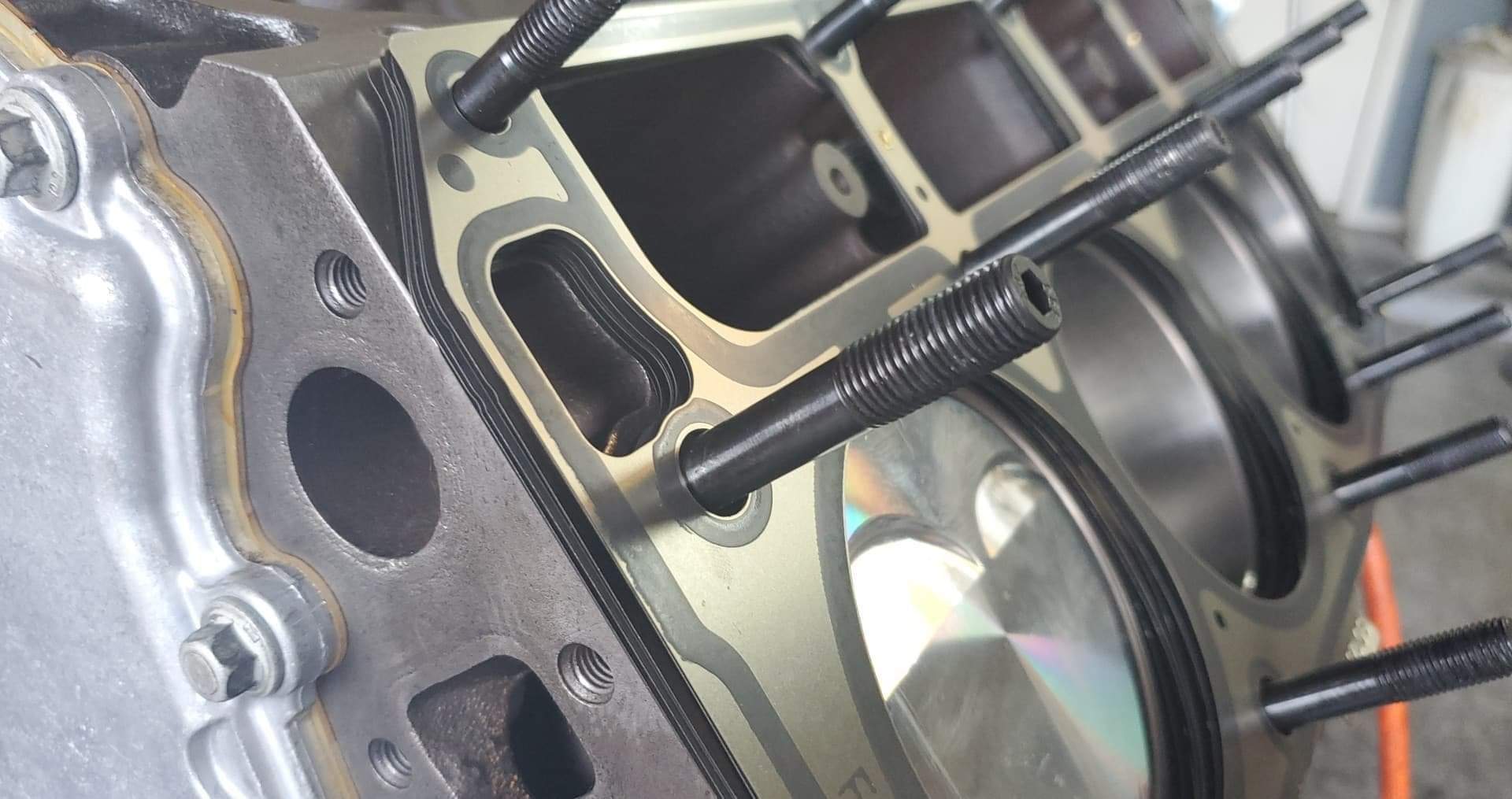

Started yanking some things apart this morning. I think Sunday ill drop the rear cradle, remove diff/trans, torque tube, and clutch.

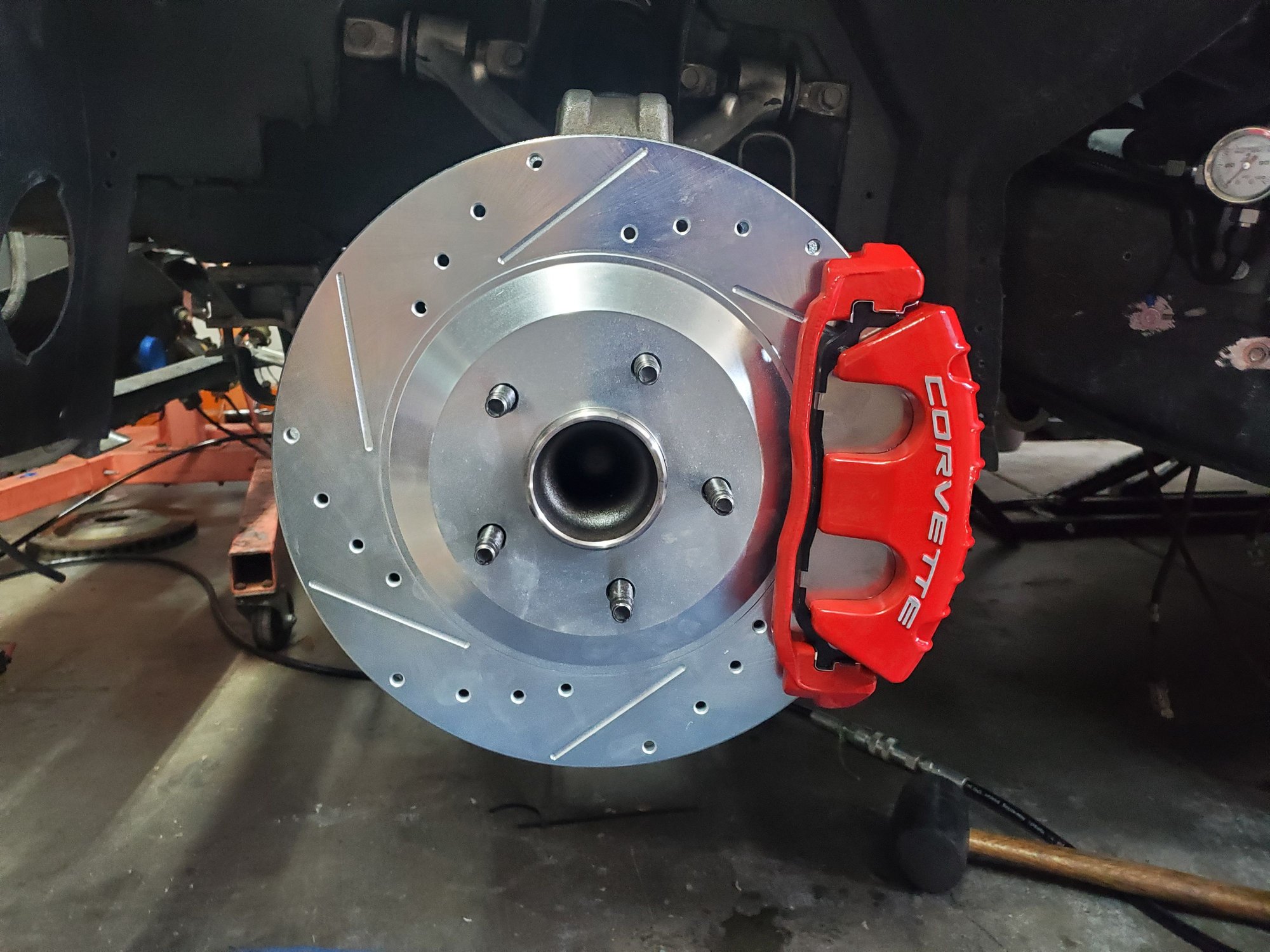

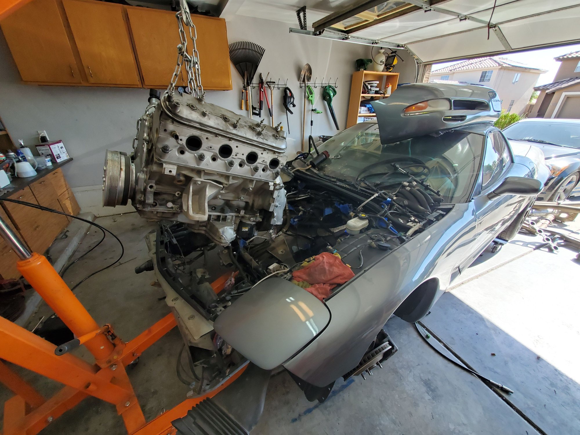

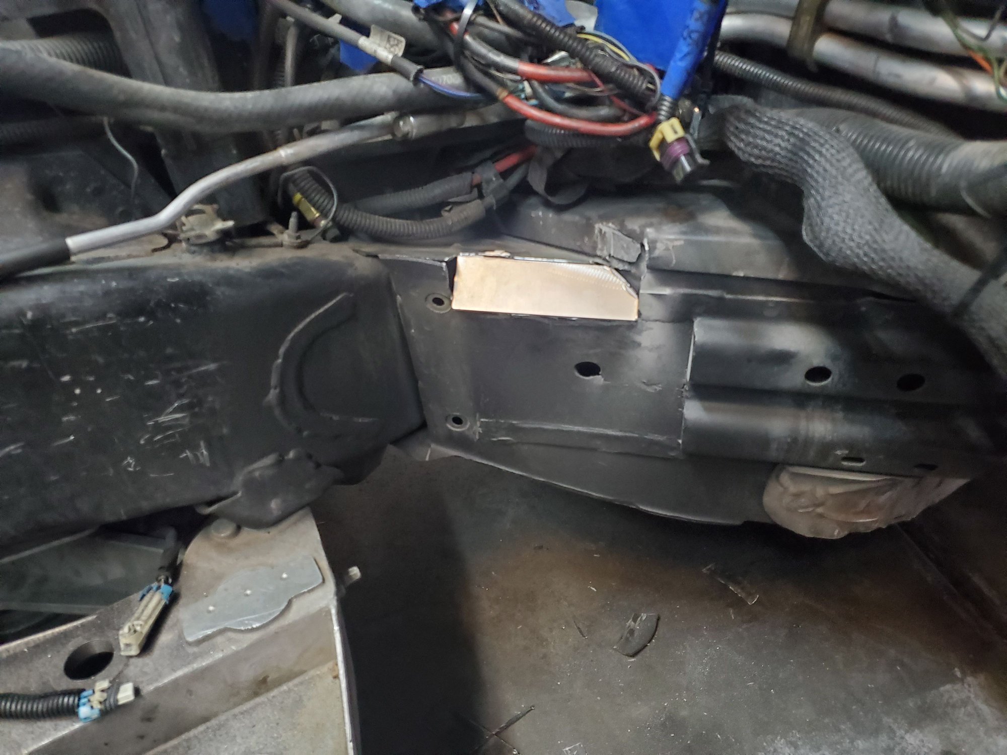

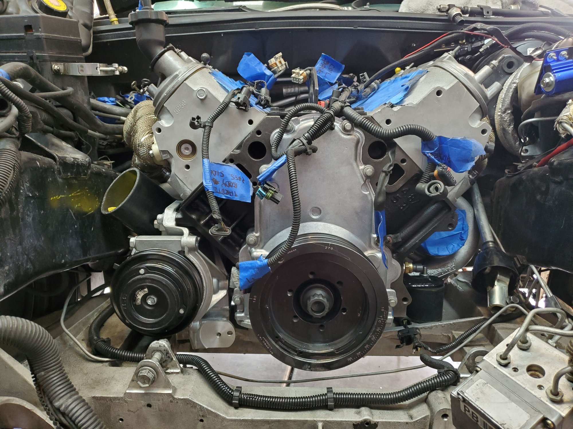

More teardown.

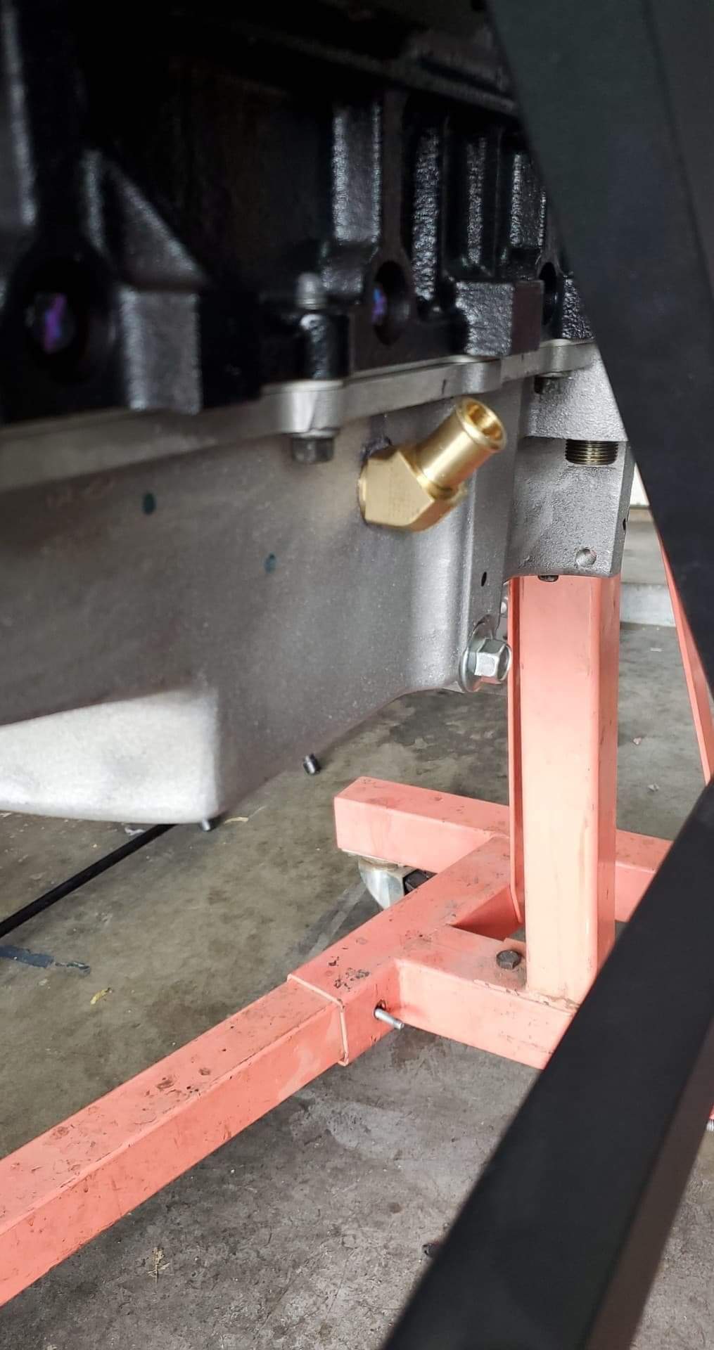

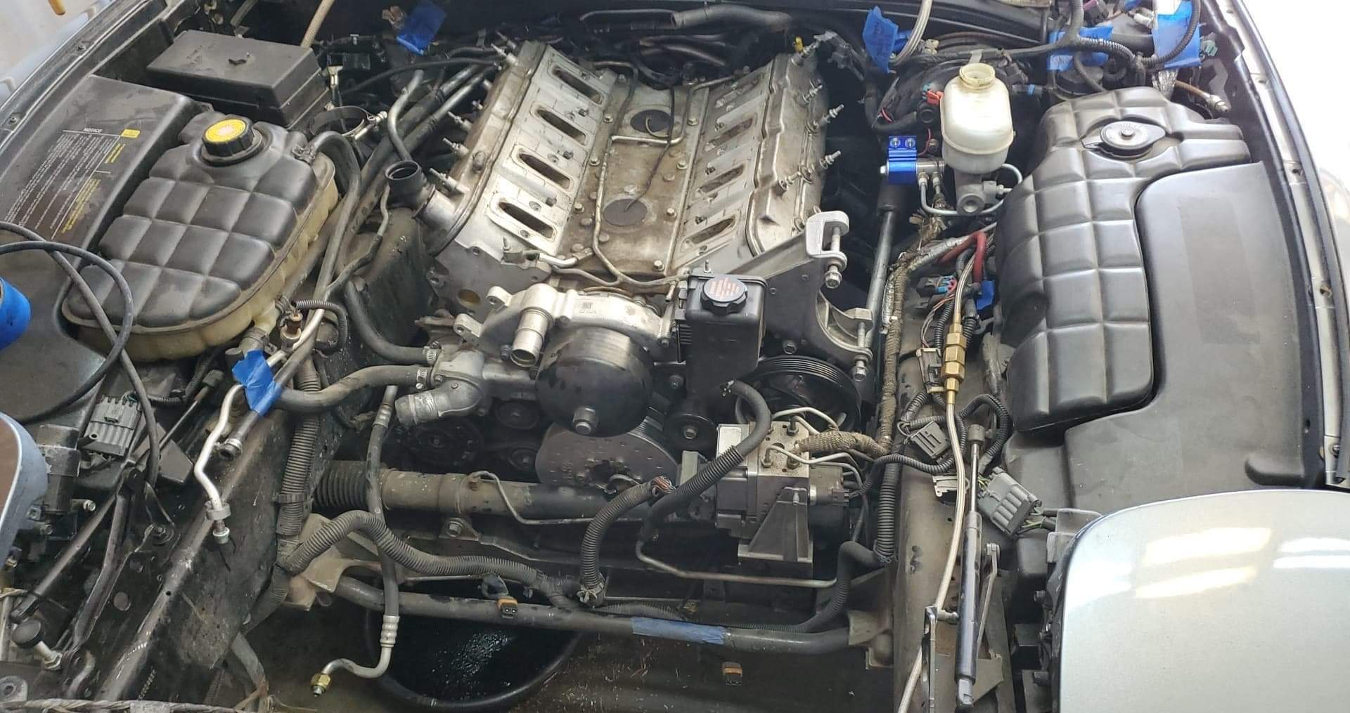

Moving right along.

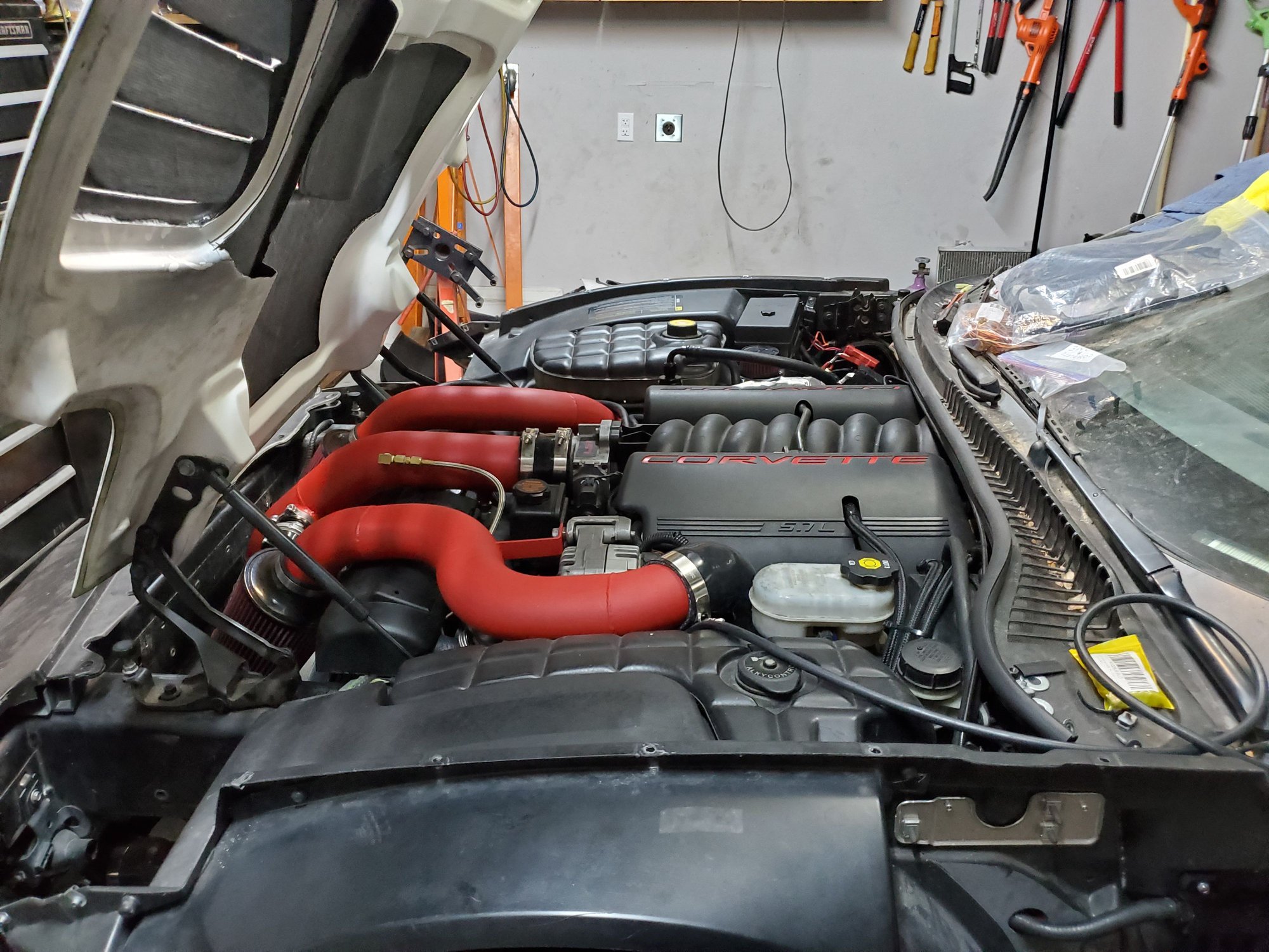

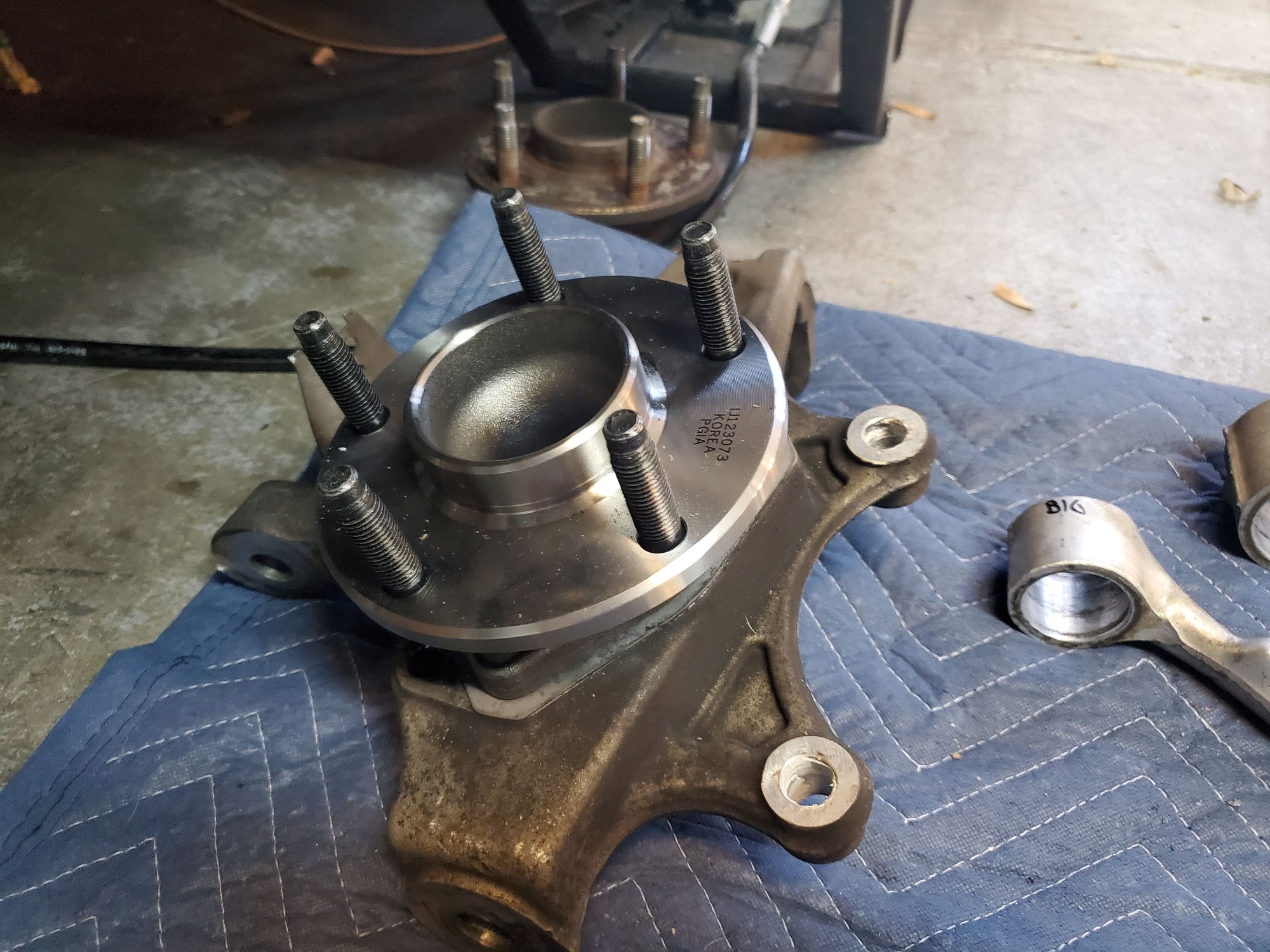

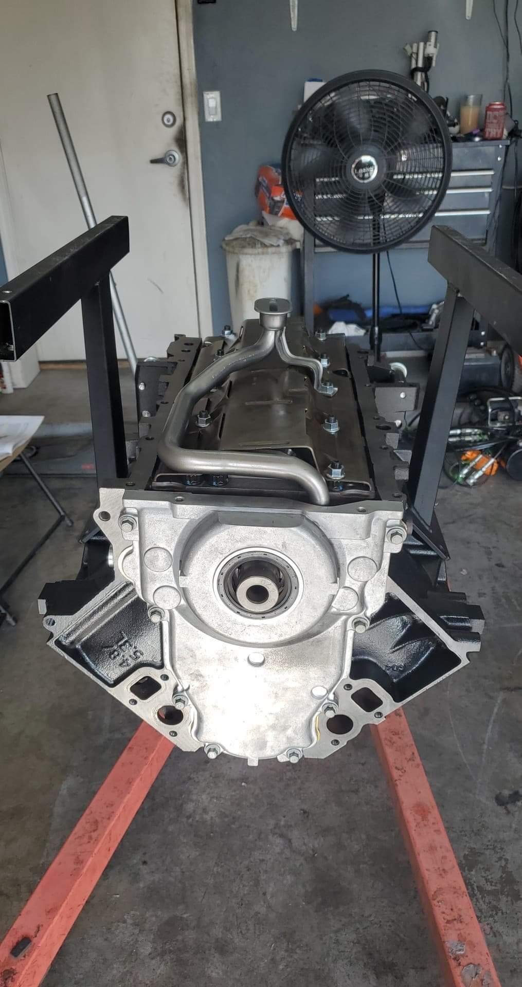

Little bit more.

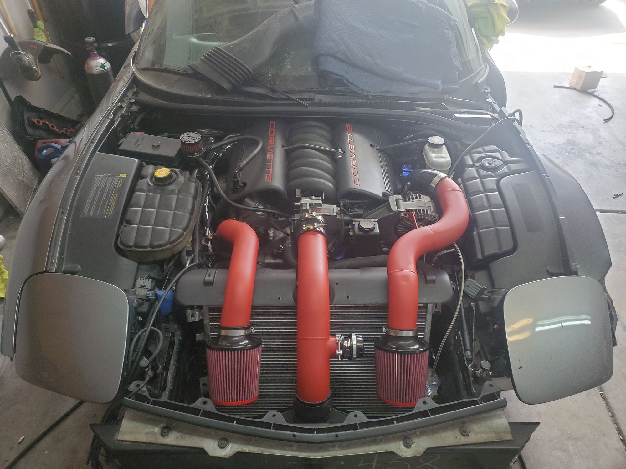

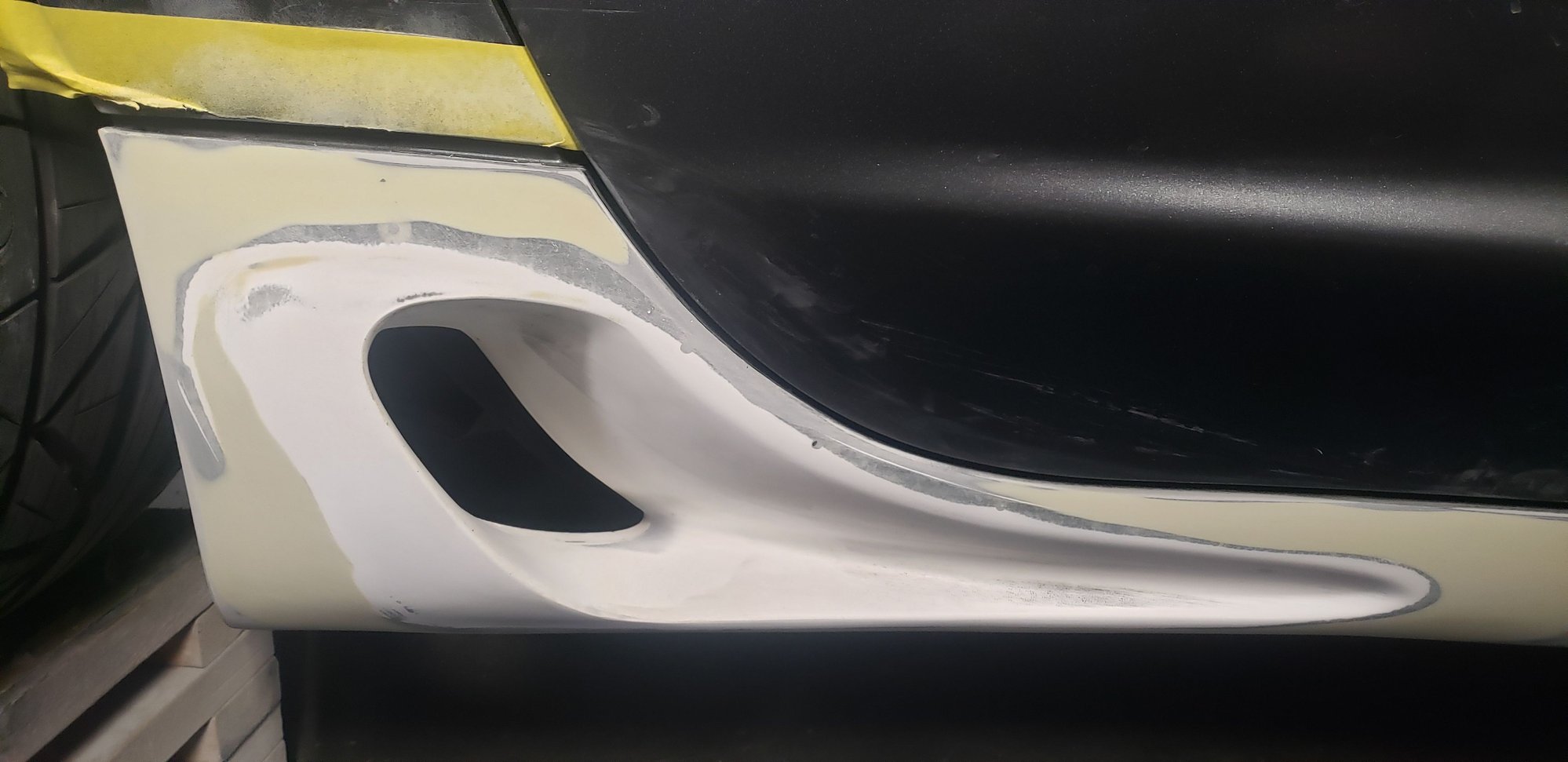

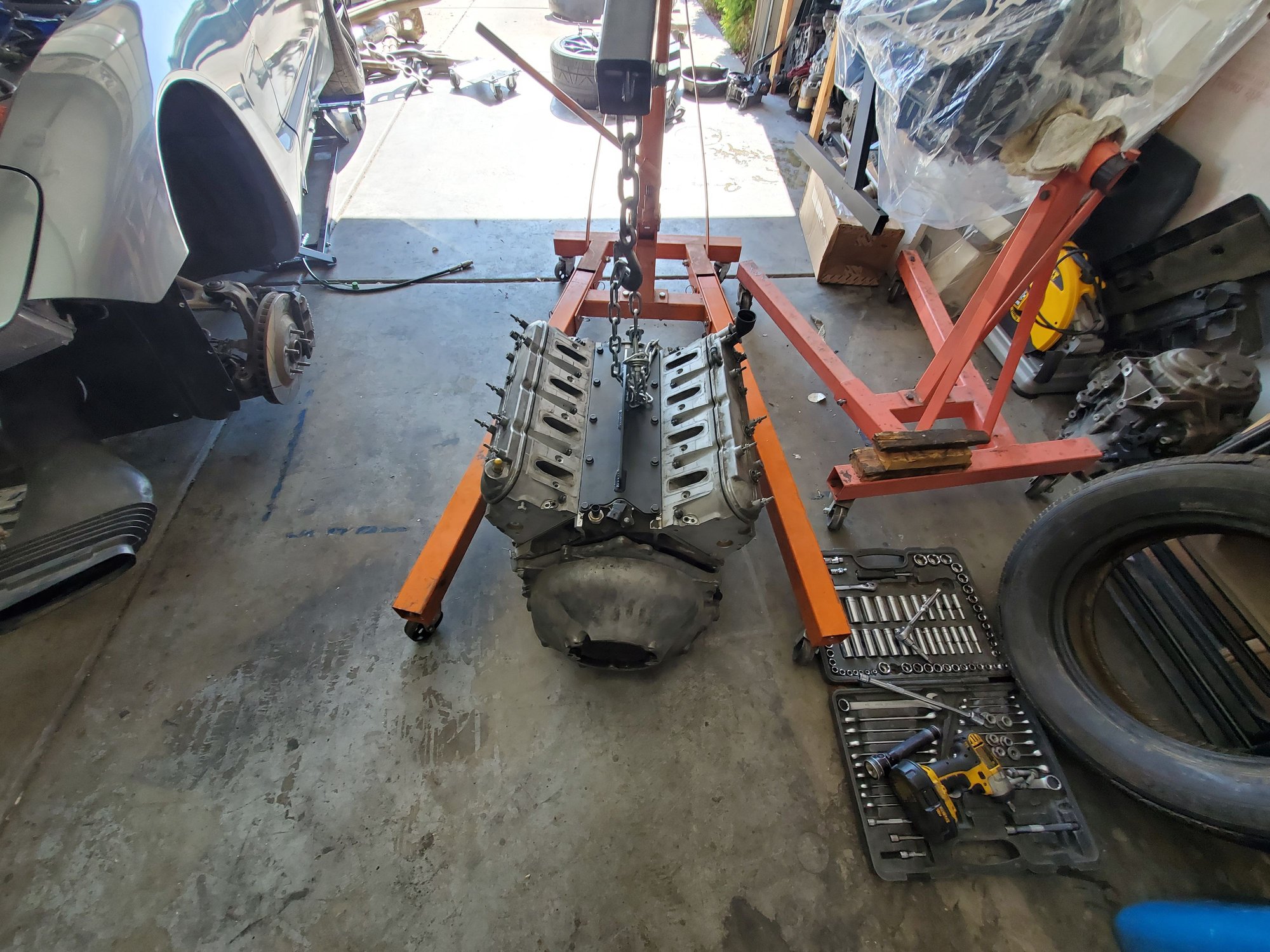

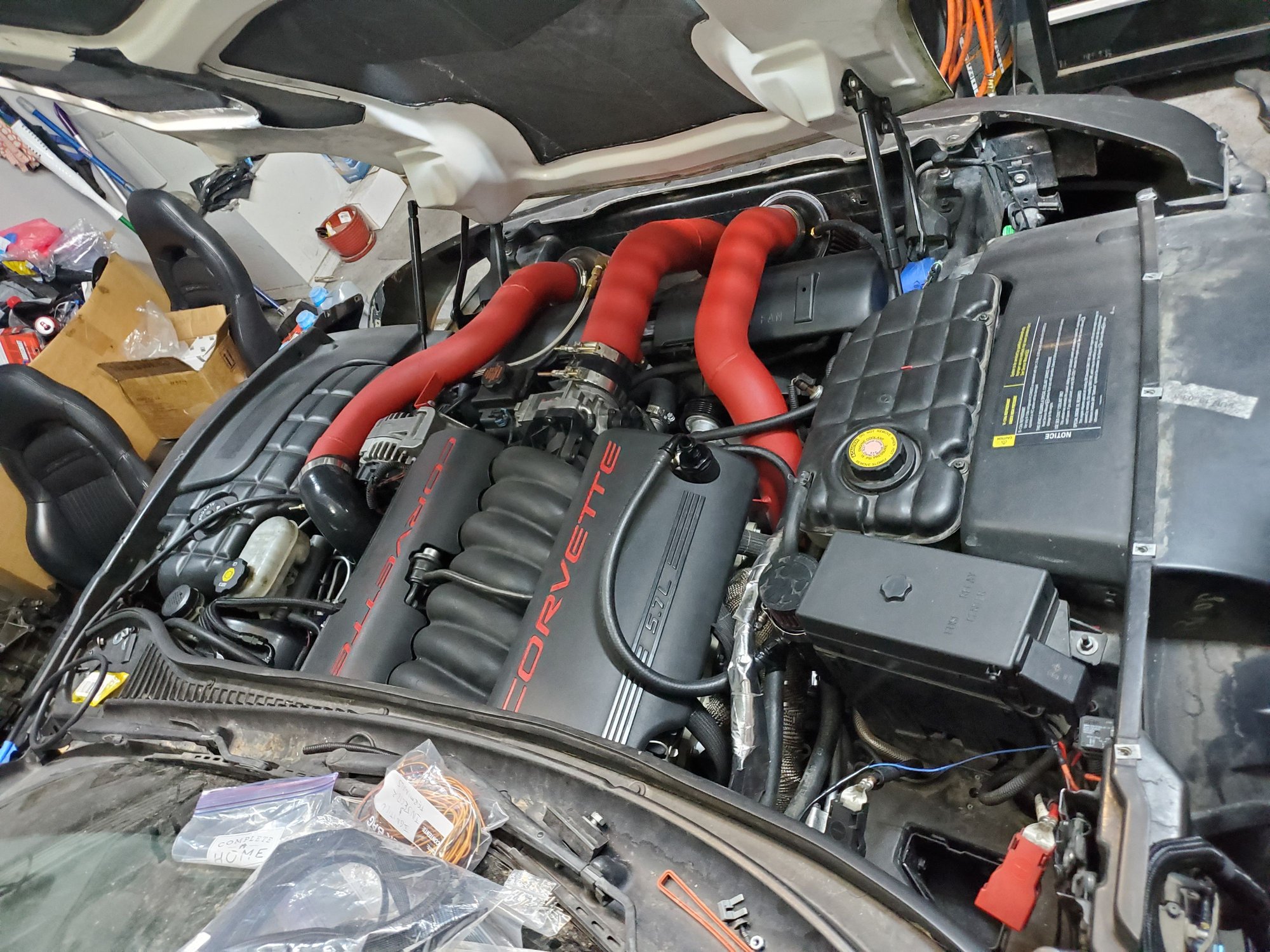

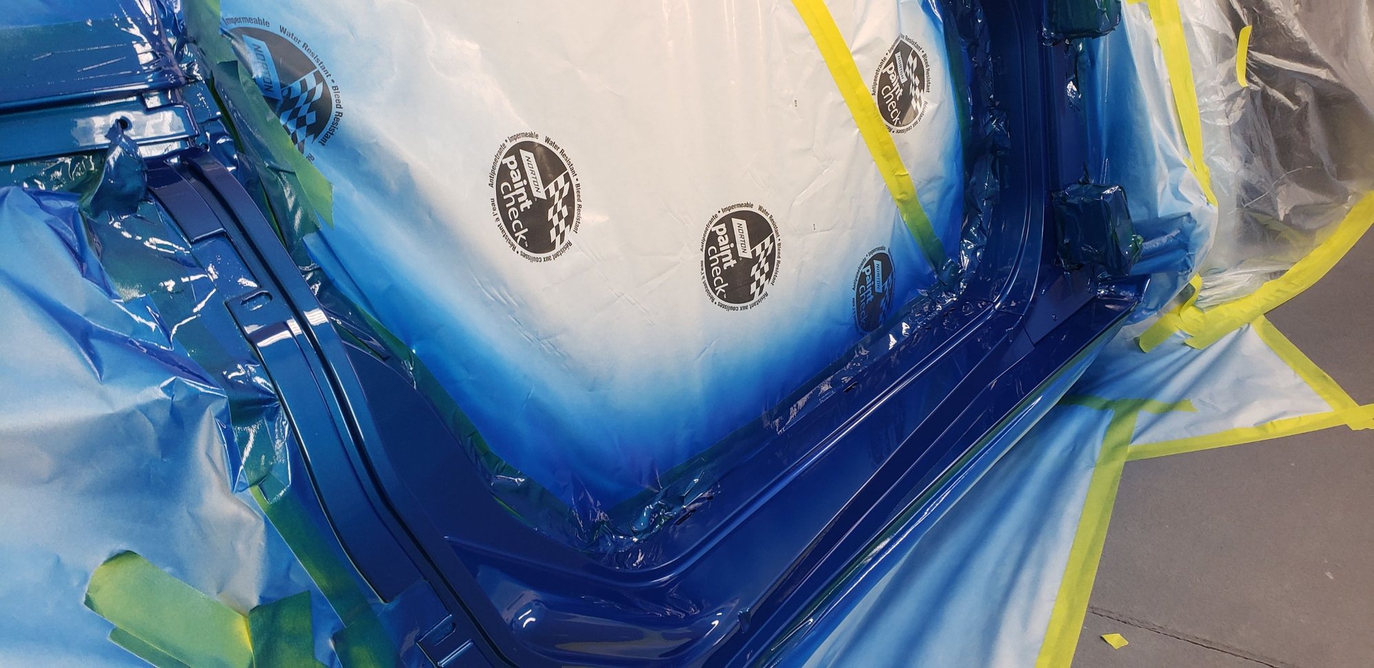

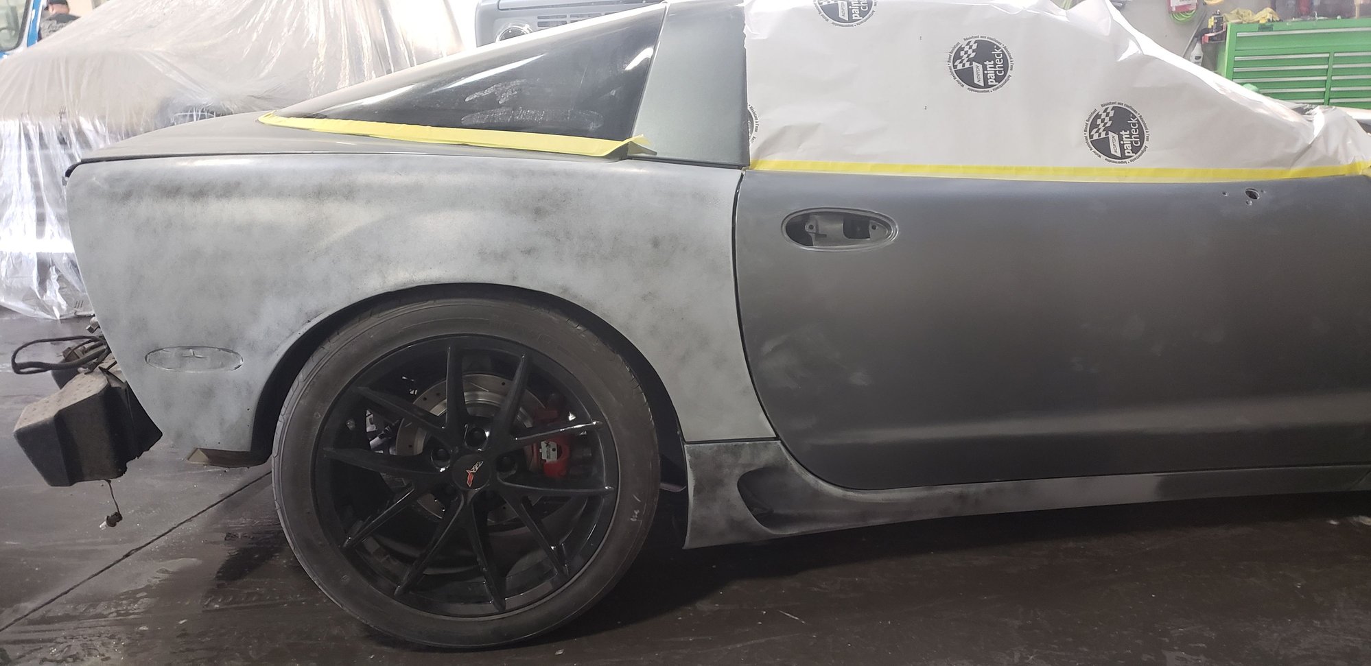

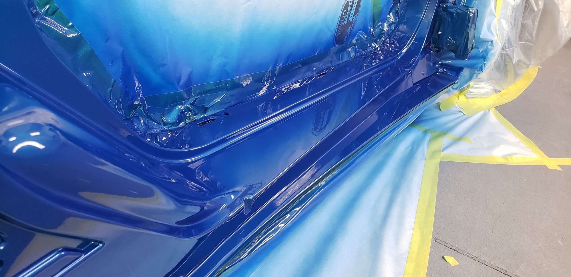

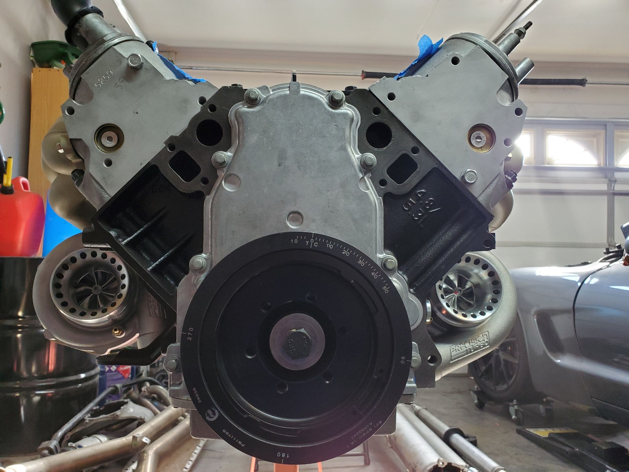

Car has come a long way.

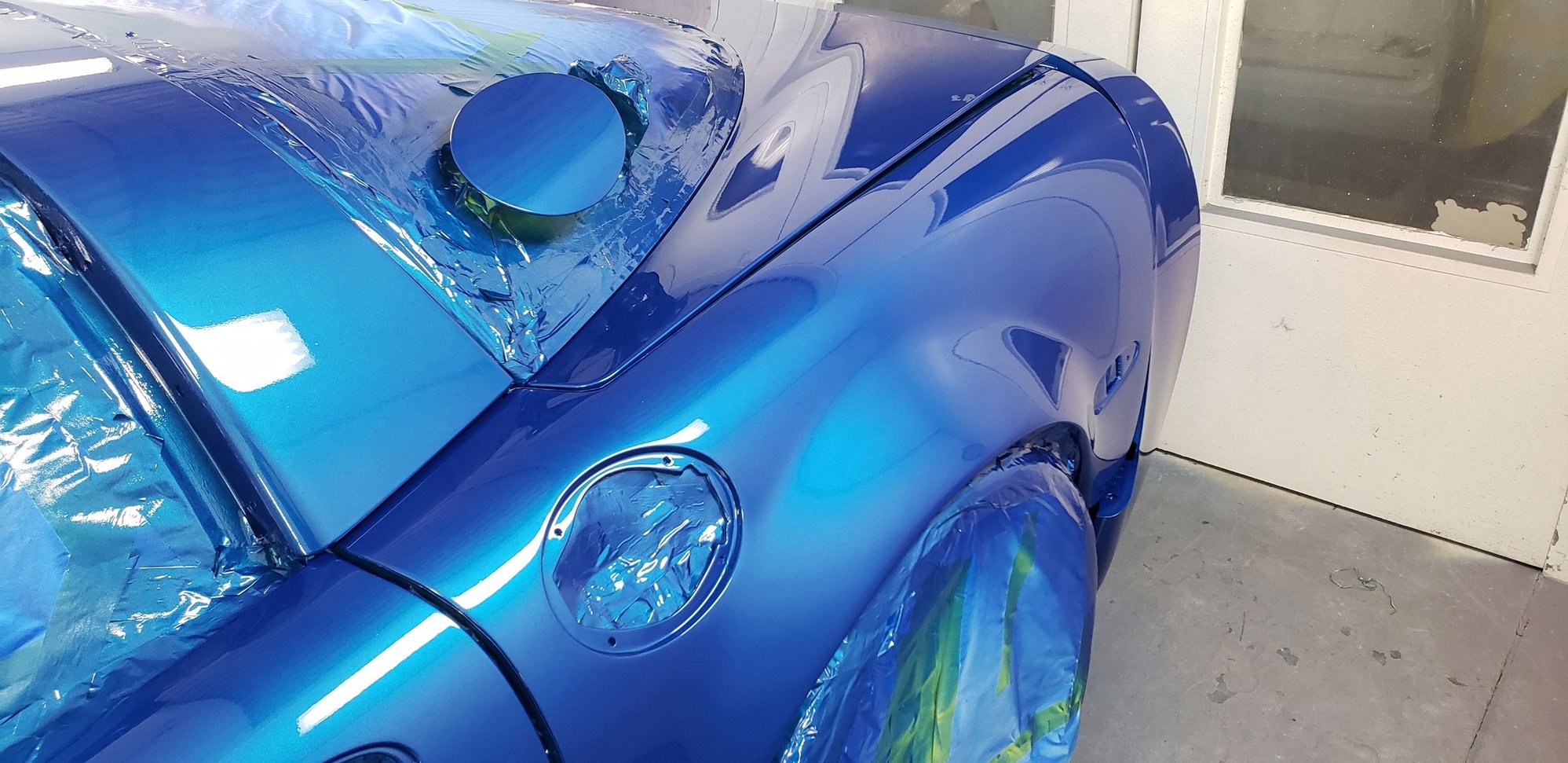

Likes: 7

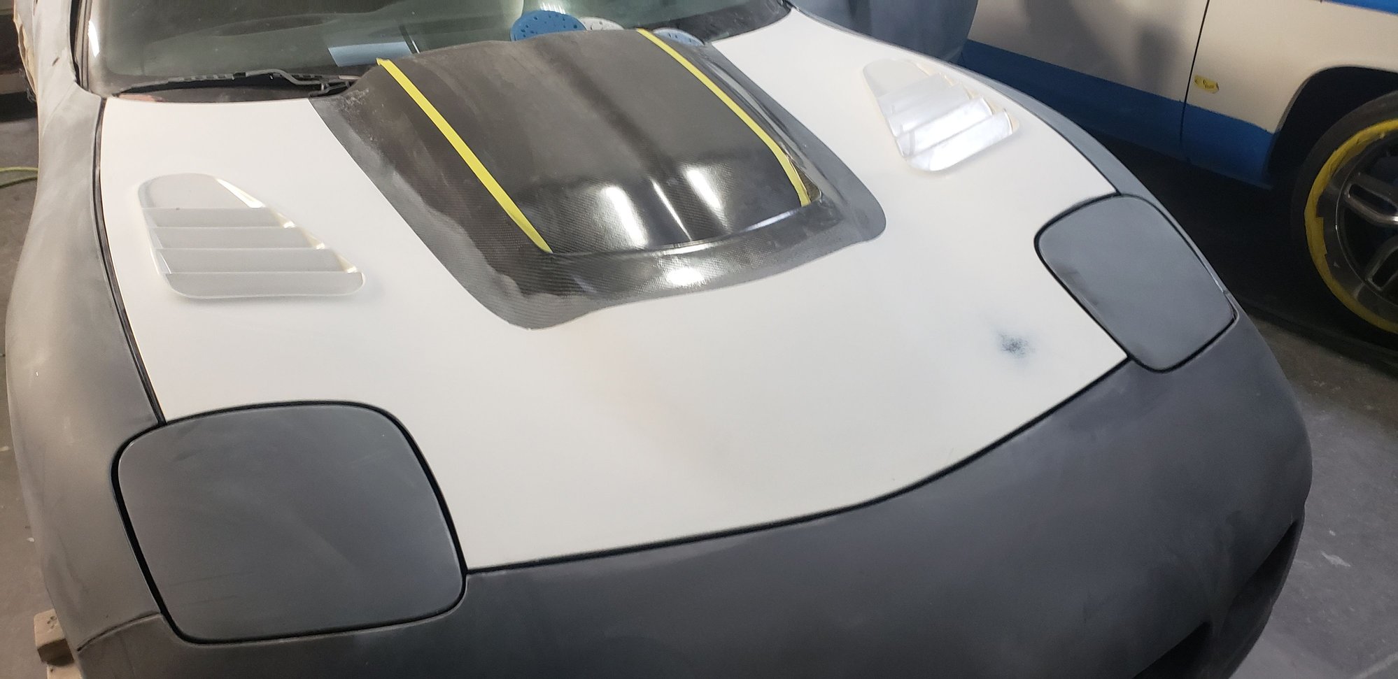

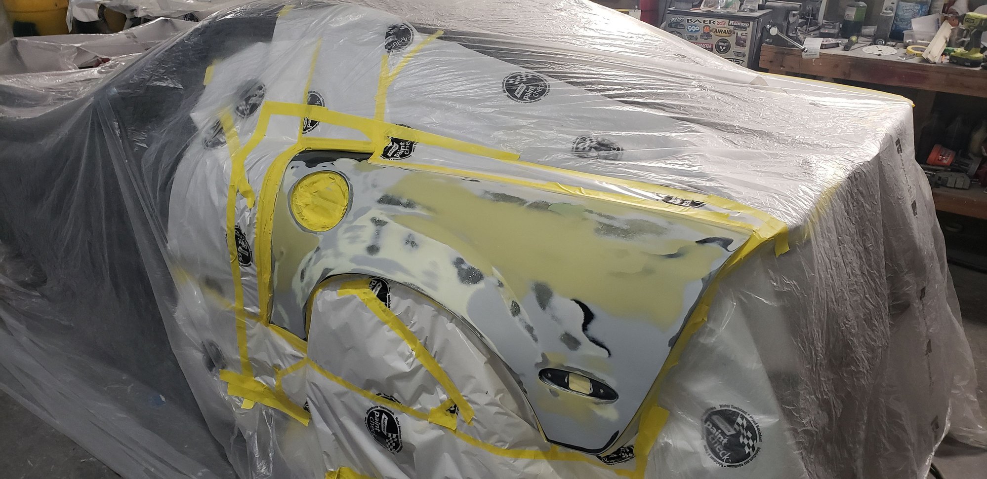

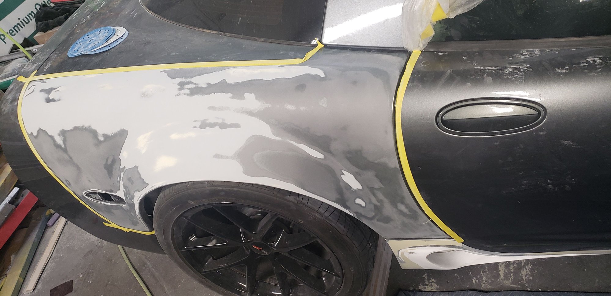

Paint and body work is insane. 4 month project so far on that. Still drying then wet sand.
