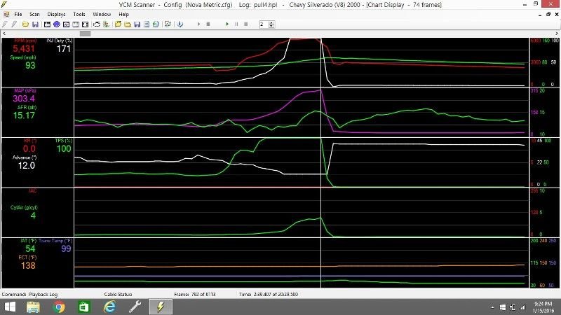

I run the living hell out of my stock L33.
This was on 93+washer fluid with a failed 44mm wastegate.
Pretty hard to determine where boost actually ended up, but I was a good 10 PSI after the 30 mark on my boost gauge. The 3 bar map sensor was topped.
No knock detected. The Deka 80s were at 70 PSI base pressure + boost reference and still at 171%. AFR was way lean.
I was too lazy to fix the gate, so I made some changes to fueling, pulled 1 degree of timing, and ran it that way for a few weeks.
On the setup I was running here, the car made 700+ HP and 800+ TQ at the wheels on the dyno at 17 PSI. I eventually settled at 26 PSI before upgrading turbo and intake manifold.
The engine looked pristine when I last tore it down. Zero signs of detonation in the pistons. No visible damage to anything.
Its going into my corvette behind my new quad turbo setup next year some time for even more abuse.
You're not going to hurt it on 10 PSI. It probably won't even realize its boosted lol.
