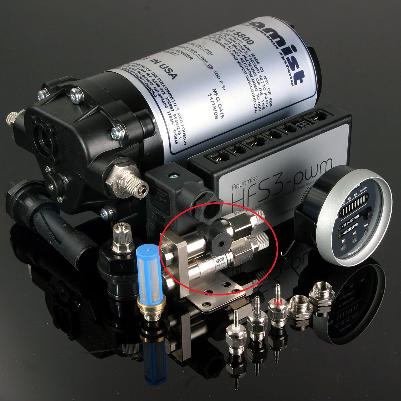

Please explain how the Aquamist kit measures flow when there isn't a transducer built into the controller in line with the meth line?
It measures flow...with a flow sensor funnily enough, using a hall effect sensor.
http://www.aquamist-direct.com/806-5...nsor-assembly/
http://www.aquamist.co.uk/forum2/vbulletin/showthread.php?t=2906
ie.

That didn't come in the stateside kit that I bought or was shown on their website as part of their kit either. Haven't seen it from Snow or Devil's own either.

They've used a flow sensor for decades.
Obviously there are various levels of kit you can buy, and cheaper versions without etc.
Aquamist is the only one I am aware of that uses a flow sensor. Although for a short time AEM did also offer a flow sensor/gauge, not sure if it actually integrated into their meth controllers for anything properly useful though
Although a standalone flow sensor could be incorporated into an aftermarket ecu install too as long as it's happy to receive a pulsed/frequency input as most flow sensors seem to be like that.
Although in normal operation, pressure is pretty consistent and doesnt actually vary that much, as the pumps actual output vs control duty is a fairly narrow range.
Even with a very small 640cc nozzle, 50% duty in a static test seen around 90psi, 100% duty was around 155psi ( PWM frequency 100Hz )
Although in real terms, actual flow through the nozzle was nowhere near the 50% difference. And very rarely would I ever be running pump duty at 50% anyway.
So it's easy to mark failsafes. Below 90psi do not add timing or reduce fueling. And above 160psi do not add timing or reduce fueling. Either would be considered a problem.
Simple, safe and almost foolproof
