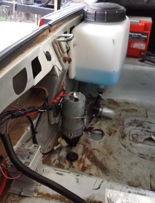

I've used those push fittings in my engine bay for years and years with no issues. If its on top or under an intake manifold I don't see it being an issue. But sure, some common sense is required with routing and placement. If you use 50/50 mixtures it isn't even flammable, so not a lot of risk IMO.
The Devils own pump I use is rated at 40gph at 100psi. Id run a 5 at each runner. Then PWM the pump as needed and let it eat. The volume those lines hold is pretty minimal. A single check valve at the feed would likely be fine. If it was really a problem you can get the Viton push lock check valves pretty reasonably and put then at each nozzle. The devils own pumps have internal check valves in the pump as well.
I have an old shurflow pump (don't even recall the model) pressure bounces like crazy but at 100% DC it will bounce up to 155ish psi.
I have a pretty rinky dink setup and not much into it. But it works well on my non-intercooled 5.3 twin setup. I spray pre-turbo.
