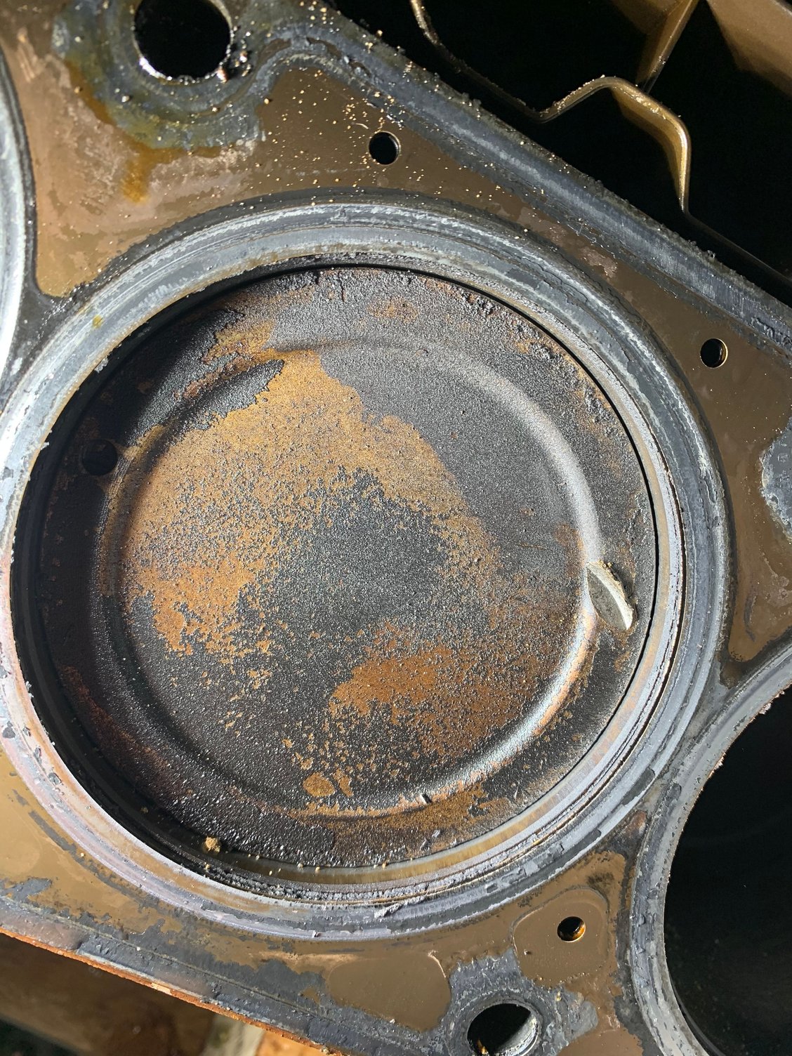

Thats not ****! Here is a recent junkyard 5.3. Only wanted the rods out of it. Someone woulda been unhappy with this if they were hoping for a quick swap engine

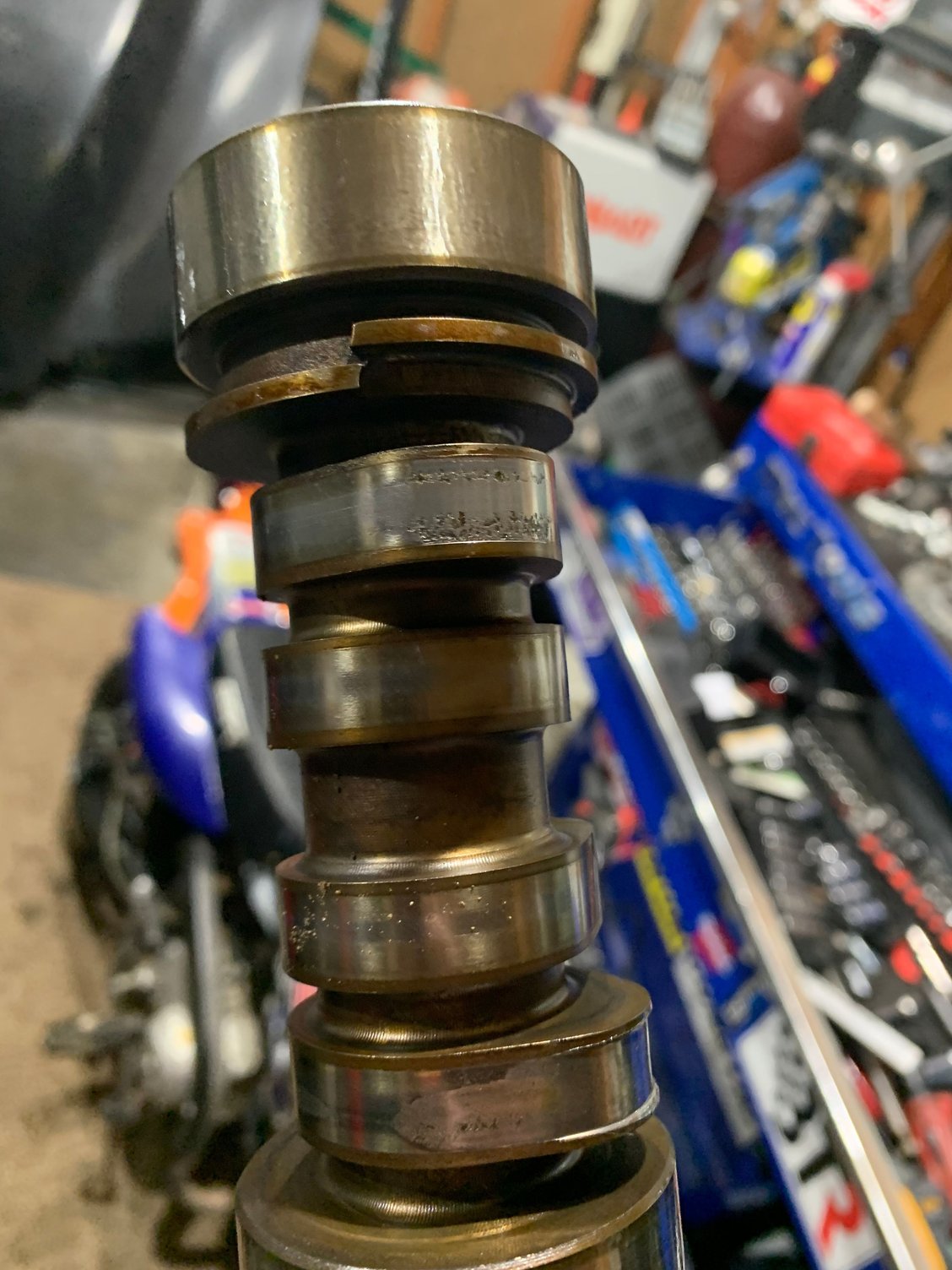

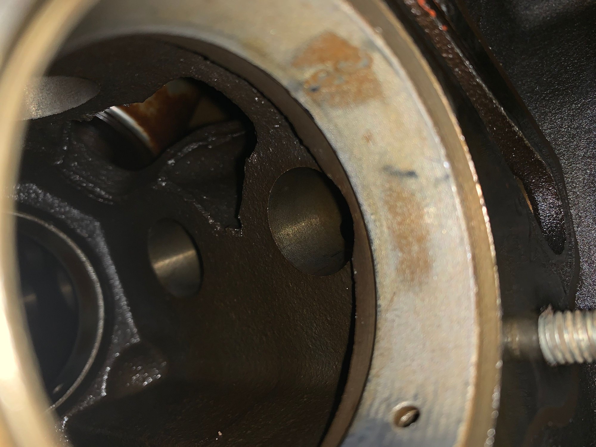

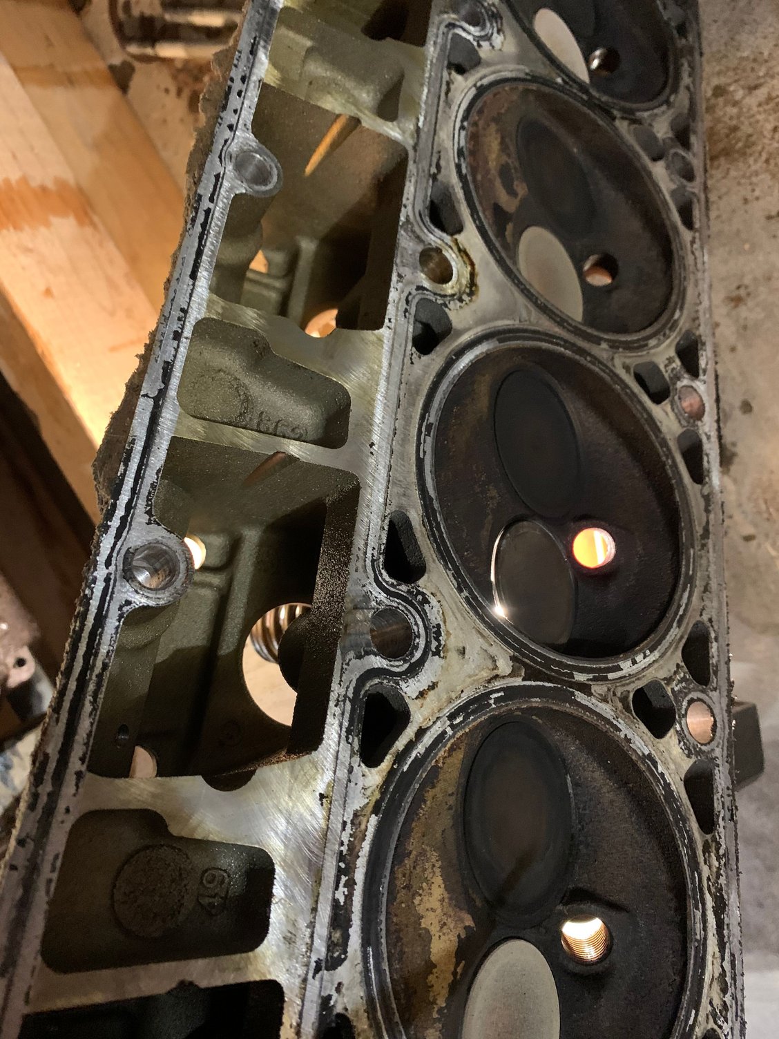

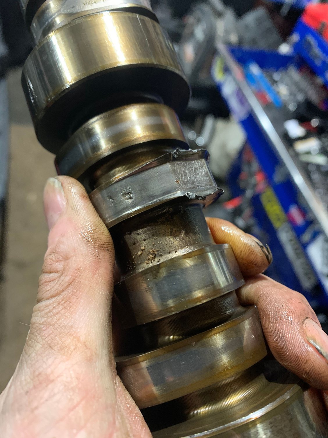

Only posted these pics in here because I just took this apart and had the same question.. why did it happen. . Bought this truck and it ran pretty rough... obviously. Didn’t make any real bad noises tho. Drove it home with intentions of swapping the engine anyways.
Got it out and took it apart... and the exhaust valve hit a piston. Cam destroyed. Lifter kinda chewed up. Cam bearings are toast too.
Same question... like.. why?

Was the cam still in time when you took it out? You may have jumped the chain at the high RPM,, DId the motor have a chain dampener?
