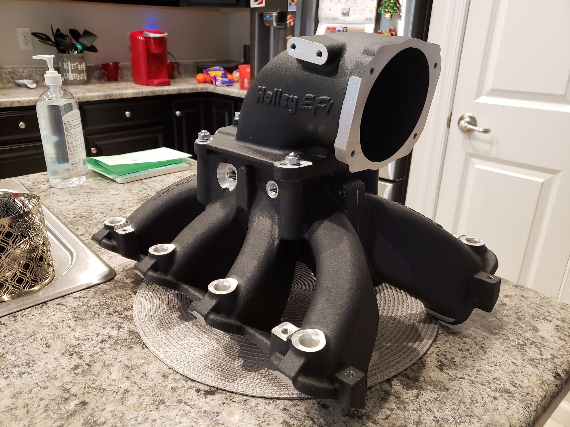

I have amassed some parts for this next version over the last year. I'm still missing a lot of things, but once the buyer comes and picks up my old setup, I will probably order everything I need for fabrication immediately.
I havent seen a single test result on this new Holley intake. Its a 4150 style intake and it is taller than a super victor. It can also be split in half to be ported. Poor man's CID intake basically. My only complaint is the amount of vacuum ports. 10 between it and the elbow. 4 of them are 1/8", the others are larger. I need like... 3.
It HAS to be better than the stock truck intake from 6200-8200 which is where I'll spend most of the quarter mile at, so its a win.

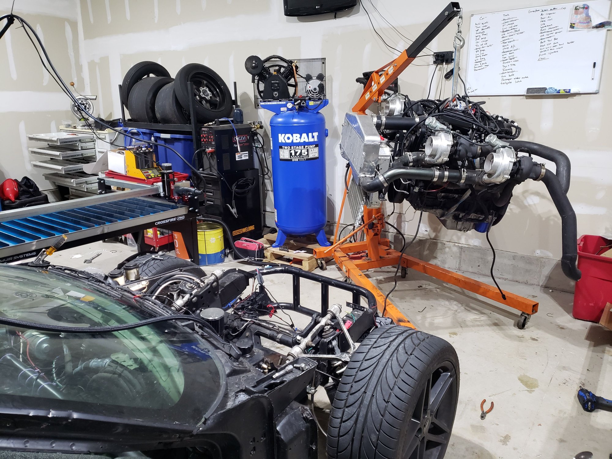

Out it comes...
Onto the next. I've already prepped the mockup engine to go in for the motor plates.

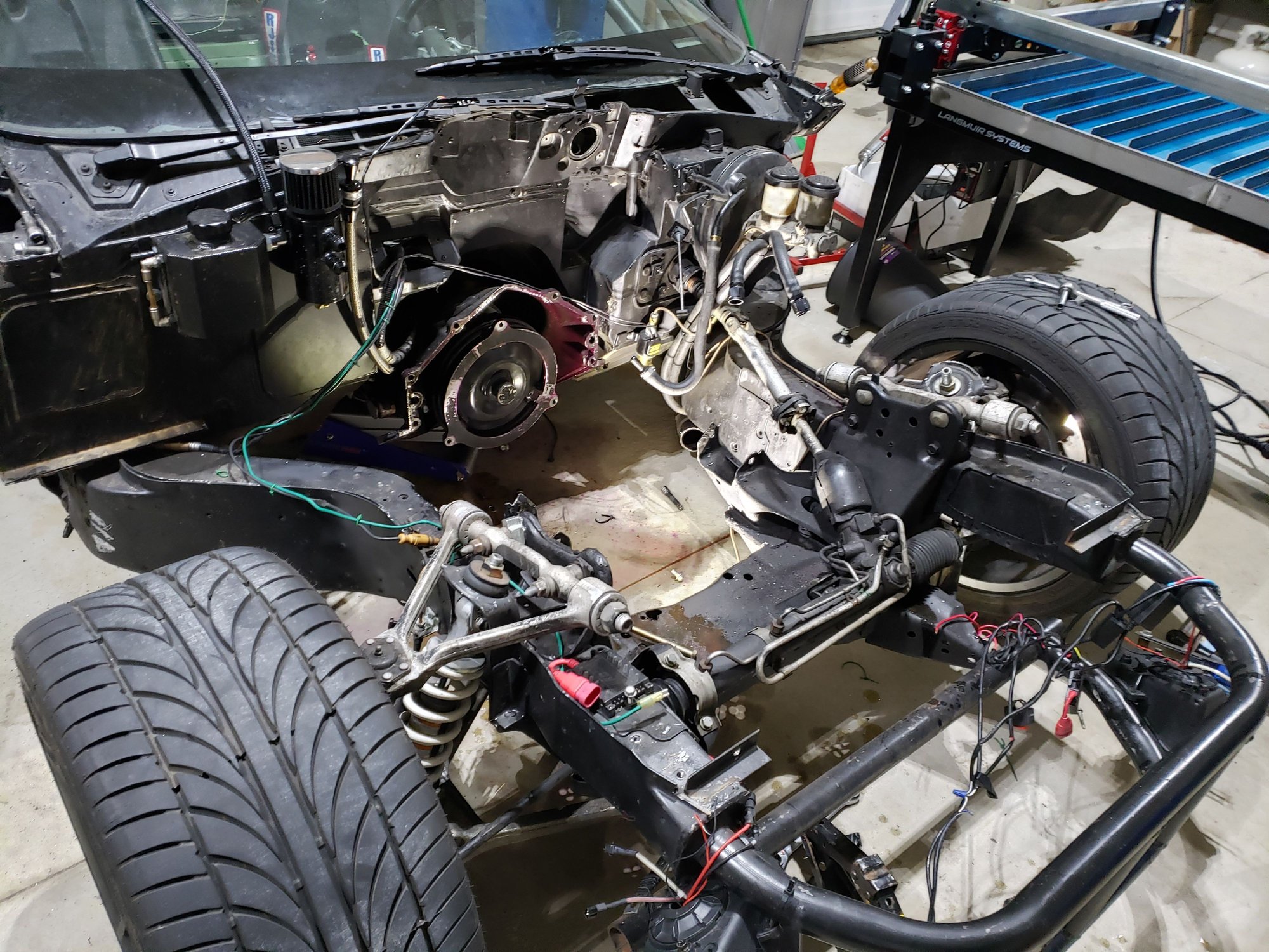

Now I just need to wait on the guy to come get this, and I can start on the new setup with full force.

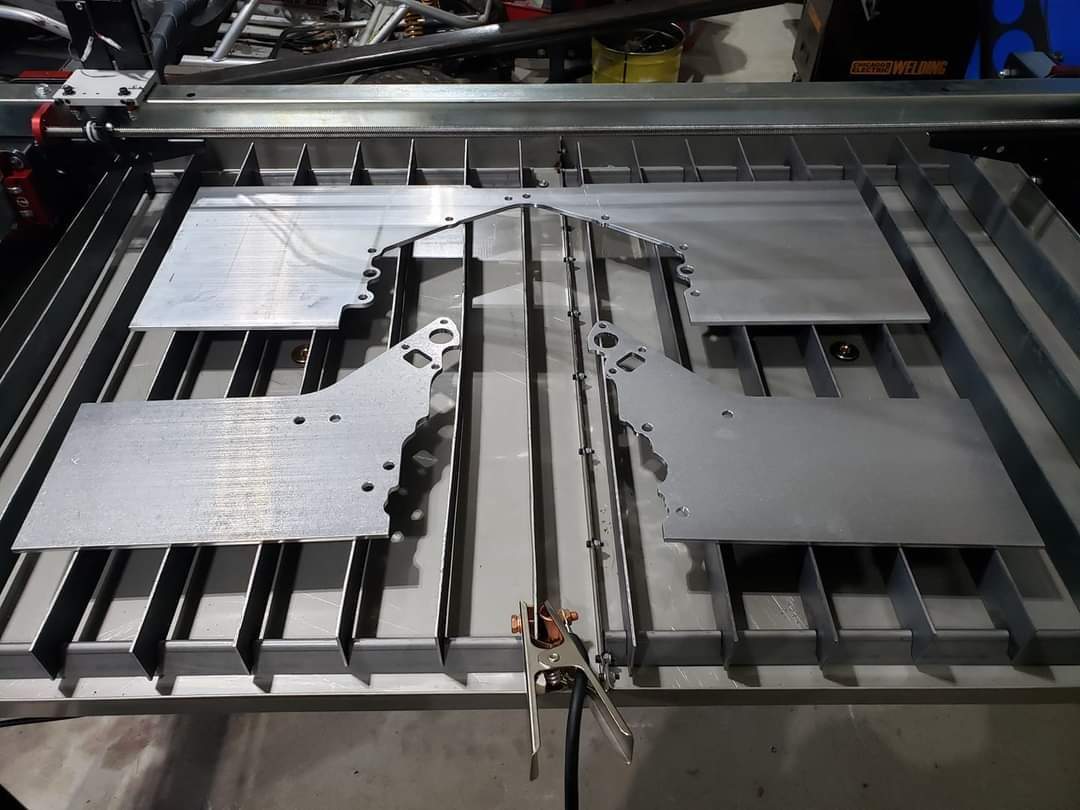

Hopefully pulling the trans today to prep for motor plate trimming. I also need to trim the trans a lot on the driver's side.
The engine is offset a couple of inches to the passenger side in the C4 and I want to try to center it better. It made fitment/alignment pretty awkward before.
The rear plate is going to have to be trimmed a LOT. The pedal box on the driver's side sticks out much further than both the passenger side of the firewall and my original trans mounting position.
I think I can trim the plate to only be 2" tall on the bottom of the driver's side and tuck it underneath the pedal box.
I'll remove the line lock and all of the fuel and brake lines tonight.
I also need to finish up prepping the CNC plasma cutter for full duty on this. It also needs to cut out a dual purpose trailer hitch/parachute mount.
The guy that bought my old setup needs to come get it soon. Christmas has pinched the budget so hard that I'm basically at a stand-still until then.

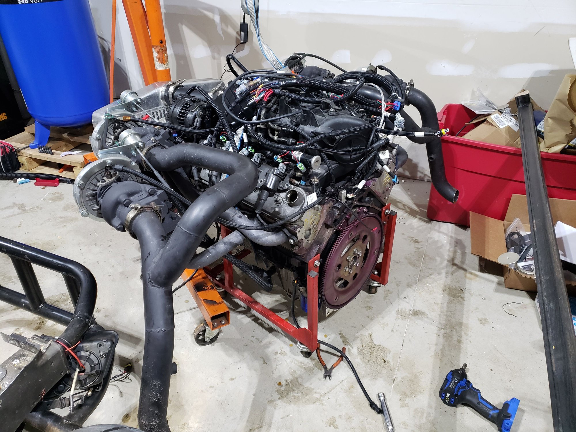

Hopefully I'll have an update soon. I have about 200 pictures ready to post, from the new engine to the chassis work.
Yes, the IRS is coming out soon. I'm going to see how far I can take it while working on the replacement. If I can score a Dana 44, I might keep it a bit longer.
The replacement will likely be a 4-link IRS, but I'm still exploring options because I need the car to be able to handle as its primarily a street car.
I'm wanting to dyno this engine on the engine dyno before I put it back in the car, because I have an engine dyno far more readily available than a chassis dyno.
Tuning it on the street has always been hard to do.
The old stock 4.8 ran 9s on 9 PSI with a poor 60'. I'm hoping this one can run 8s on the same boost, and I'm planning on pushing to ~30 PSI before I re-evaluate the setup.
