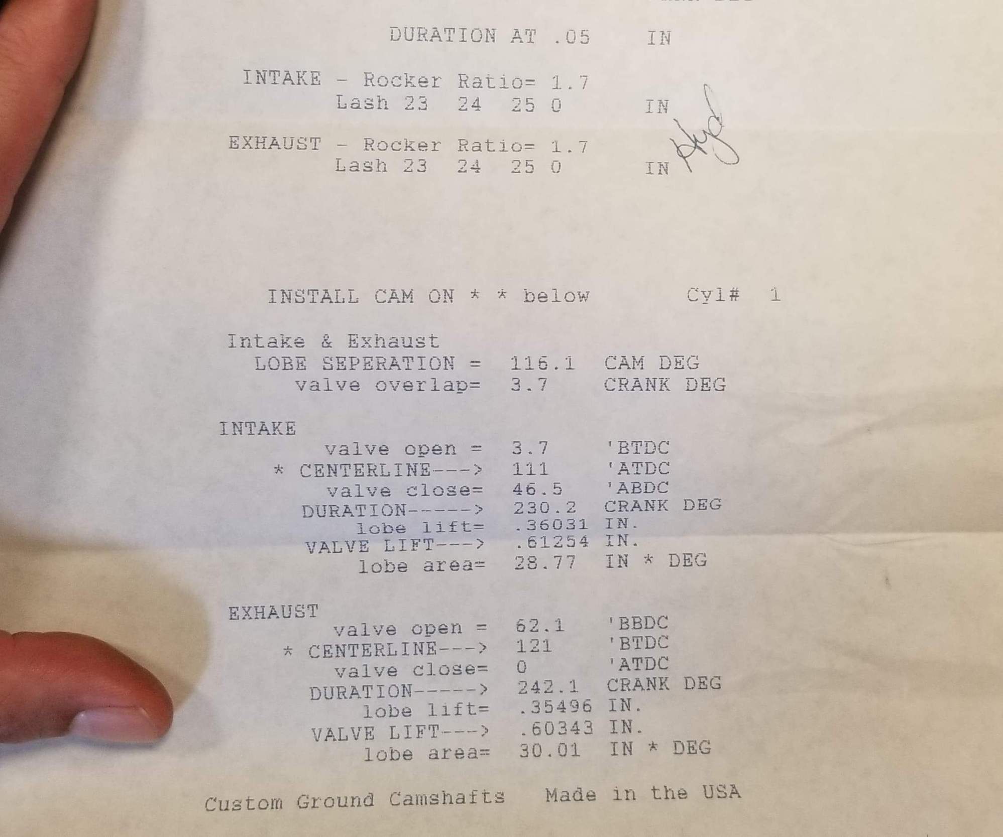

D1sc 3.40 pulley twin 4.5 intercoolers...... Boost concern.. 370ci ported 317 heads fast 102 custom cam only making 12 pounds was thinking 15 pounds would be more accurate. Linear gains but flattens out up top. Dont see Belt slip but not sure..
Thoughts..
Cam specs

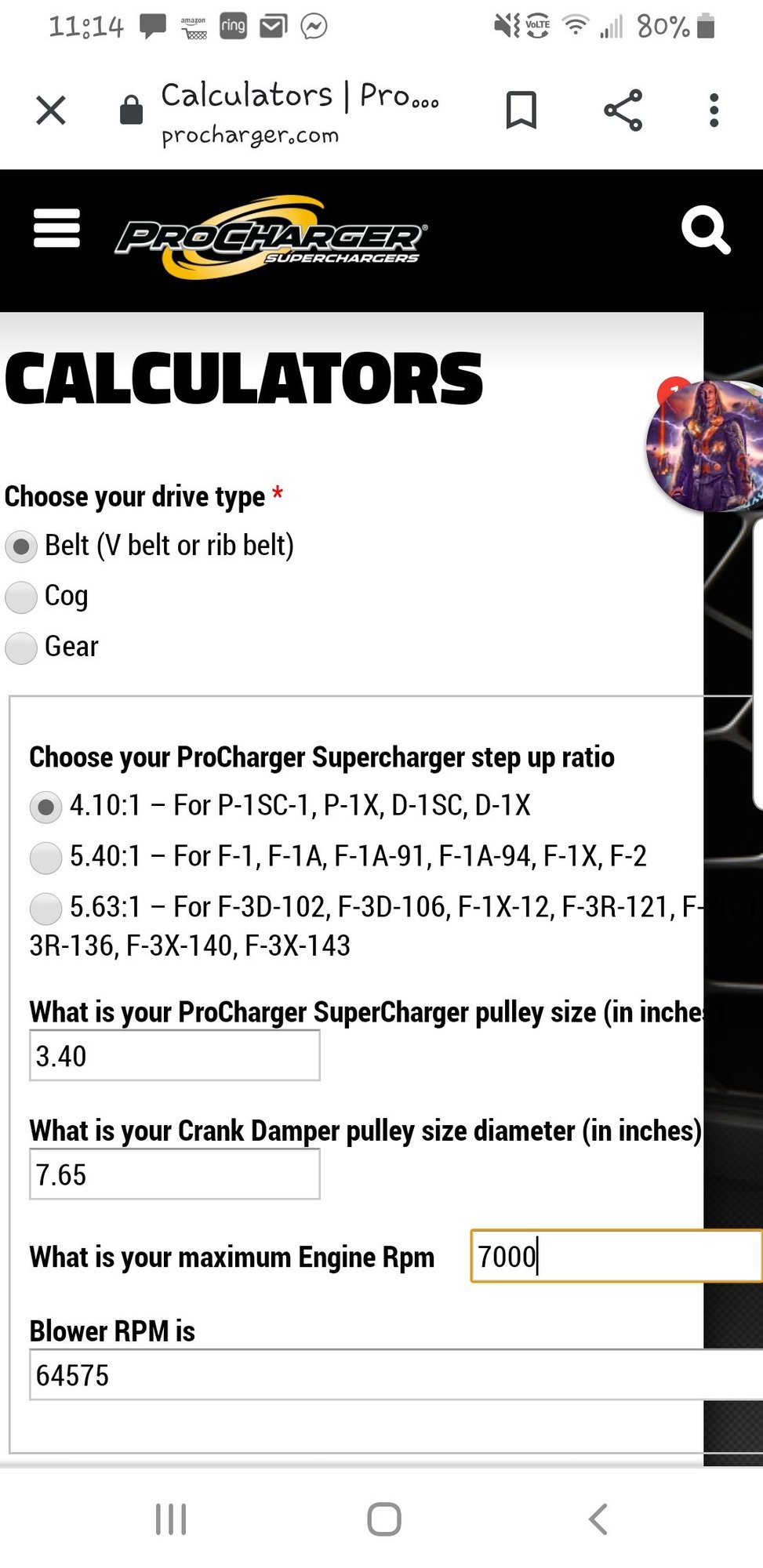

That pulley combination would set the blower rpm at 64880, Would this cause any change in how the boost comes on and do you think that could make more up top?
If you spin the blower the same RPM then nothing should change except you will have more belt wrap. This "should" increase your boost and as a result you "should" see your hp do the same as it's doing now except at 5800 rpm where it levels off it should continue to climb all the way up. This is assuming two things...one your issue is actually belt slip and two that the additional belt wrap solves that belt slip issue. You should see a continuous rise in boost all the way until your shift point with a procharger.
