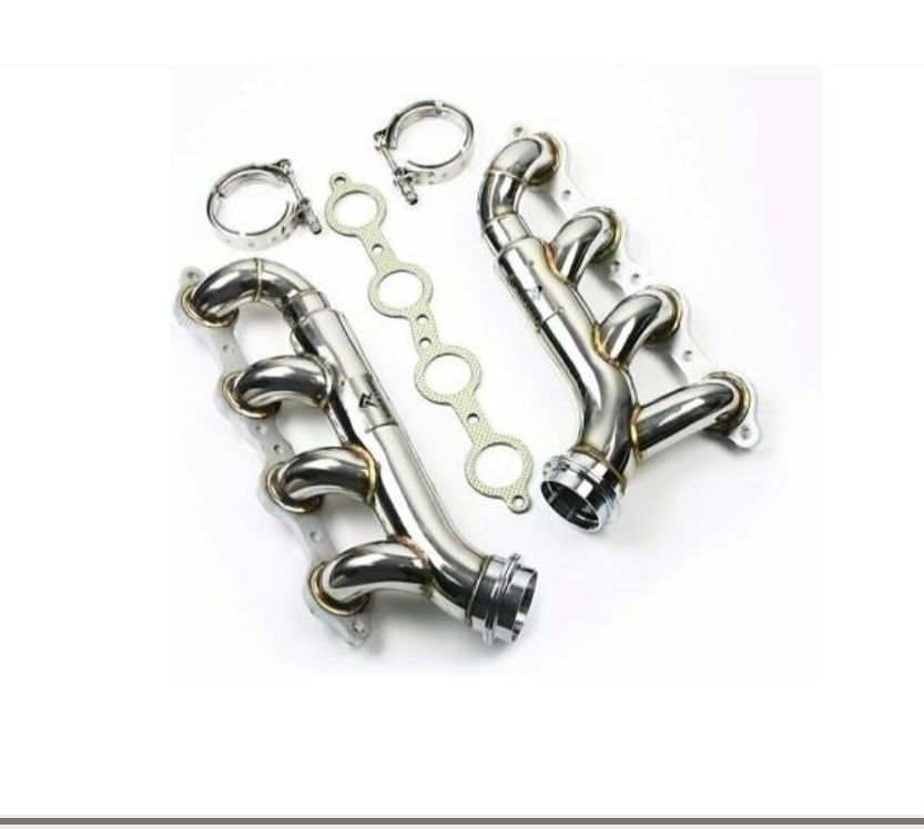

Link to the $100 manifolds? I know you can get the flowtech style cheap but not these that I’ve seen:
