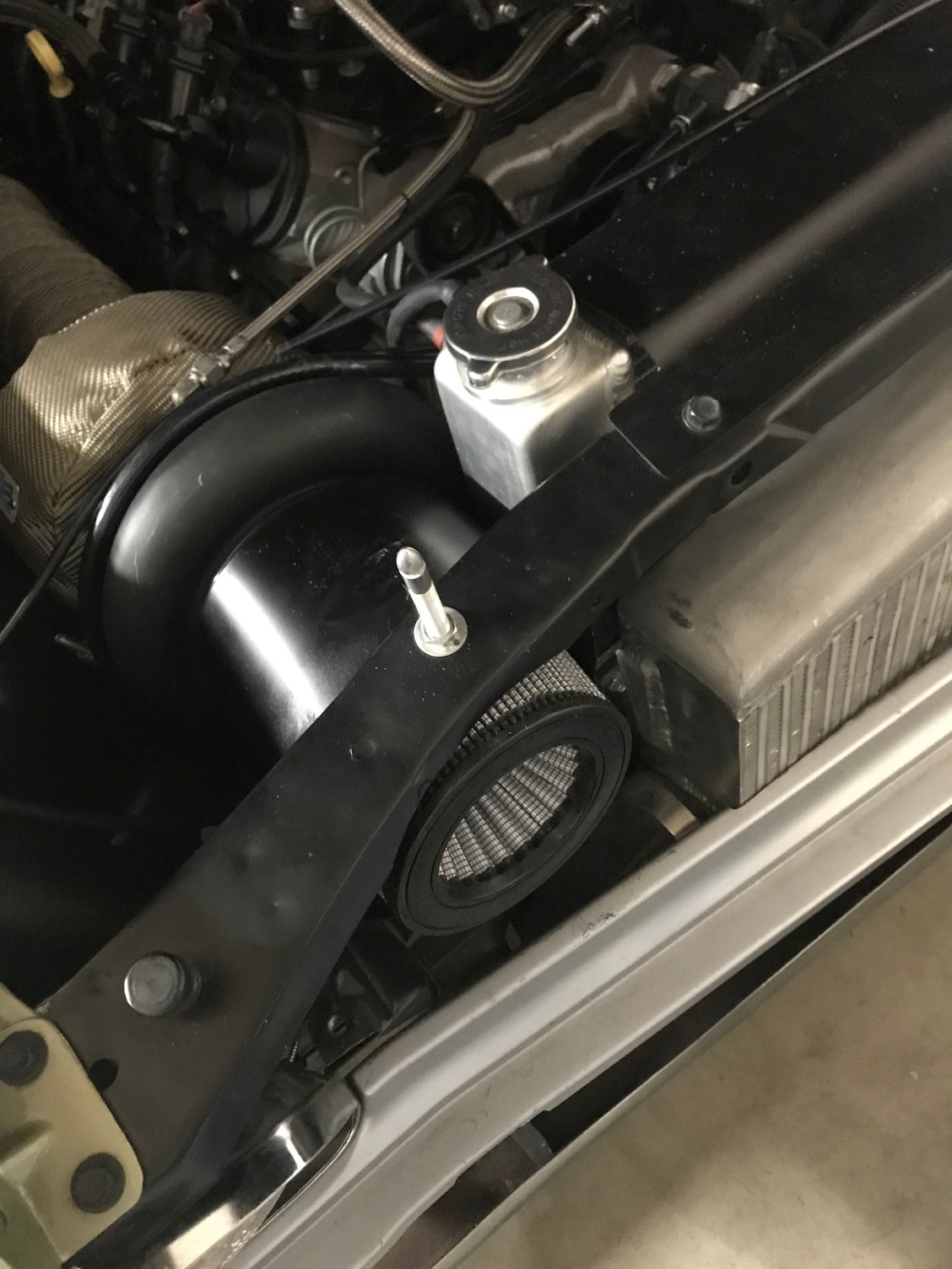

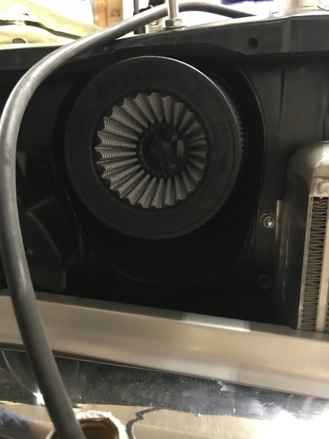

These are mine....sucks having zero room lol.
Although surprisingly pressure drop inside the filters is a lot lower than I'd have ever expected. So not worried.
https://burgertuning.com/products/bm...4fcb7a3f&_ss=r
Always fit as big as you can though, and always good quality

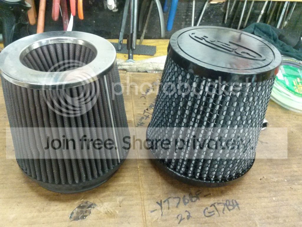

Here is the new black hex pictured, larger than the AFE.
​​​​​​Good bit up over 1k hp, you can see the MAF... Just under 140lb/min in the lower pane
​​​​​​Depression showed in lower pane aswell
~5kpa, so less than 1 psi there still even

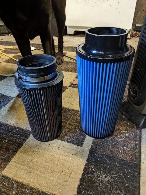

And here is the smaller, dirty old AFE vs the black hex at 1000hp
100lb/hr. Overlaid
black hex Just a little bit better but if the AFE was fresh I'm not sure

Eeither one would be great and honestly the AFE would be right there If it was fresh, Even though it's about a wash right now
I used that AFE in a high dust environment on my compound turbo diesel.... It is crinkled because I had dropped kicked it across the shop lol
I had very fine dust on the inlet tube getting past the filter, So a paper filter went back on
But on a streetcar out of very fine gravel dust it's fine lol
