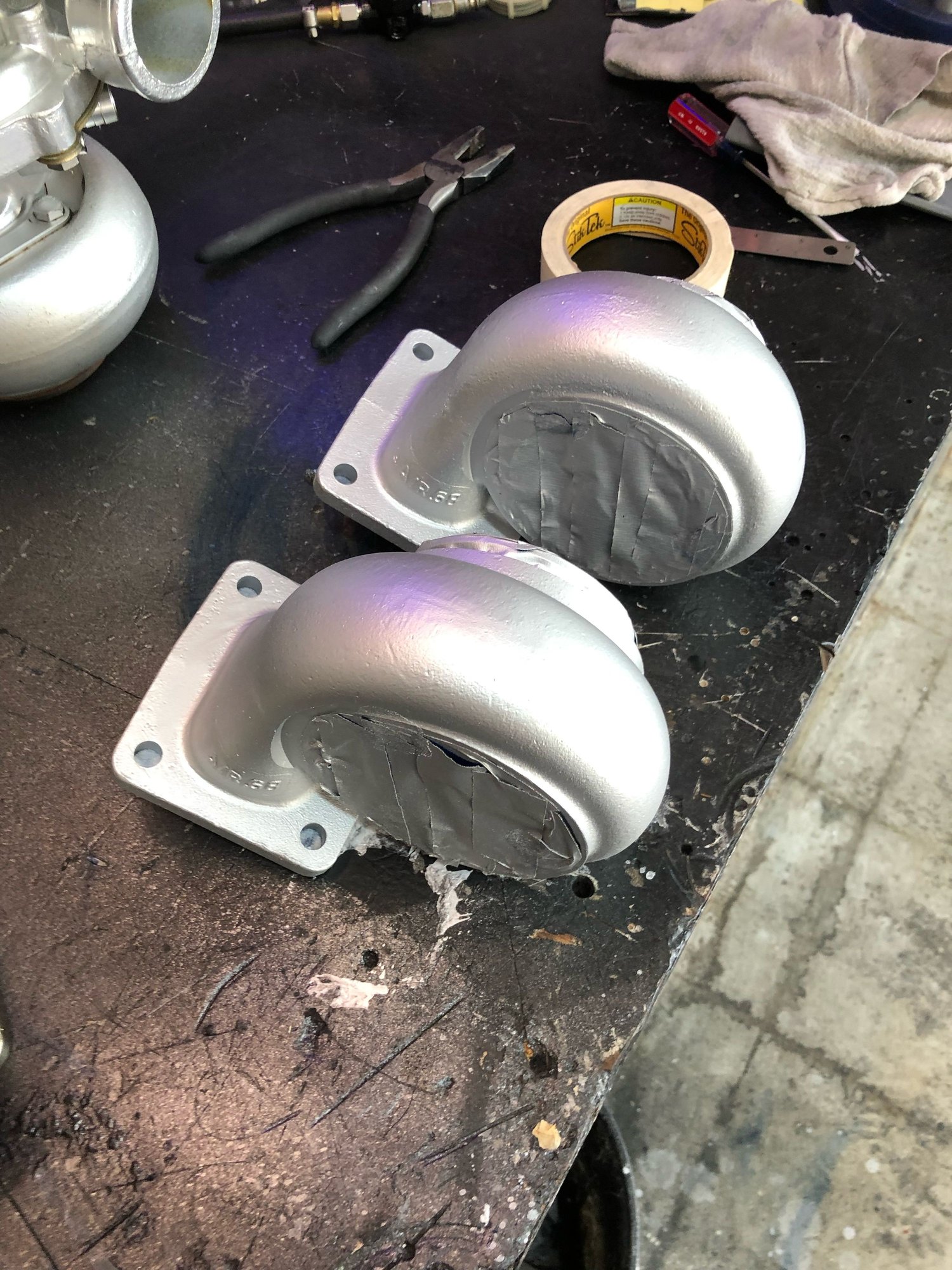

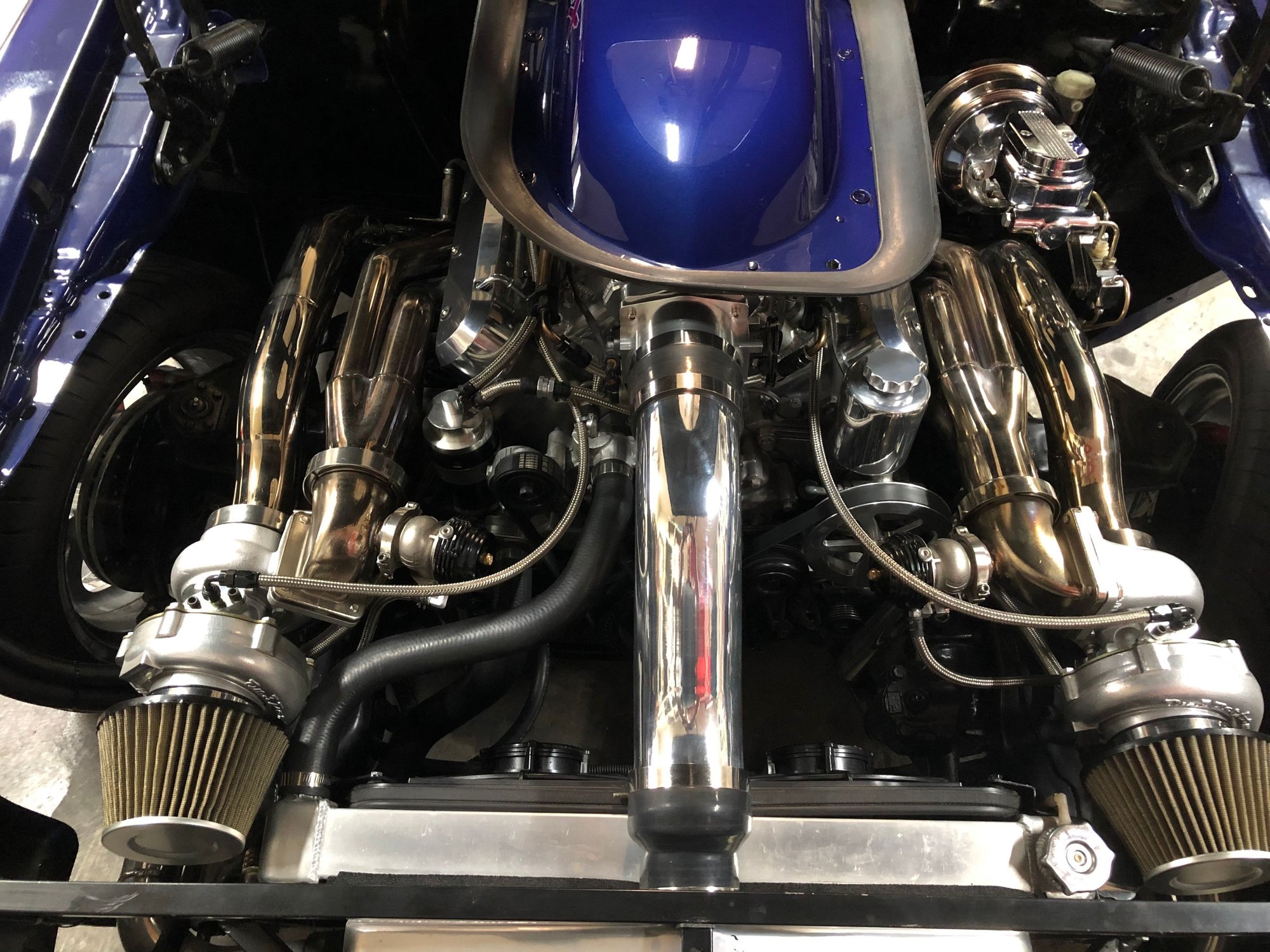

I've always used cast OEM manifolds and never had an issue with BBQ grill paint peeling or having any issues with the heat. Spray it directly on the turbo housings and it holds up great. With non-porous SS I'm guessing if I hose these manifolds down they the paint won't stick and it will make a huge mess. Anyone have luck just roughing up the surface? I've heard "special" galvanized etching primers are generally needed. And that these don't hold up on exh. manifolds. I could be over thinking it, just curious if anyone else has had luck spraying the typical cheap polished SS manifolds. Found some new bronze/copper BBQ grill paint I wanted to try out.

I'm not aware of any self etching primers that will hold up to exhaust heat. I've never had an issue with with heat on standard 16g steel hot sides, turbo housings, or cast manifolds with the standard BBQ grill paint. It holds up extremely well. Better than VHT or any other exhaust paint i've tried. I haven't tried cerakote or any of the other ceramic based stuff based on price. I don't want more in my paint than my china headers are worth. They are prone to crack and who knows what else.
Seems like they will bronze up with heat pretty well if I can keep the oil off them. Kinda neat video.

Yup they will get some nice color to them, I'd run em raw for now. Before first start, take a rag and some brake clean or something and wipe down every pipe, they will burn in random finger prints and such once they get heat in them and you'll never get it off.
