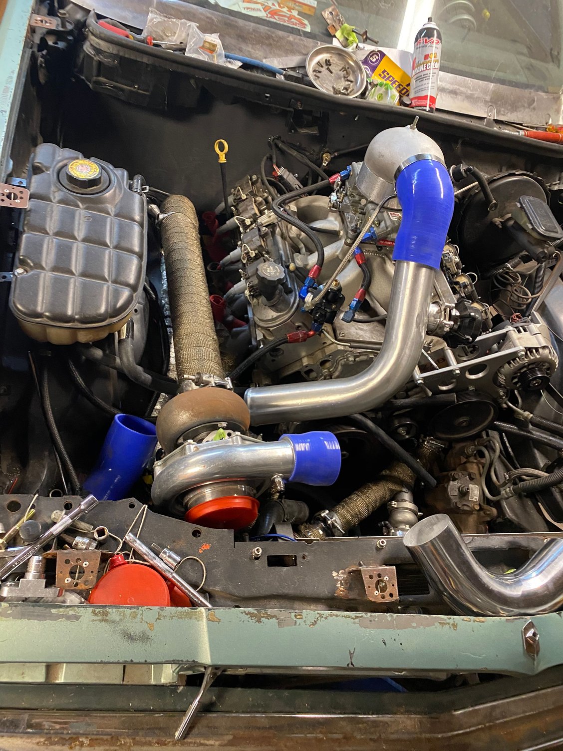

Just finishing up my first turbo setup. 5.7 with VS Billet 7875 & Pro Systems 750 card. Still have a nitrous plate under carb. Would it be ok to put some 125-150 shot pills in & spray it with turbo or am I gonna blow it up? Anybody tried this?

It’s a 2000 aluminum 5.7 Comp 238/246 600/610 112+2 w springs pushrods & timing chain upgrades. 80k 3800 Convertor th400 3:73 12 bolt w 275/60/15 Drag radials. Haven’t fired it since turbo but decided to redo roll bar & notch & anti roll bar frame since mostly qaurantined. G body 3050 w iron sbc aluminum heads. MSD 6014 truck manifolds to a MonkeyFab 2 1/4 to T4. Just still had old plate system and wondered? I saw Sloppy Mechanics had a 50 shot on an injected LS.

Maybe I’ll take plate off, it’ll give me a 1/2 inch more clearance since it already gonna stick out the hood.
Almost done
