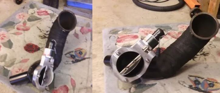

I have had a one of the cheapo vac operated ones off Amazon on my daily driver Yukon for 4 years now. I have it hooked up to an electric vac pump and a solenoid that works off of a RPM window switch so it only opens past 3k RPM. It's right at the Y in the down pipe. The thing opens countless times everyday for 4 years in salted Alaskan shitty weathered roads and still doesn't leak or rattle. I wouldn't even consider an electric one anymore for any reason after using these. The stainless isn't rusting, it still operated smooth by hand last time i checked it. There is nothing to really go bad with them, too simple.
The switches and pump and stuff cost a silly amount for such a trivial thing but the valve itself was only like $40.

The brand of electric valve makes alot of difference IMO as well. Badlanze HPE are some of the best I've used with the best customer service. I had a 4" electric cutout on mine for many years, no rattles, no issues and about a foot from my down pipe.
I use the vac operated valve's as well on another car. Had one get a little sticky after about years use... Hosed it down with WD40 and it seems ok now.

I think it more or less comes down to the valve needing to be constantly used to stay in good shape. If I had mine on a hand operated switch I would probably see issues like I have with electric ones. Staying closed more than a couple heat cycles is bound to rust them with the heat and condensation. But the electric ones all open and close to slow for automatic operation IMO and they all have some sort of gear on gear mechanism that seems to wear out. It's just hard to mess up a spring, a diaphragm and some air mechanically speaking.
