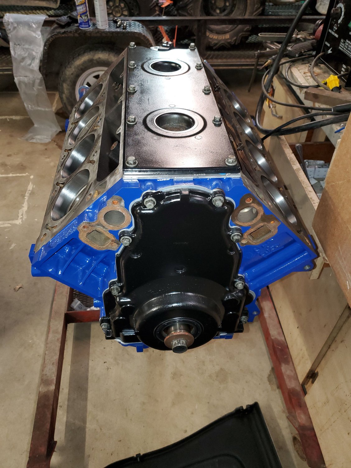

Ive got an 02 LM7 that I rebuilt. New cam bearings, main bearings, rod bearings, piston rings (gapped for boost), a 98-00 factory take out LS1 cam.

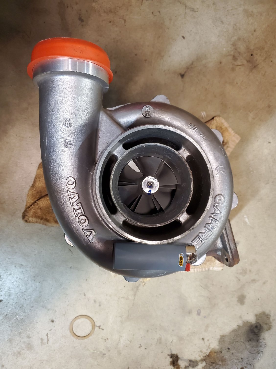

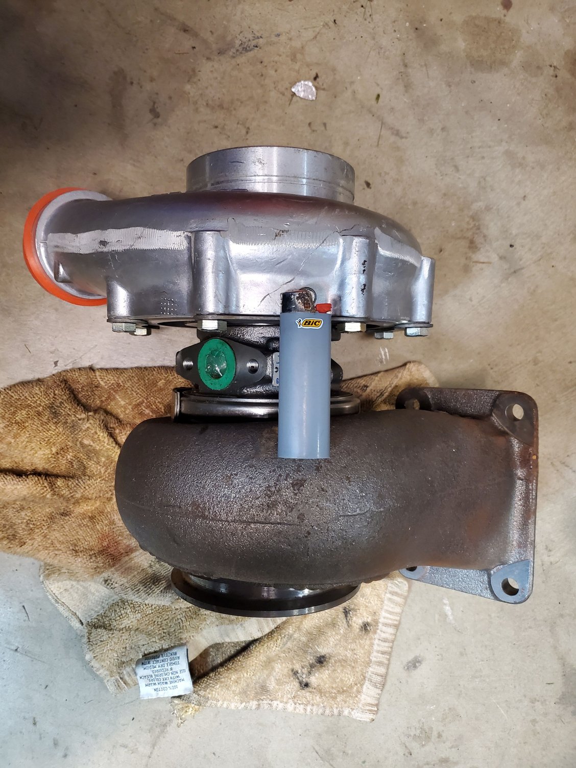

I picked up a turbocharger off marketplace. It belongs on a 12 liter Volvo. Its a Garrett GT4288N. Compressor is a 64.7mm inducer with a 88mm exducer. The turbine is a 82mm inducer with a 75mm exducer. T6 twin scroll. 1.32AR hotside.
