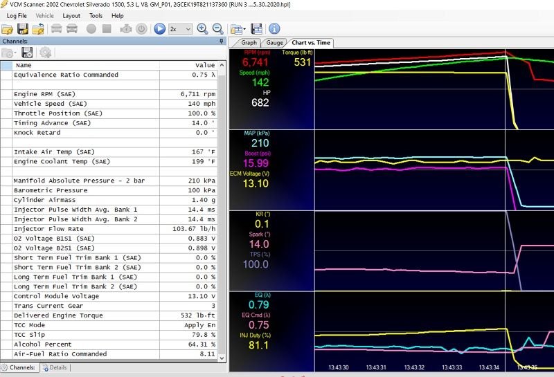

Reading people doing 12-15 on e85 tells me to go ahead and get some 120lb injectors at least. The dual pump set ups are foreign to me. I have read and read about them. If i can just get mid 600's max I'd be happy. Its a gen 2 cast vs racing 7875. Not sure how high in power that will go. I'm kind of understanding I need to just bite the bullet get some big injectors and the line pump kit from like Racetronix. I was hoping to speed 400 on a pump not 1000. Then also a regulator up close to the line. Even at 600 I think I'd so 120 injectors and try to get away with like a 450 or 495 pump id hope, but I'm starting to think that's a dream.
FWIW, Back in May 2020, when track finally opened...
My car has a 4060# race weight...
On pump E-85 (less than 65% ethanol, according to log),
Dual 340lph AEM intank pumps,
Stock lines but -6AN return,
Racetronix dual Hotwire kit,
1000cc Snake Eater Injectors, and a
Gen 1 Cast VS 78/75,
I went 9.94@138, third pass ever in my new (at that time) turbo combo.
14 degrees of timing, and just hitting 16# of boost,
Was at 81% injector duty cycle, topped out at 142 MPH before I let off the gas.
Soon after, swapped to a CHRS1313 dual 450lph intank setup w/all new "Hotwire" setup, -8 PTFE lines, to Holley rails, -6 PTFE return, a Gen 2 Billet 78/75, and then swapped on a 4.5" Treadstone intercooler near year's end.
Only went 2/10ths quicker, due in part, to my ET Street R's being worn out, but have went 7MPH faster...
Only other things changed for 2021 are 1500cc injectors, and switching to dual wastegates...
Never been on a dyno, so no clue as to HP/TQ figures, but it runs well...
600 or so should be able to happen pretty easily for you.
I literally chose to go flex fuel due to easy access after a few places opening up near me. No-brainer for me to spend $2.25 a gallon for "race" gas, instead of mixing $12/gallon with pump 93 like I used to do. I take 10 gallons of fuel with me to the track, just so I know I won't run out, and it's much nicer filling 2 jugs for $20 or so, as opposed to $75. Test & Tunes are usually 50 bucks, so switching to flex fuel equals free racing for me...
I do run a flex fuel OS (HPTuners) and a sensor, so that I can run straight 93 (E-10) if need be...I have my tune to retard timing about 5 degrees at any RPM, and top out at 12-13# of boost, if on 93 octane. But the very little drive time I've gotten this winter, has been mostly 3-4# of boost, just to drive the car a bit (straight 93)
