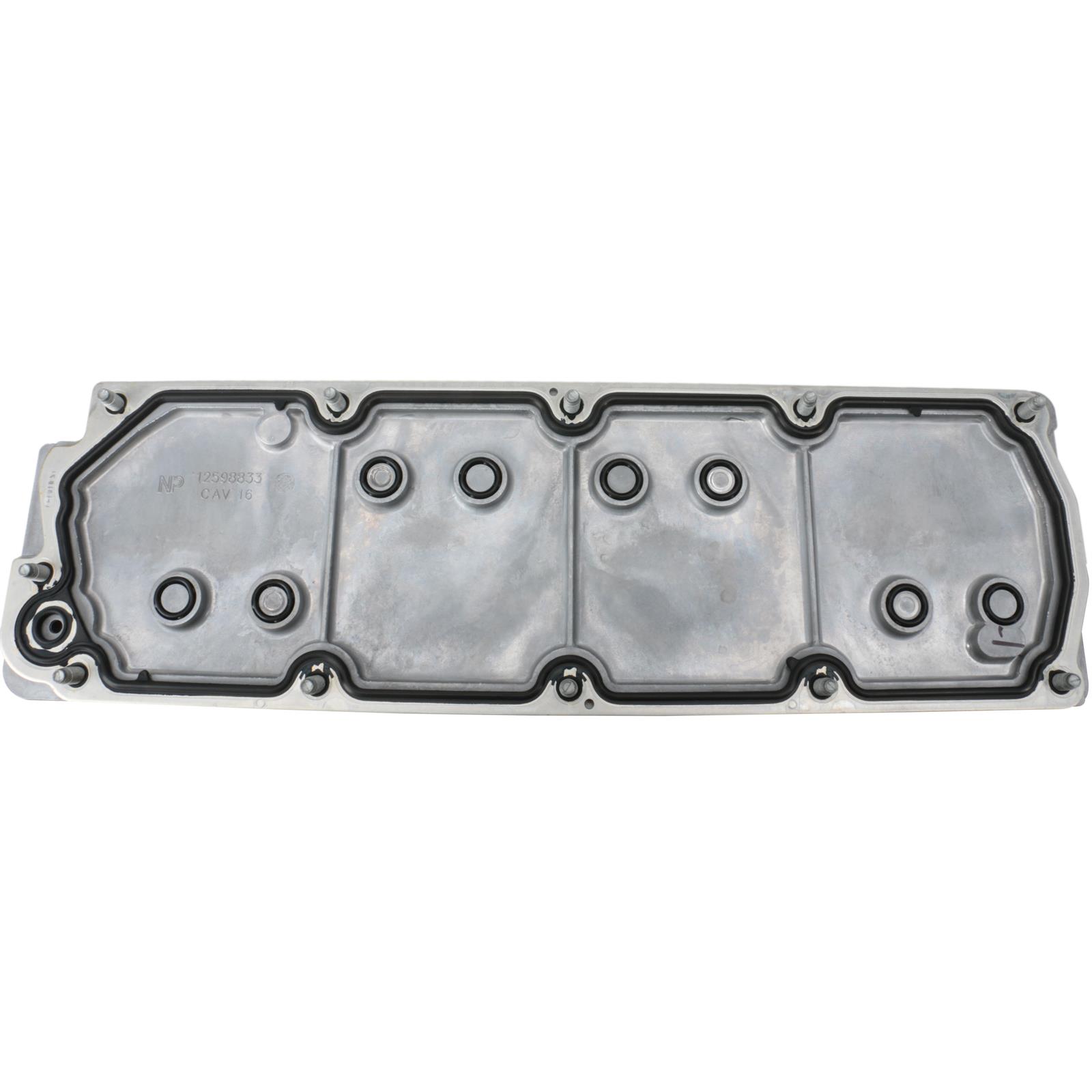

Shortblock will be back from the machine shop this week. The DOD towers are still open and if i can avoid drilling and tapping them with my brand new shortblock i'd like to avoid it. Who has used the GM dod delete valley cover without plugging their DOD towers without any issues? GM did it so I dont see why it would cause oil pressure issues but I just wanted to double check.

I went ahead and used the lingenfelter tool on mine which is basically a rivet gun. I just wanted the extra piece of mind without tapping the holes.

Only used the o-rings, haven't had problem even up to 110PSI oil pressure.

You'll be fine just using the cover

I dont see why anything more than the cover needs to be used. I get the rivets and tapping and stuff if you dont have the right cover available though.

Why did the machine shop not drill, tap and plug them when working on it ? Long term it will be the best option and is very easy to do. Drill and tap them yourself.
