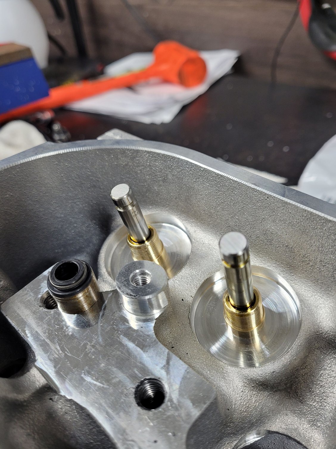

Started swapping my BTR.660 springs onto my new Trick flow Gen X 220 heads with bronze guides. Looks like there are no valve seals at all? Is this normal? (the valve seal shown is from my BTR spring kit). Should I install the valve seals or leave them off? I am going to try to reach trick flow to confirm today.

yes there's no seal installed on that new head, but you still need valve seals, they just left it up to the user

Seems silly as this head is sold as assembled and ready to bolt on if im not mistaken.

some valve springs will have particular seat heights, and may require shimming etc. some spring seats even have valve seals already installed.
this way it's just more universal, seals is just part of the process, as it didn't comes with springs either.

I dont think you understand. This was a fully assembled head, ready to bolt on, that i removed the valve springs from to replace with different springs, and noticed there was no seals.
I just got off the phone trick flow and they assured me that there should have been seals on there. Now I am curious to go home and see if the other head has seals on it. Quite the error in production if you ask me. Friday heads maybe.

I’d say that was a goof!
You would have been disappointed if you would have installed them as delivered!

ohhh yea I misread that. thought it came with no springs. good catch, would of been a smoke show.

Checked the other head and sure enough it had seals on it. Someone goofed! Friday at 4:30PM head lol
