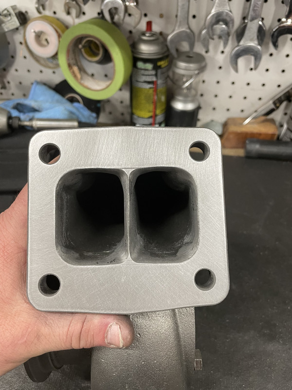

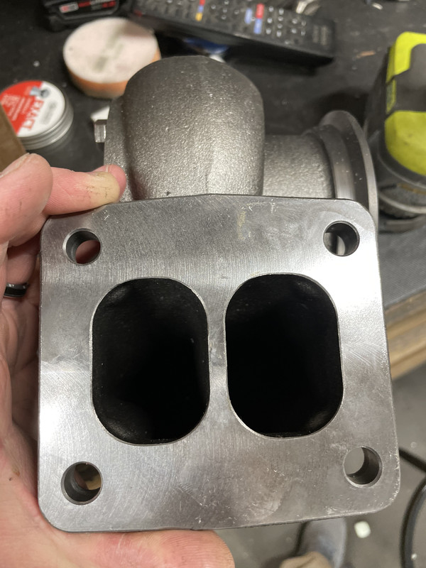

I got my housing in Thursday. I didn’t realize it was divided. I don’t have pipes merged at the flange, I have one big pipe going into my turbo. This divided housing has small holes compared to the gasket, I felt like while the housing would flow better, it would be a bottleneck here. I decided to open it up instead of having a huge flat surface in the middle of exhaust flow.

Old Apr 25, 2021 | 06:55 AM

Makes sense , I would've done the same
Looks good. What are your plans for the larger 4" turbine outlet? I'm going to probably use a 4" to 3" v band adapter flange.
so this setup is weird. While it takes a 4” v band, a 4” pipe does not slide into the turbo. The hole coming out the turbo isn’t even 4”. The step is slightly larger than 3.5”. So this is actually a good thing. (Ima post pics when I get back home)
what I did was ordered a 4” and a 3.5” v band set. I’m going to put a 3.5” v band flange in my lathe and machine it to fit inside the 4” flange. And weld it together like that. There won’t be any restriction because the 3.5” pipe is a little larger than the exit hole.
I forgot to mention, my downpipe is already 3.5”, I’ll cut the 3” section off that’s at the turbo and make it 3.5”. I had planned on building another complete exhaust out of 3.5”
before:
after:
I ran a similar turbine housing on an older TC7868 unit, I didn't bother to port the flange for resale purposes and it worked fine, no noticeable impact on spool or anything else.
