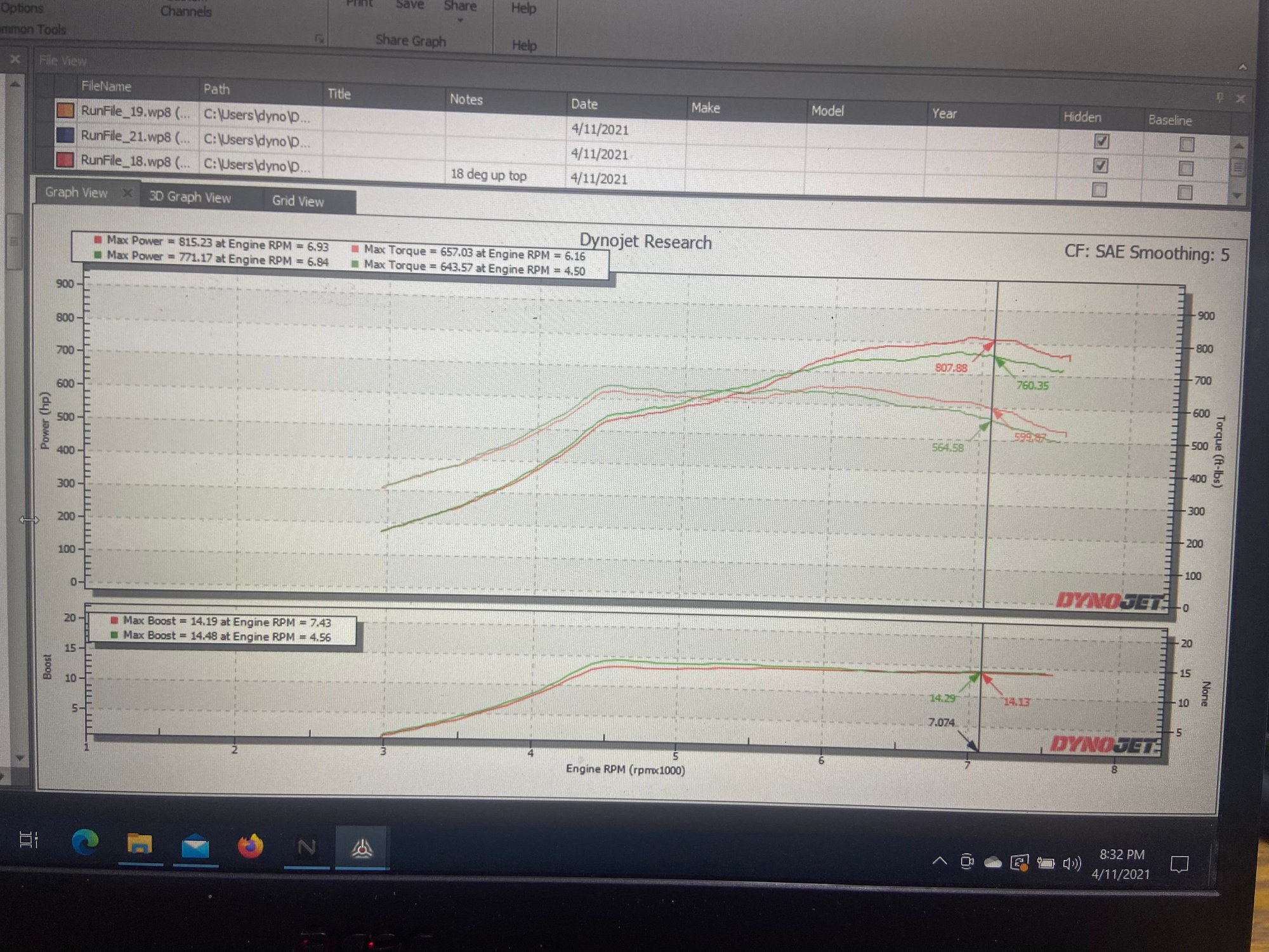

I am working a a gen 5 5.3 with a decent cam, drop in rods and pistons and a pair of 67’s. It is kind of a budget build. It is my intention to turn the boost up pretty high. I am at 17psi now and 900rwhp. It will be at 25psi in soon and likely 30+ this season.
my goal was to keep the timing on the safe side and “make power with boost” but now that I am into it I really don’t know where that “safe” side is.
i will post a chart of 16deg vs 18deg from 6000 up. It really liked that 2 deg. Does that mean keep it or did I just up the cylinder pressure a ton.
Considering how much it liked that timing I am thinking keep it. Thinking 18deg from 6k up at 15psi. Drop that to 16deg at 20psi, 14deg at 25psi, 12deg at 30. In all cases about 4 deg less through peek tq. Good plan? Bad plan?

I see that is kind of hard to read. 57hp right where the line is from just 2 deg. This is at 14psi.

Would depend on octane, back pressure, etc. If its efficient and you have good octane, it sounds like you have a good plan.

+20hp per degree is in the sweet spot to me, as is roughly -.5 degree/lb. Keep an eye on the plugs and it'll let you know what it wants, its not uncommon to have 1200+whp setups in the 12-13 degree range with the plug looking happy.
just to be clear. If you get 20 or more hp per deg you keep the timing in? If less you don’t?
with my current rise in hp/psi I will be around 30psi to get 1200hp and be around 12deg if I stick to my plan. Seems like my peek timing plan is adequately safe. How about timing through peek tq? Keep in mind my shift extension should only drop me to 6200 at the shifts.

If it doesn't make at least 15whp a degree doesnt make sense to keep it there to me, turning up the boost will usually be a bigger impact. But you can try adding a degree or so when you rev them over 7000 see if it picks up where yours starts to drop off 7000-7500. Main thing is watching the plugs it'll let you know when its happy and when you're reaching too far. I'm careful with the peak torque timing on SBE stuff and also having the peak be too low, but yours is fairly flat 4500-6500 so you may just be slowing down your spool taking out timing under 5000, but maybe a degree or two out at 6200 where it would get loaded down again on the shift then ramp it back in up to 7500.

Capizzi would tell you to look at the plugs after a hit, but your plan sounds pretty sound.
