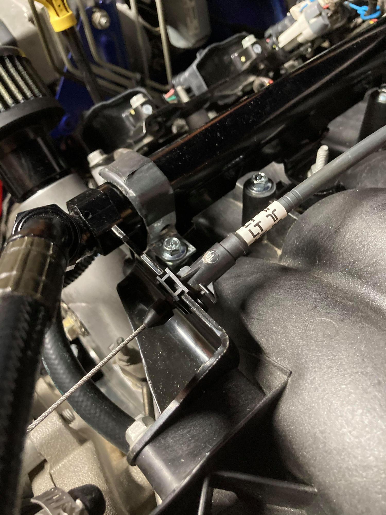

It's not a matter of being "better" than the LS6 intake. It's a matter of once you've had a massive fuel leak from an injector due to the intake pillar mount for the rail breaking you can't get bad thoughts out of your head.
I used some jb weld plastic bonder to fix the pillar and made a bracket incorporating a manifold bolt to hold the rail as well. The bracket I made actually held the rail solidly in place without the pillar mount bolt in. I can shake the rail and move the car with it so it's solid, but I'm just not getting bad thoughts out of my head.
