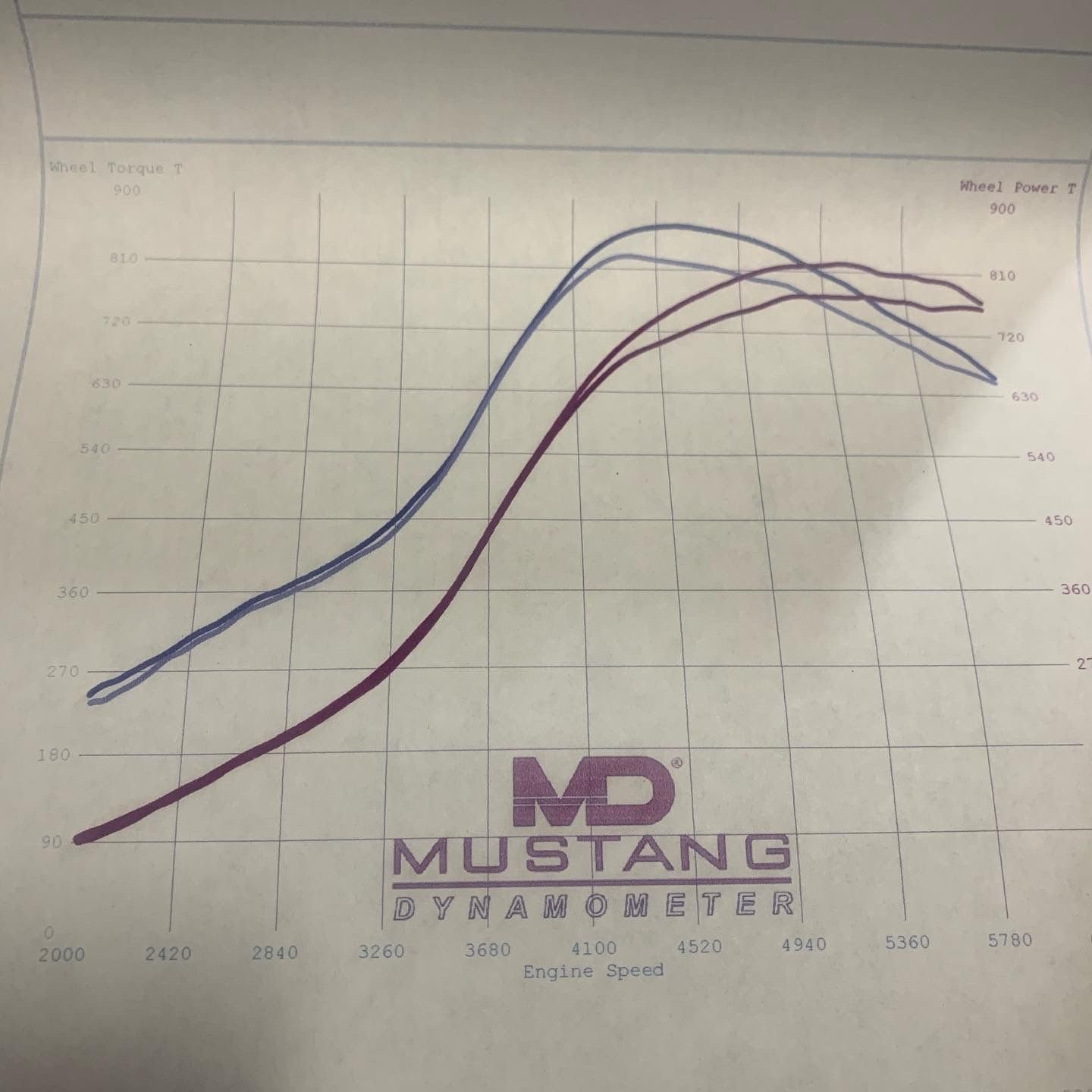

I would really like to see what’s needed for me to rev higher with my current setup. I own a dyno, I’m going to put it on tmr and see how bad power falls off if I rev higher. even if tq continues falling, if HP carries without dropping then I would benefit using that extra rpm? Or should I just be shifting around my current 6200ish because tq hasent dramatically dropped out?

Based on current graph, appears hp will peak around 6300. Yes, you'll benefit with more rpm until the hp starts dropping off. Street car? Post new graph once you've run it out past 6800. The heads flow a lot more than you're currently using. Maybe someone will chime in that knows the mcsa of the 706/862 to get an idea of what theoretical rpm limit is at 328ci. I'm guessing around 7300. Depending on use, you may not want a motor that runs 3500 to 7500.
Side note - See where your rpm drops back on the shift compared to peak tq to figure where best shift rpm is. Trap rpm typically ~400 higher than pk hp for best results.

Based on that Dyno graph it hasn't even nosed over yet. That cam on a 5.3 should be revved much higher. You're basically shifting at the stock redline. Shift at 7 or 7200 and see what it picks up in ET.

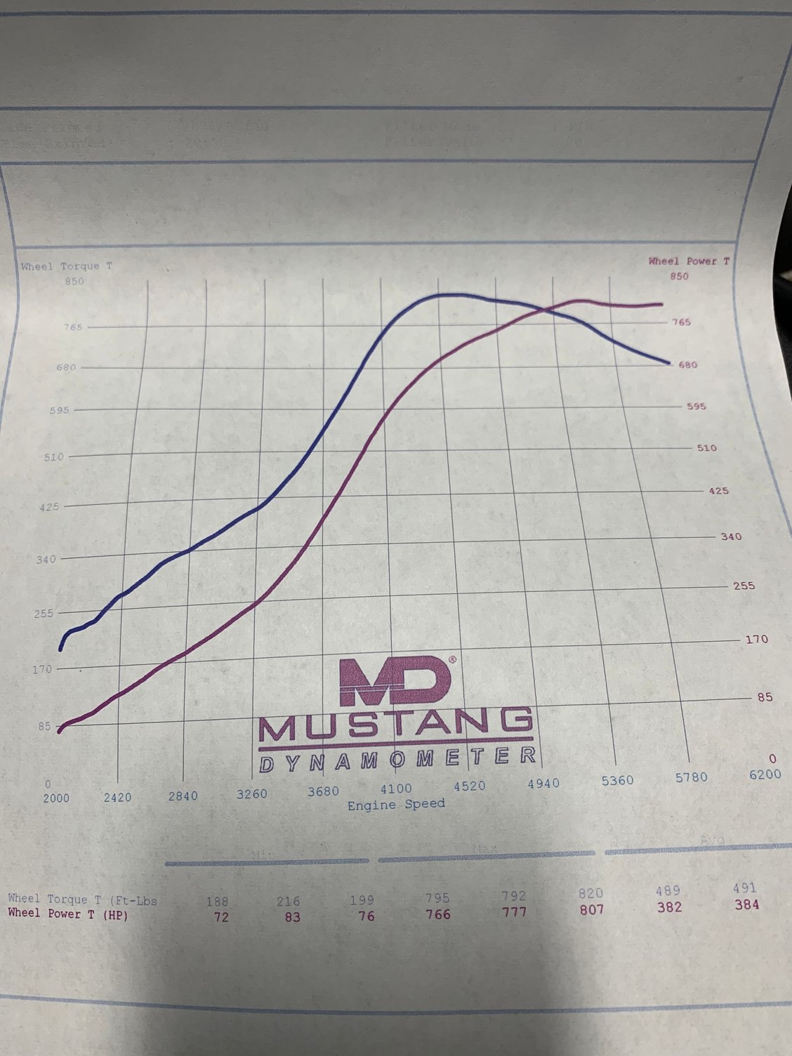

What an exciting day... played with car today for few hours on the dyno. Tuned boost up to 22psi, adjusted timing top end so it dropped from 14* around 16-17psi to about 11* from 20-22psi.
I should for sure hit my mid 5s 60-130 now. Picked up around 130whp/tq.
as for original post, I revved to 6800 entire time. Car carried HP whole time. Obviously tq dropped off. No idea why I’ve been shifting at 6k whole time. Dyno sheet says 6200 but really I was 6800. My dyno uses rpm by speed because my sensor box is broke ATM. Even calibrated before runs, it reads slightly off. Should I try revving higher than the 6800?

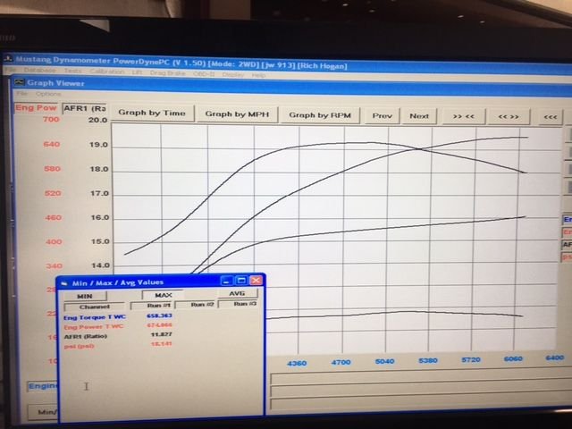

so I revved car out to 7k and it started leaning out to 11.8. Had to raise fuel pressure to get everything nice for the 6800. For some reason the boost started dropping from 250kpa to 240kpa 6800-7k rpm too. So I didn’t bother revving out. Just left it at the 6800rpm. It’s too bad though cause it would’ve went more. I didn’t realize I was pushing my 80lb dekas so much at those higher rpm. Duty cycle was like 105 I think he said after 6800.
i had someone remote in after he looked at my tune logs... guy cleaned up my down low driving and my air fuels under boost when meth was on. I think I’m done pushing this motor for good this time. Gen 3 rods and unknown pistons. Nervous what’s going happen when this thing let’s go. Not bad for some cxracing gt35s lol.

truthfully, the turbos would’ve kept going. We had to raise the fuel pressure after it had entire tune on it because fuel drop off right up top. I didn’t have any idea the injectors were maxed like that. If meth ever shuts off, even with the timing drop, my motor prob done.
as to the rpm situation, my boost is odd. If the tune has to much fuel or to lean or timing to low, I’ll have creep or boost drop. Only when the tune is clean does my car get a nice boost curve. So because the leaner situation up top due to injectors, the boost wouldn’t stay up. Without fixing fuel I couldn’t fix boost, so no point in bothering at this point. Cars already pretty pushed lol. I don’t think I was limited in rpm due to anything except fueling.
