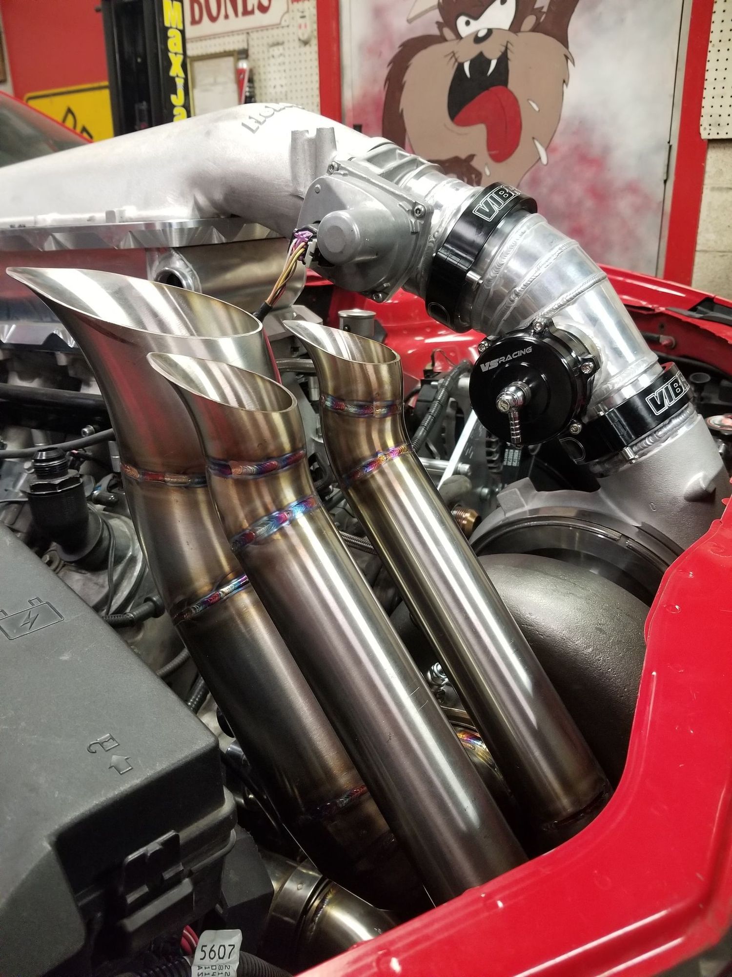

Default Ls3 max boost/KPA
I am looking for a little more power.
Forged LS3
wiseco pistons 9.5:1
compstar crank and rods
PRC heads
E70 (might go to E90)
terminator X
car is 3400 pounds
VS racing 98/113
Currently running around 260KPA. thats 22-23 pounds of boost up here in the high dessert. I have safely been in that range for a couple years now and would like to push it up. Does anyone have experience with an LS3 block in the over 300-330KPA range?

Can run 20lbs on a stock LS3, turn it up! Cool build BTW, what kinda power is that 98/113 putting out at current boost?

hasnt been on the dyno in a while but using around 1200 pounds of fuel per hour according to the holley at 23PSI. running high 5's at 10,000 feet DA
