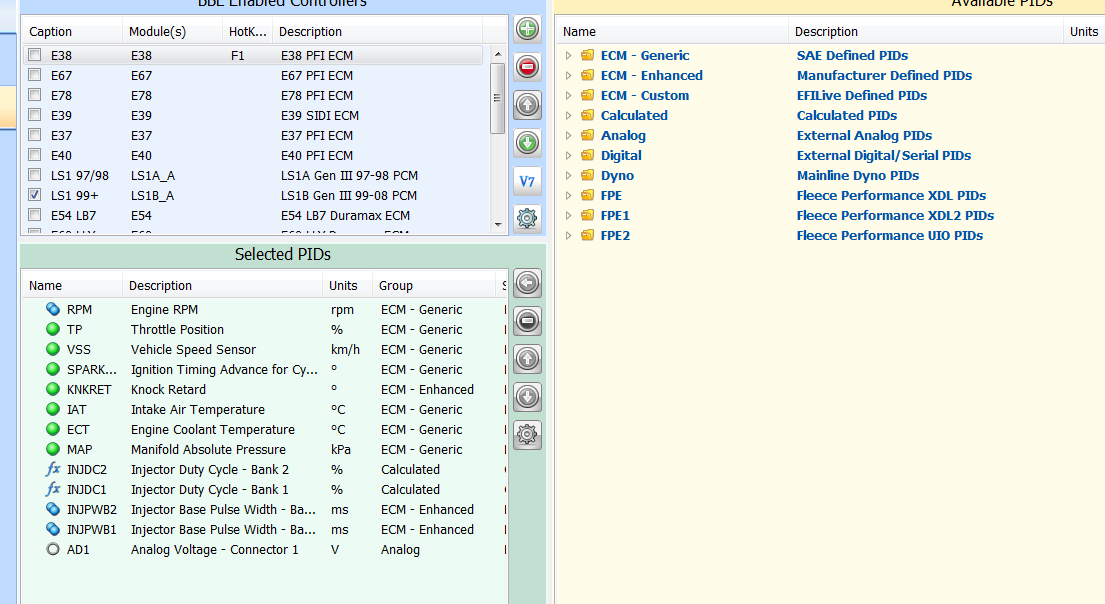

In my previous logs looks like i am using SAE.MAP
I have the Flashscan set up for no laptop, so PIDS are in the scanner from using V8, see screenshot
Now, i read one post that the SAE.MAP without the engine running will only read up to 105KPA in efilive forum......? Is this true?
Have i got the correct pid in screenshot above as cant see any others....?

1 don't use efi live but with hp tuners you have to set up the scanner to log 2 bar , if you log the 1 bar map you'll only get to 105 kpa even with 2 bar map installed. Not much help but I think you're gonna need to set up the scanner function

I have efi live but not sure the question. Think someone mentioned logging only specific map sensors?
I have to log the specific bar in options that car has AND delete the other bar on the list or it defaults to one. But this isn’t really EFI live specific.
