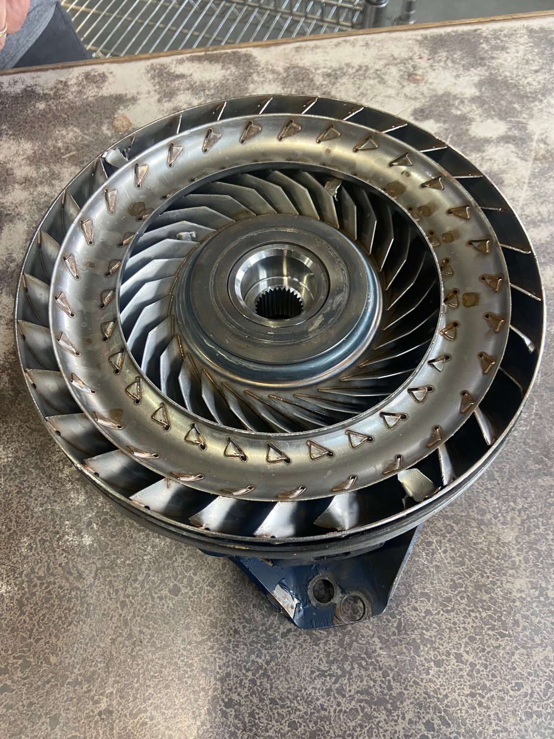

Well here’s part of the problem. Need new convertor. Come on guys I know big turbo cars take while to spool this isn’t my issue
Cheap *** B&M, the Circle D LS Pro Series Billet was around $800 for my TH400 and will handle 1000whp.
Give them a call and run down your combo and they'll set you up, I'd say call PTC but I did and they never got back to me to I went with Circle D and the support is excellent.

A few chunks in that converter.
Which is a budget nitrous piece, rated to 650 hp. Which you will exceed with ease.
I wouldn’t hesitate to call PTC. Give them your combo, be honest about goals, rpm etc and they will likely nail it on the first try.
Maybe have the B&M fixed for use in another project.
Would also be interesting to know the specs on the S475. There are a few variations on the exhaust side.
BTW, these setups aren’t going to make boost below stall speed. Unless it’s on the 2 step.
Detuning to run 91 octane isn’t helping either.
On another note, my S484 doesn't spool slow, in fact it spools faster than my old T7875 did, different combo but you get the point. ; )
yeah got circle d with a specd unit 1100 cnd before shipping and three week wait lmao seems like I’m gonna do it
I've been very happy with mine, it locks up nicely and with the billet mounting surface you'll get years of use.
Guarantee you'll be floored how big a difference the new converter will make.
