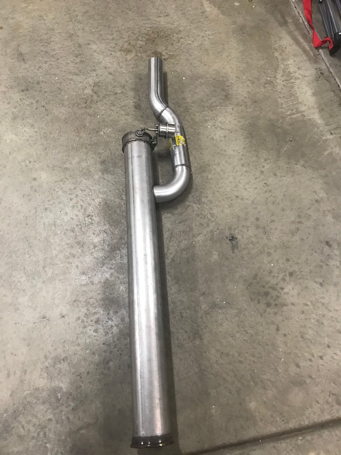

3 window's Avatar
Joined: Aug 2014
Posts: 2,051
Likes: 187
I run a cutout on my Nova as well. 5” to 4” with a 2.5” system just up stream of the cutout. I can tell you this, I made two rips this morning and the cutout didn’t open (my fault, fudged a setting) and it wouldn’t make over 15 psi with dome pressure that usually nets me 22-23 psi. Still ran fairly well considering. Bigger is better when it comes to exhaust and I’ve seen results that for very psi of backpressure POST turbine, is worth about 2-3 psi PRE turbine. Zero is obviously the target. I waited 3 weeks for my cutout to come from China way back when, but it was about $50 shipped FYI.

Old Aug 24, 2021 | 06:50 PM
3 window's Avatar
Joined: Aug 2014
Posts: 2,051
Likes: 187

Pro Stock John's Avatar
LS1Tech Co-Founder
Community Influencer
iTrader: (34)
Posts: 45,364
Likes: 1,796
From: Chicago, IL
Very cool. Pretty quiet with the cutout closed, any video?
Old Aug 25, 2021 | 07:20 AM
3 window's Avatar
Joined: Aug 2014
Posts: 2,051
Likes: 187
Super quiet. Smaller system exists in the factory location behind the right rear wheel. All I hear going done the road are the injectors, fuel rail echoes, valves clapping, all other LS engine noises. I’ve come to fooling myself into pretending I’ve got a set of Jesel rockers on it.
