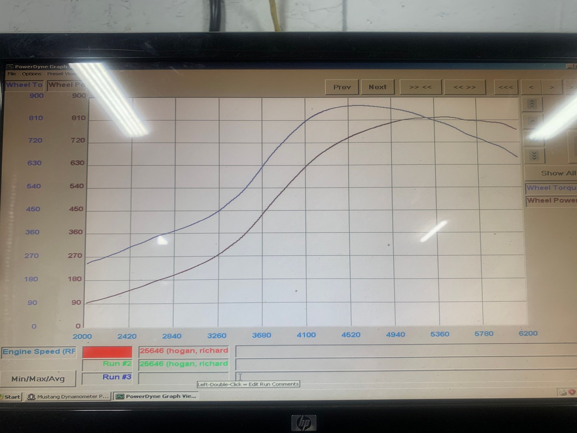

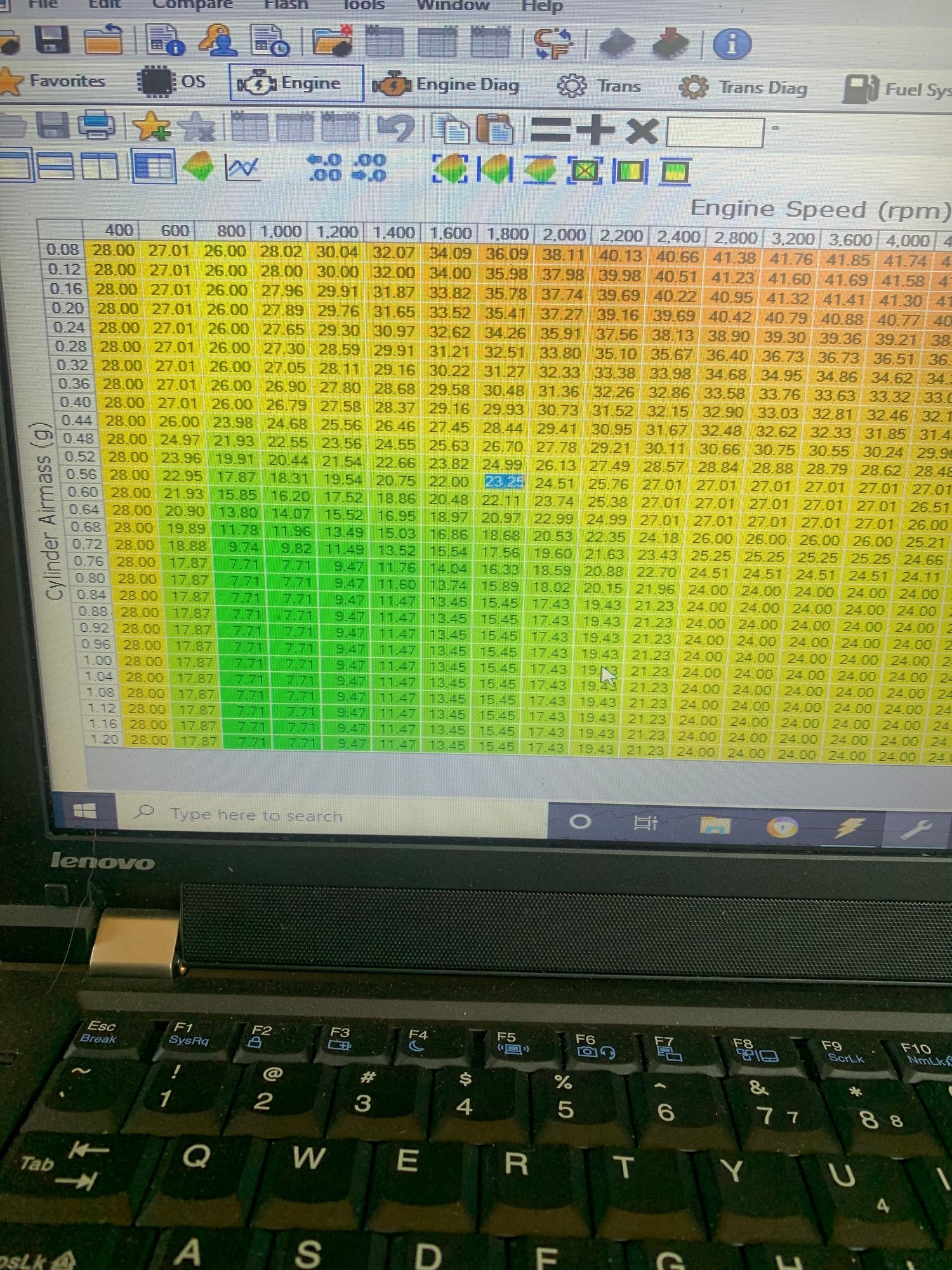

I honestly don’t know the size jet that came with the Alkycontrol kit. I have the setting maxed out basically now for the M1 and my 80lb injectors are around 80s% duty cycle pretty sure. My car was originally tuned by someone professional who puts out bunch of newer vettes and other American cars. He gave it to me around 660ish on 17ish psi on my 2nd time back. 1st time is was around 550-ish on 14psi or so. He wasn’t comfortable putting more boost to motor. I also own a dyno so I played with it after that but I had his tune to continue off of.
my timing is in pictures. I added .5 degree from 5500-6500rpm after this picture was taken to keep some power up top.
boost was around 22psi and 25psi in 4th gear. 4th gear is where I do my dyno pulls so my 900tq and 830hp was at the 24-25psi level. Some of that boost is creep up top. So 21-ish up to tq peak and after tq curve I prob do the rest to 25ish. Not sure why but my car struggles to hold power after the curve. Without that extra timing and extra boost it dropped off pretty good.
dyno chart was from earlier so prob around 22psi. The 25ish got me to the 900tq
