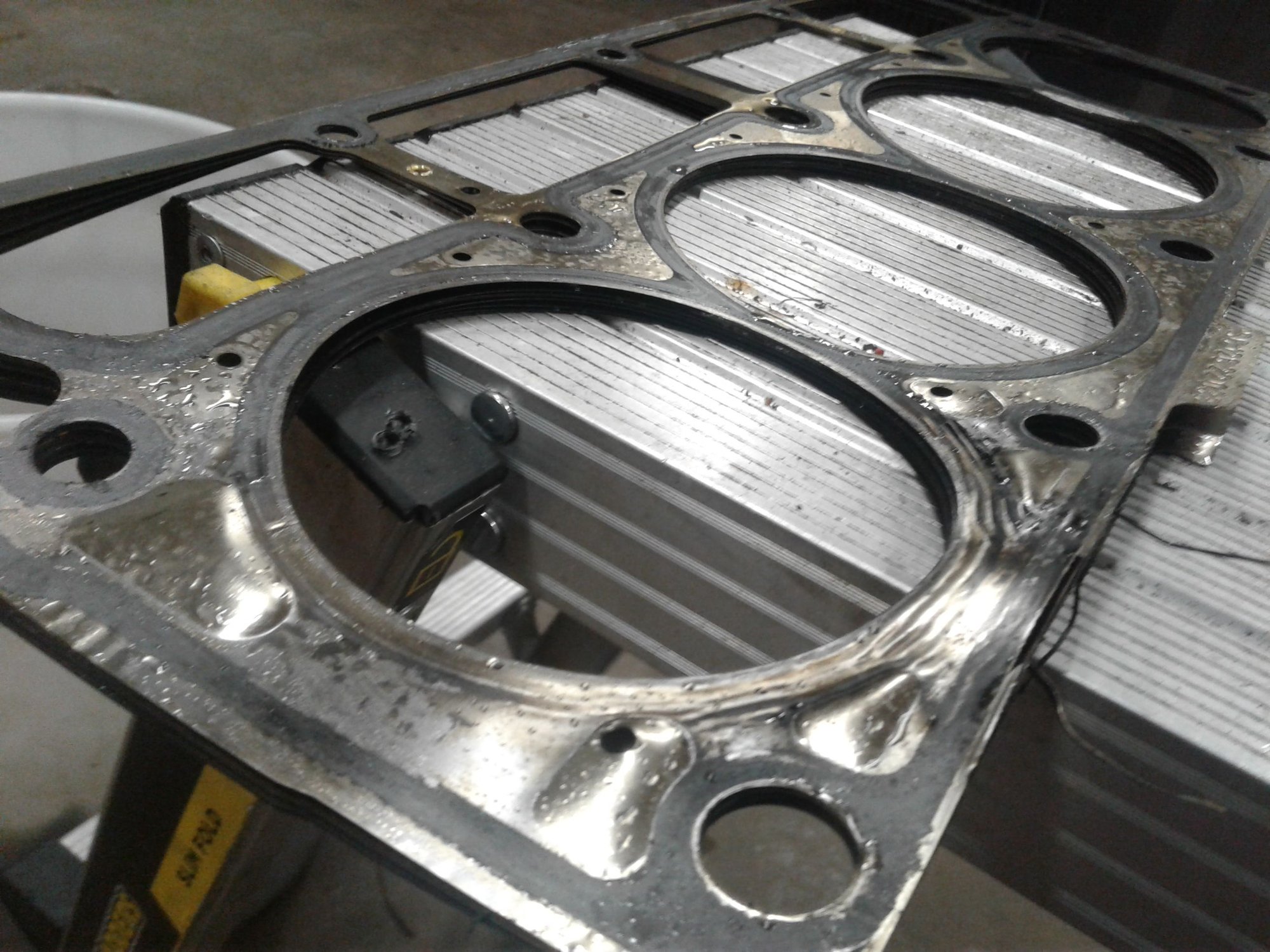

I never had an issue with my 6.0 with ls9 gaskets and reused head bolts. Rebuilt It, had the heads and block decked and got new ls9 gaskets and put in China studs. Blew the driver side gasket out around cyl #1 on about 12 psi. Took It apart, made sure everything was still flat, put new ls9 gaskets on both sides, and it almost immediately did the same thing.
I have since swapped to prc heads with the thicker deck and arp ca625 studs, (normal studs were on back order). I really think it was the China studs being I didn't have an issue with stock bolts, but I can't rule out the head was thin and warping. It was blowing out between the 2 head bolts right outside of cyl #1, it would also push water.
edit- that's also really rich for e85. Need to lean that out a little lol timing seems safe if it's correct.
on this gasket was it put on wrong.It looks like the small hole on the gaskets was put over the larger water passages in block.This was a question I had on the some of the ebay gasktest.They have front marked on the gakset and that put the larger ports towards the front of the block instead of in the rear where the larger ports are.I could be totally looking at it wrong and looked all over the net trying to find out with the ebay gaskets as far as proper orentiation.

Originally Posted by joes1966
on this gasket was it put on wrong.It looks like the small hole on the gaskets was put over the larger water passages in block.This was a question I had on the some of the ebay gasktest.They have front marked on the gakset and that put the larger ports towards the front of the block instead of in the rear where the larger ports are.I could be totally looking at it wrong and looked all over the net trying to find out with the ebay gaskets as far asb proper orentiation.
nope it was installed 100% correct. Them saying front on them makes it easy, and that was straight from the dealership. I believe the china studs were just junk. The gasket pictured was after 1 40 mph roll on to 12ish psi, blew it's back right out. Lol
in the 2 pics one has front markedl and it puts the larger water passages towards the font of the engine.The original ls 9 gaskets in the 1st pic have the larger water passages in the rear of the block.This is where I had some confusion during install.When I saw you pic it looked like something pushed your gaskets up right at the passage port.Im real new to this and alway looking for info
