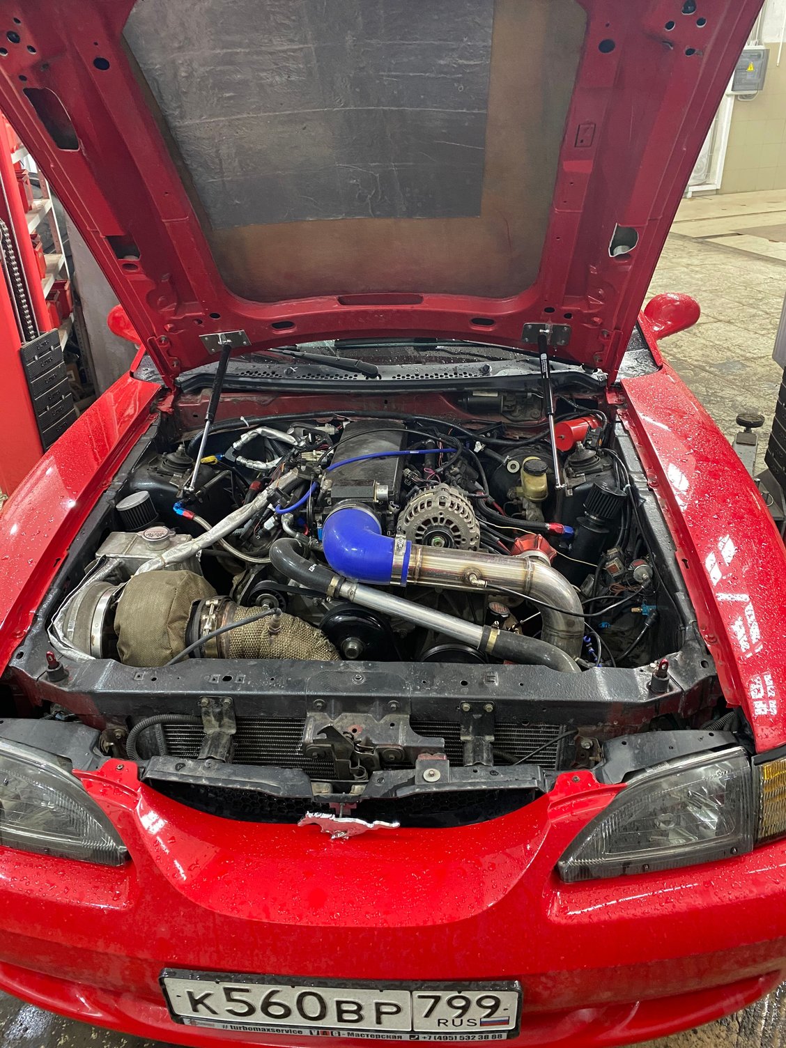

If you really are in Russia, would love to see some photos from the car scene over there, love hearing from diff parts of the world what their doing with cars. I remember a guy over there with a chevelle.

Now that's cool, didnt realize they had a track. Has to be hard to get parts, but looks like you guys are doing good. When we have Drag Week over here, we get guys from several countries come over, but Covid 19 is affecting travel. Really interesting to talk to them.
