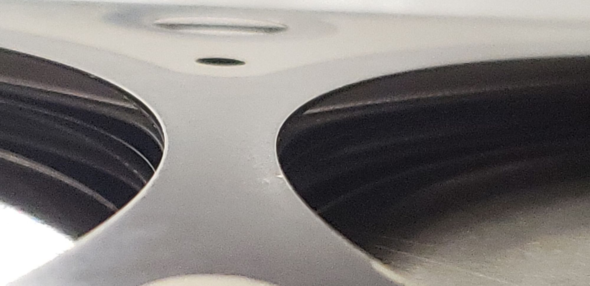

Originally Posted by G Atsma
Uhh... you don't "bore out gaskets" and expect anything near functional out of them... there's a reason there is a rolled over bead along the inner diameter.... smh...
....but there isn't. Two seconds with a high zoom and you can see the bore sealing surface terminates several thou before the machined surface of the gasket. It is not a rolled edge. Out of the factory it is not an incredibly refined cut along the bore sealing surface.
It seems like you are firing off advice here without actually knowing how these look....
