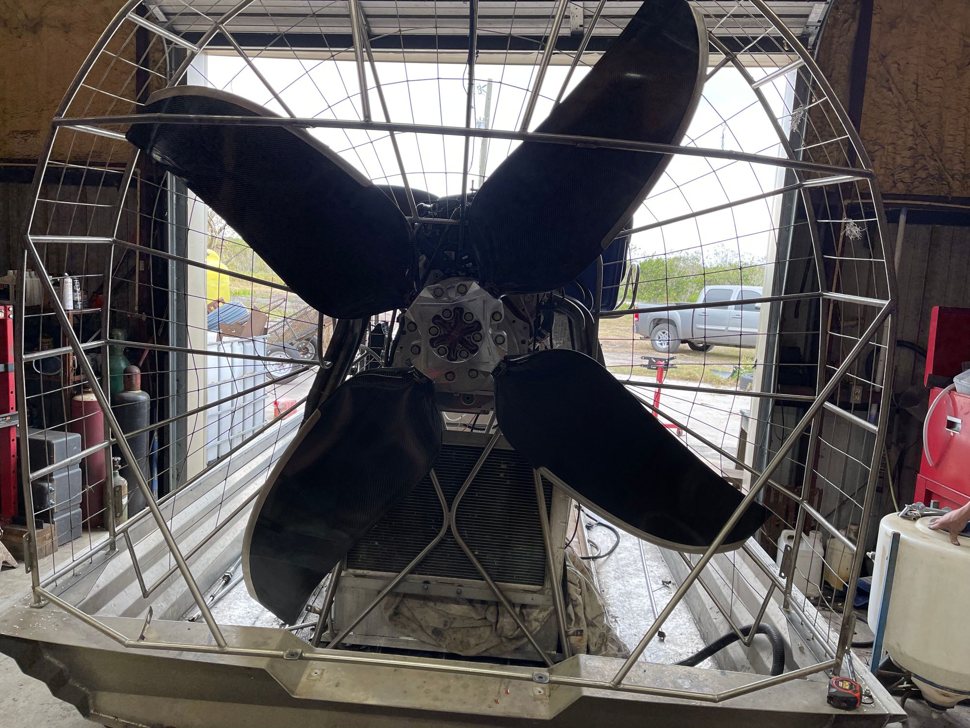

Solution would be adding another turbo IMO. Properly sized of course. Still cheaper... Still performs better. What type of prop? Air boat style? Underwater prop? Jet boat?
This is the kinda prop I’m speaking of
Old Nov 3, 2021 | 11:49 AM
Forcefed86's Avatar
Joined: May 2011
Posts: 8,487
Likes: 1,034
From: Wichita, KS
So with that type of prop, response isn't really a huge issue. You'll have a huge delay between pinning the throttle and getting max speed on the water. You'll just be able to run a lot more pitch with more power. Pair of 61/65s all the way up to 72/65's would be fine. And cost Roughly $280-375 each.
