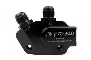

That pan has the stock provision
You want the improved racing thermostatic adapter that holts to the side

This is the full size version they have a thin version too
https://www.improvedracing.com/lsx-l...rear-sump.html

Dang lol, I actually have one here, I bought it for my 5th gen a few years ago and never used it, one like this:
Lol, yep you're good to go That is the slim version
