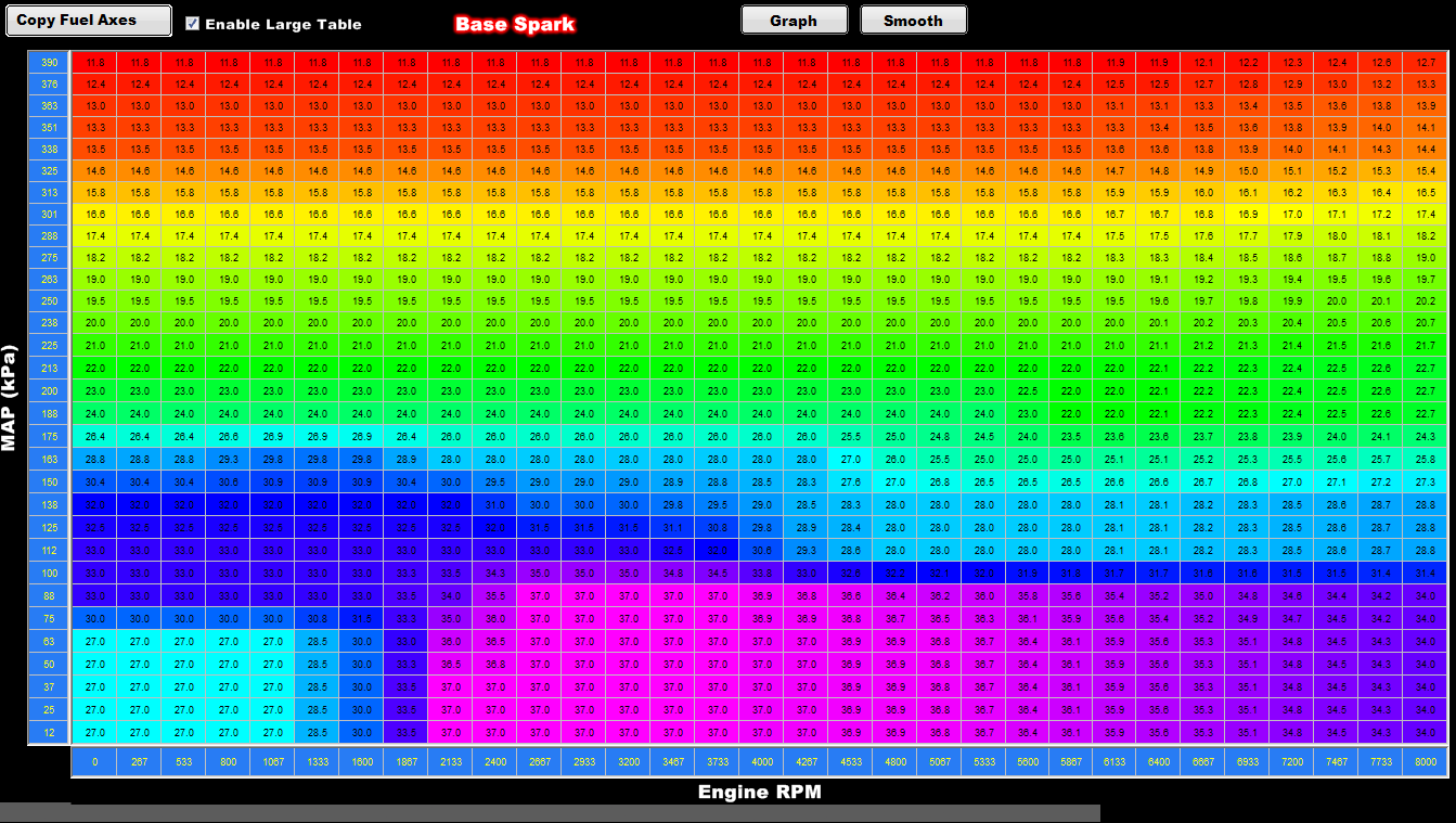

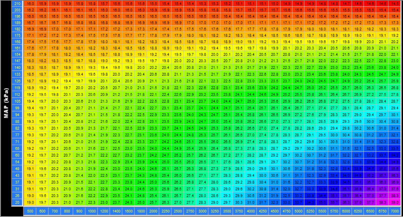

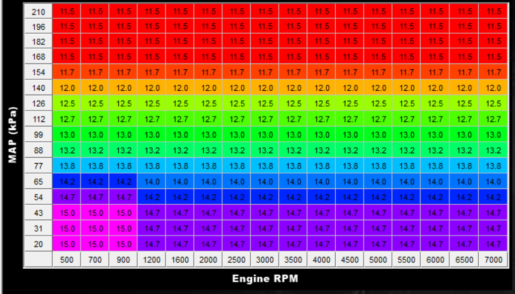

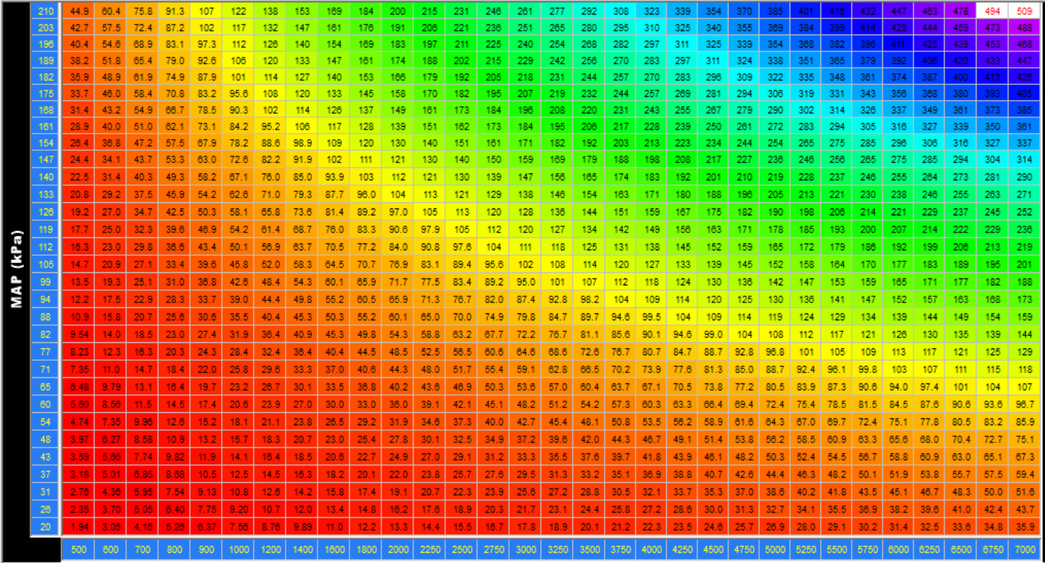

So I found some time to swap out the billet gen 1 78/75 and swapped in the new next gen billet 70/70. I modified the hot side to accept a 1/8" NPT bung to log pre turbo back pressure with the new smaller turbo.
Now I'm working on my tune so I wanted to rescale the base fuel table, AFR table and spark table to a more granular range that I operate in. My only concern is that I topped my fuel/spark to 210kpa which I normally average about mid 190 kpa during normal driving with my EBC commanding 30% over spring rate. It doesn't give me much margin for error I guess but originally my scaling went from 0 - 285kpa and it now goes from 20-210kpa. I normally idle around 50kpa so I would change the lower to 30-35kpa and increase the top end to 225-230 ish if need be. Anyways I wanted to get your thoughts on the updated tables. I pulled my fuel and spark data from the running tune and swapped and populated the new scale to get the fuel and spark close to what I had before. I changed back the learn fuel correction back to 50%+/- so I have the safety for the first couple of drives. Then I will transfer learned data and get me back to +/- 2% as it was before. I normally push 13psi on the street but I have been up to 15psi at 50% duty cycle on my EBC (setting 2) but I never put it on that one.
Anyways let me know your thoughts and if you think the timing should come down more. I wont be able to drive the car for at least 2 more months though. Just trying to get my ducks in a row for spring!

Here are my AFR and timing table for pump E85. Setup is a 5.3 with twin PTE 6870s. I run anywhere from 3psi on a ramp to 45psi.

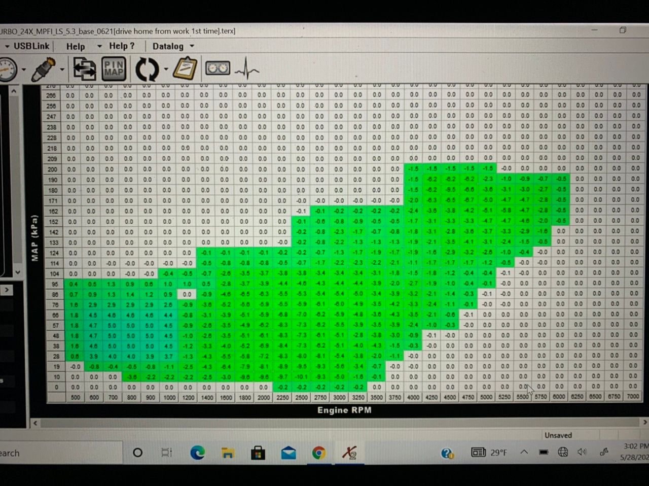

Took the car out on Friday for its first drive with the new 70/70 turbo, no change to the tune. Here is a pic from the fuel learn table and Fueling was from the billet gen 1 78/75 OG. Looks like besides around idle it’s pulling fuel which suggests lower HP output. Except at the top end which I hit 13psi on the EBC which did the same with the 78/75. Car didn’t seem much slower but also felt like it hit a wall at 5700-6k the one time I spun up that high. At the top end the fueling was less than 1% difference. Mostly less than a 5% difference than the 78/75. I did hear the turbo much easier through the full exhaust than I did with the 78/75 and it seemed to get rowdy quicker. I didn’t get any logs but that’s next… I just wanted to make sure it ran fine and didn’t blow up as it was the first time it’s been out in 6months. Logs are up next drive and I’ve also loaded the new tune with the 210kpa max MAP as well as the adjusted fueling and timing tables.

I find that for street cars, you don't need more than one row per 2 pounds of boost. So if you plan to go to 15psi, I see no reason to have more than 10 rows in the boosted area and devote the rest to NA.
Andrew
