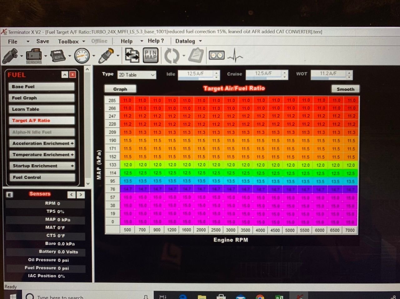

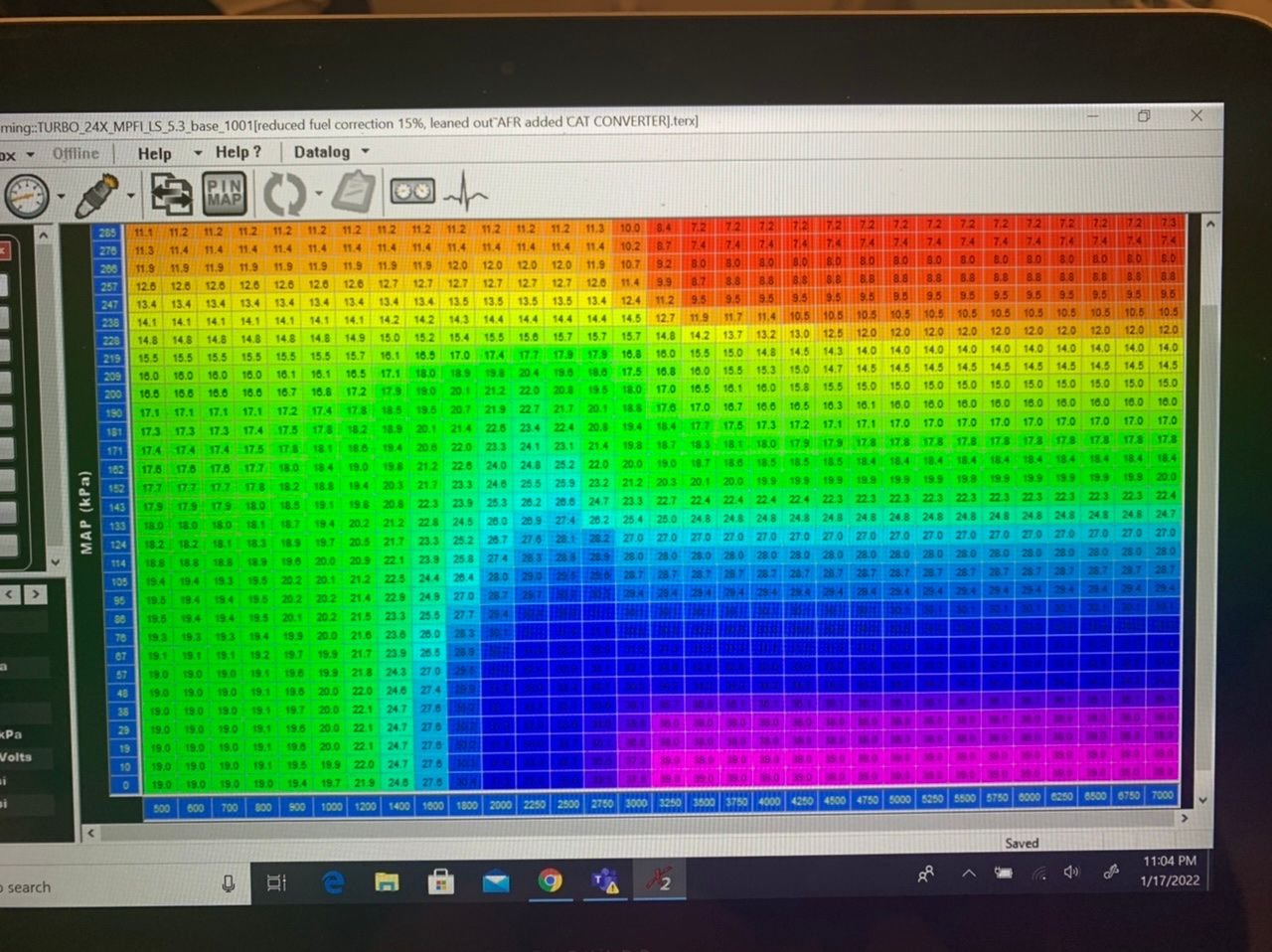

What's the tune look like when tryin to get into boost?
Old Jan 17, 2022 | 07:06 PM
customblackbird's Avatar
Joined: Nov 2015
Posts: 2,268
Likes: 172
Timing - 93 pump, FMIC and spraying 750ml of wiper fluid progressively
Fuel
AFR

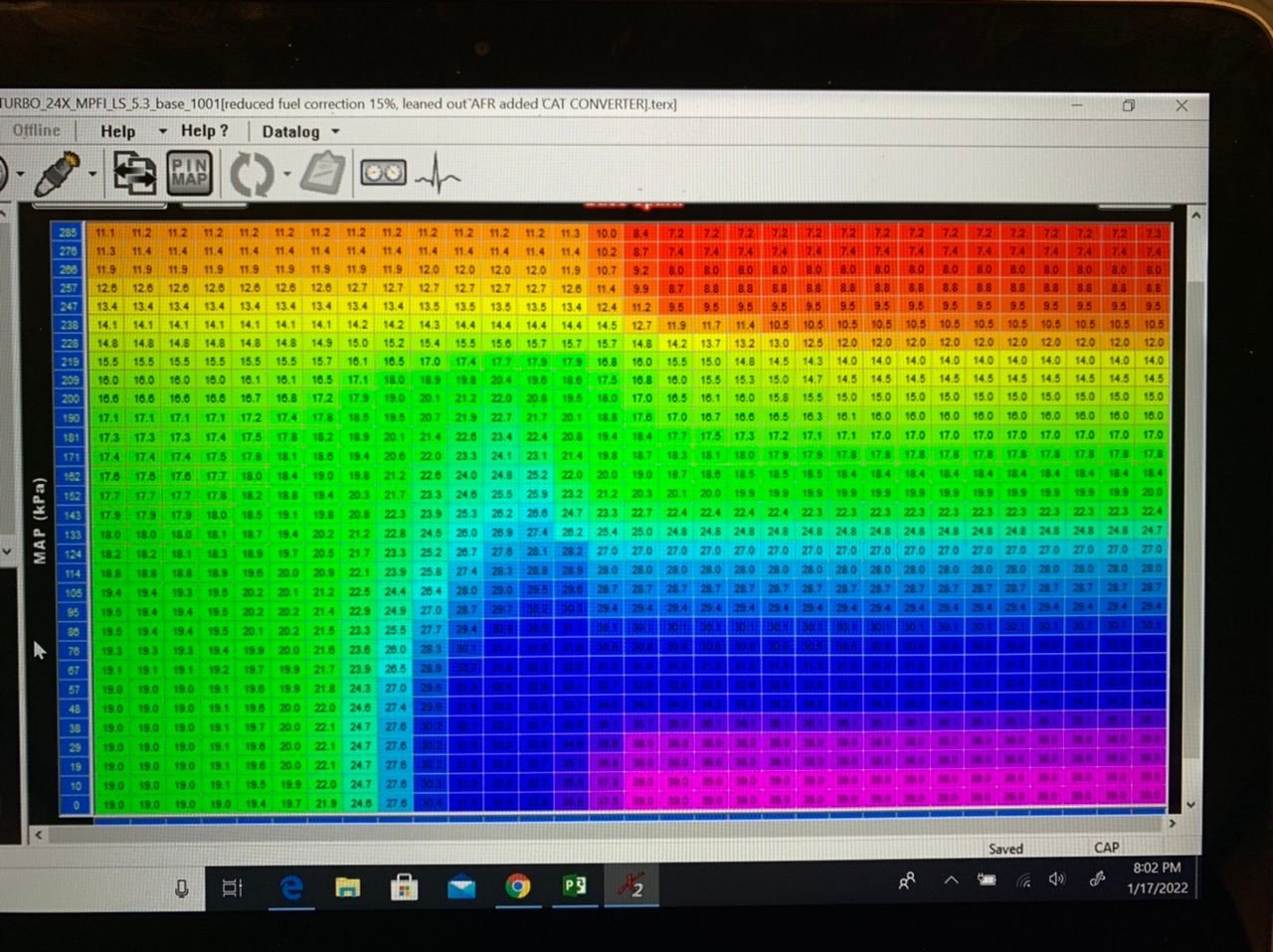

Old Jan 17, 2022 | 07:08 PM
Joined: Nov 2015
Posts: 2,268
Likes: 172
these are slightly higher res
Old Jan 17, 2022 | 07:17 PM
ddnspider's Avatar
Posts: 14,628
Likes: 1,778
From: FL
Can't see the rpm axis of the timing graph but timing looks soft if I'm guessing right. AFR looks ok.

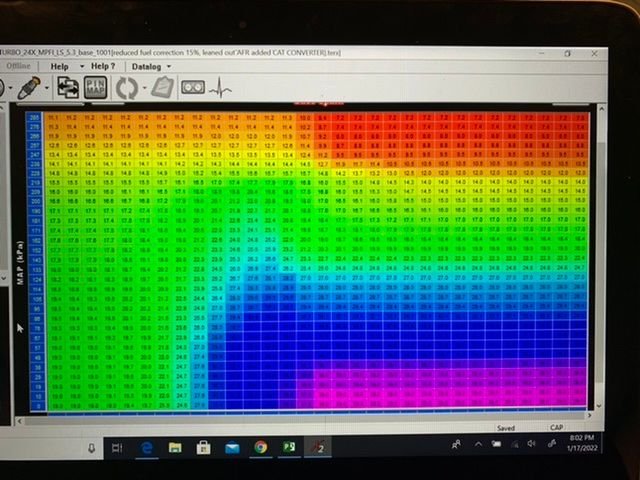

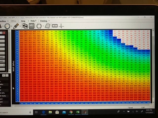

Old Jan 17, 2022 | 10:07 PM
Joined: Nov 2015
Posts: 2,268
Likes: 172
sorry, see new pic for the rpm axis.
Old Jan 18, 2022 | 06:16 AM
ddnspider's Avatar
Posts: 14,628
Likes: 1,778
From: FL
Wow I didn't realize the rpm columns were in such small increments. That does look ok.
Old Jan 18, 2022 | 07:12 AM
Joined: Nov 2015
Posts: 2,268
Likes: 172
