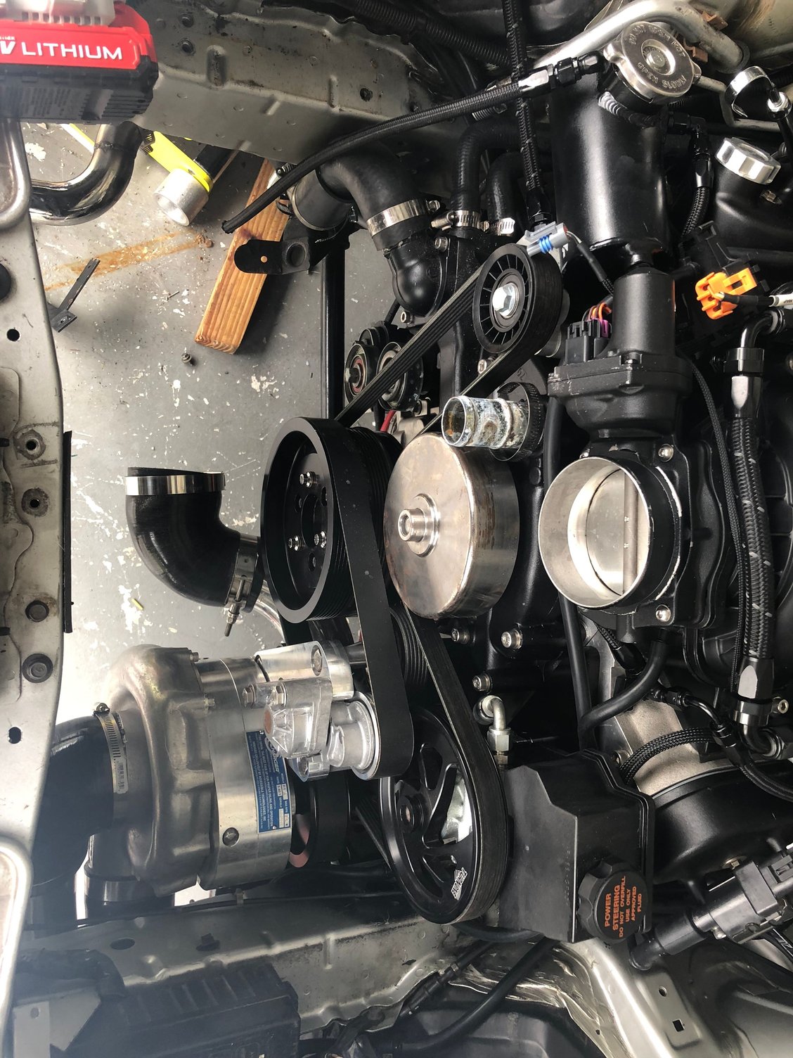

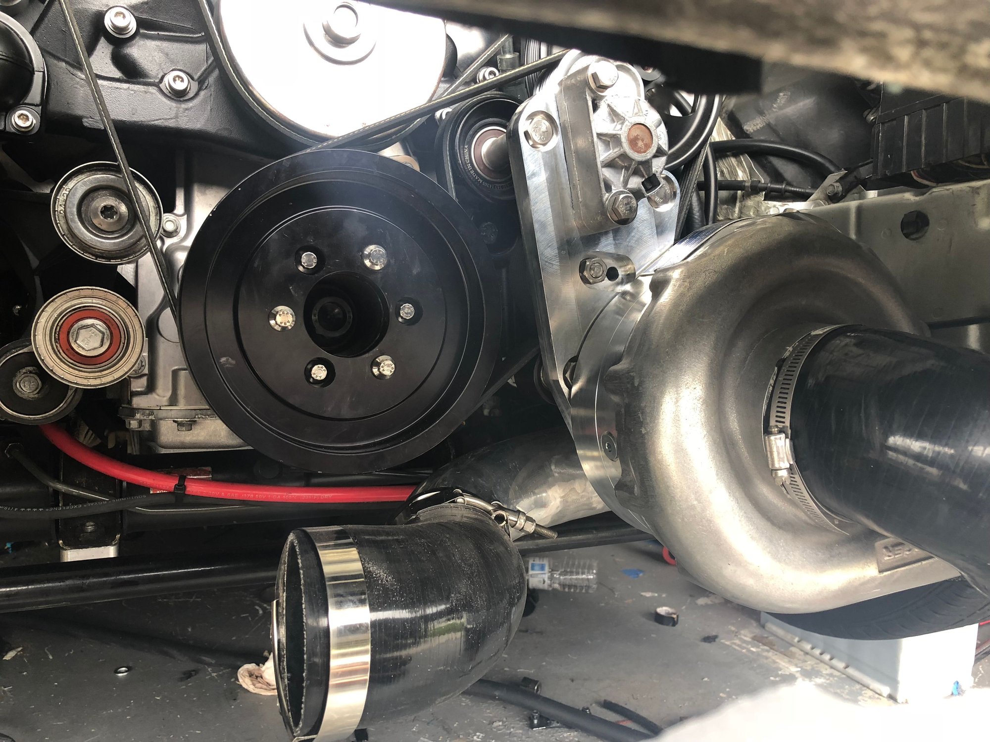

Take a pic of your car with the hood open. From what ive seen in the past the gen 5 camaro kits run the procharger on the top drivers side and the intake faces the driver.
If this particular kit doesnt work you can always buy the head unit and run an fbody aster bracket (contact bob @ brutespeed for info). Its a better bracket with more belt wrap and it puts the head unit on the bottom drivers side with the intake facing forward. I have this kit with an F1a on my 93 mazda RX-7 and had to tilt the radiator forward but it works.
Hi, I defo don’t have the room to mount low like yours. I’ve been chatting to Bob at Brutespeed and looks like I may have a solution. Th eggy here with the Camaro kit is including the damper which pushes all my accessory’s out of line so trying to figure a way out of buying a new damper. At the end of the day it’s the cost of getting stuff over to the Uk that is limiting me
