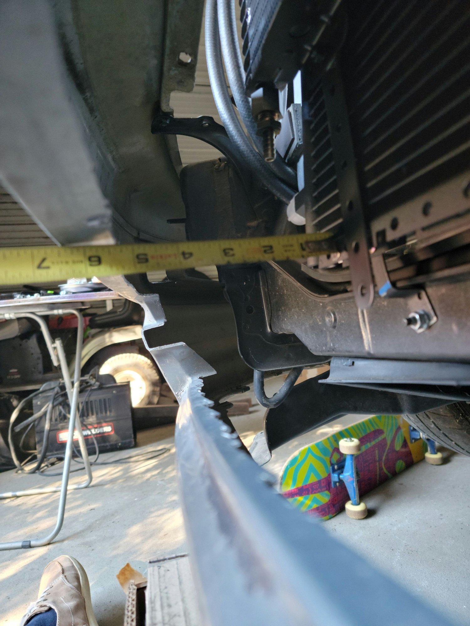

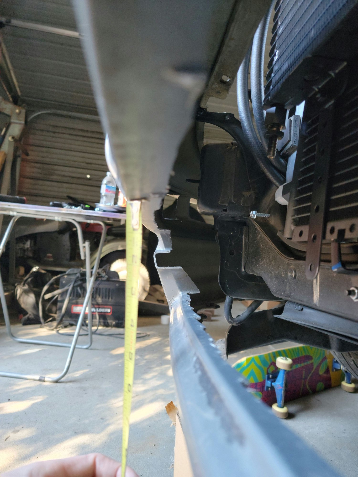

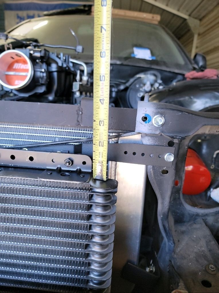

Hello I have a one off swap a lexus ls400 with a 4.8 turbo. I'm having a issue finding a intercooler slim enough but yet still efficient. I was set on getting a treadstone TR1045 but after making a cardboard stencil it's not fitting. Any other suggestions on intercooler I could check out? Here goes some pics for reference. The ls400 bumper is weird the lower part sets back a good 2-3 inches. Thanks for any help
I can move the condenser and trans cooler up flush with the flat bar brace. (Have to have ac this gonna be my daily and i live in the south lol)

Air to water? - looks tight for an air-to-air, but could fit a pretty big water coil there.

What's the power goal ? Depending on that something 3" thick might fit in there and get the job done . Summit , mishimoto , vs racing?

I was looking at this one on summit https://www.summitracing.com/parts/sum-260003 power goal is 500-600 have to have the same height no taller then 10".

that particular one has 2 1/2" in /out , not sure what size you're planning on. I would get out some more cardboard and make models of the various options to see what would fit best
