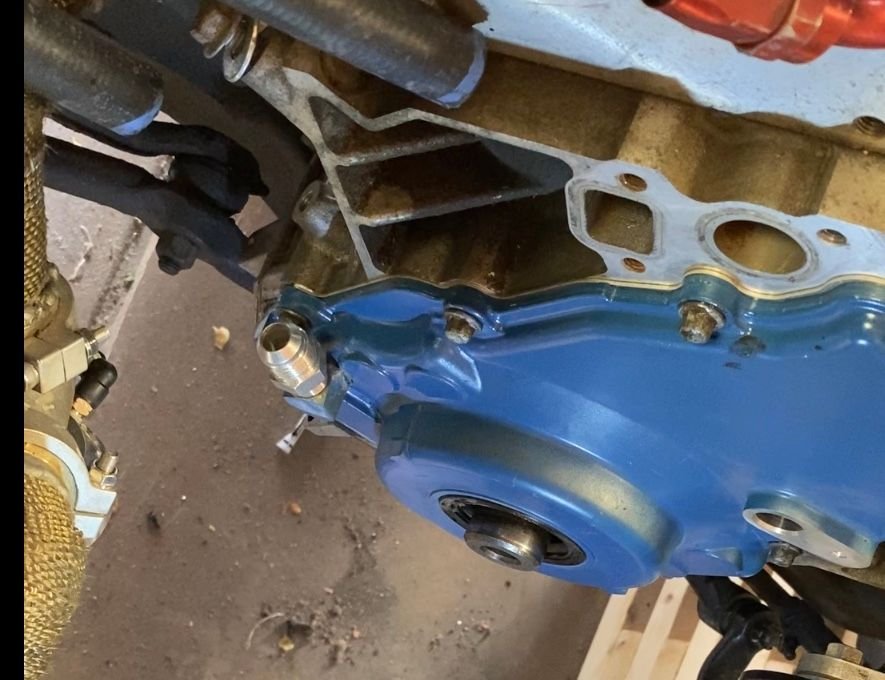

I drilled and tapped the front cover just like everyone does for the oil drain, threaded a 1/2” NPT to -10 fitting in it then put my truck balancer on… my -10 90 fitting that I grabbed off Amazon doesn’t fit, does a tighter radius 90 exist? Everything I see doesn’t have dimensions.

Lowes or home depot brass fittings are tighter radius then most aftermarket race stuff.

Easy trick for next time is to angle the fitting in the cover a bit instead of perfectly straight in. Helps a LOT with fitment and has zero downside for the things that matter.

XRP makes tight radius fittings. Part number is 209010BB for -10 90*

Racetronix sells a 10an banjo fitting hose end if you're in a pickle.. about a tight as you can get for a 90.
I used a Lowe’s fitting to make the turn into mine & it’s tight with the C5 set up

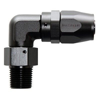

https://www.racetronix.biz/p/fitting...blk/fit-199010
