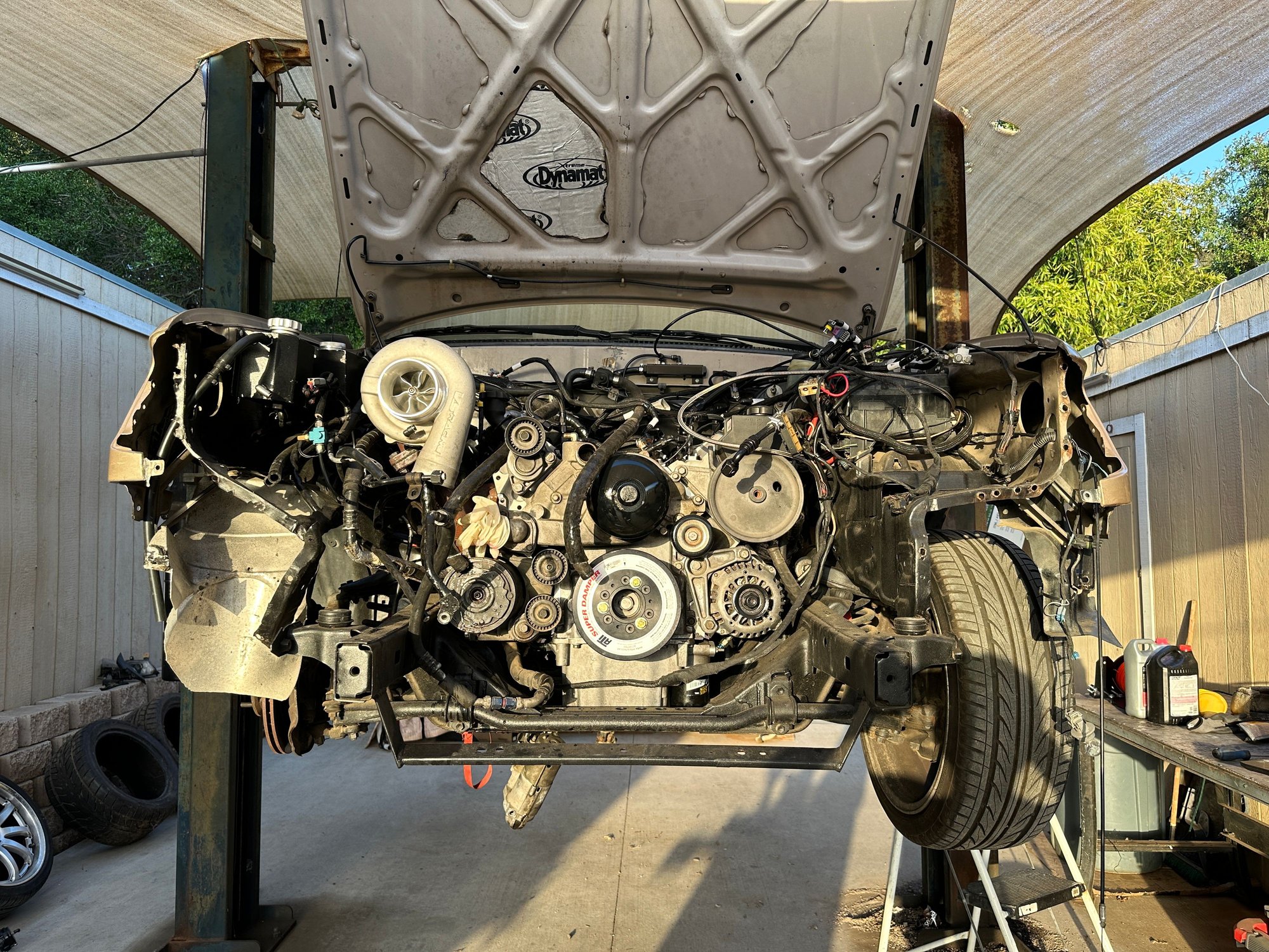

Im finally getting around to putting my billet turbo on my engine so I pulled it and stripped it down to the shortblock and now Im mulling over some options. I want this thing to last but hear that those 99 LS1 engines can't be pushed too hard without failure.
I am shooting for 600rwhp on pump and 700 on E85 on a Holley Terminator, I already have the VRS 7875 Billet snail, 780cc injectors, using the LS6 intake unless I find a nice fast 102 out there for cathedral port.
Anyway I want to upgrade the pistons and rods but already have some Gen4 rods on my bench but not sure I will find pistons in the proper bore that will fit, so that brings me to my next question, I was thinking about maybe just getting a complete rotating assembly and turn it into a stroker, but not sure thats the best plan of action for my goals..
Anyone else built an LS1 for boost and what did you end up doing (also what power did you make)
Just trying to do this once so I dont need to learn some hard and expensive lessons!!
Thanks in advance guys!

So what has happened since then was I did end up pulling the engine to prep for boost on the stock short block, I got better pistons, proper gap for my boost level, put it all back together and installed the VS racing next gen 7875 w/billet wheel turbo, 5" exhaust from the turbo outlet all the way to the axle where I split that into dual 3" pipes for dual exhaust that comes out where the stock one does and mirrored that and even used the Toyota TRD chrome fancy tips..as well as added a Terminator X ECU for engine control.
So after I got it all back together the knocking I previously heard, but didnt think it was a big deal) got louder really fast when I added 12psi to the mix quickly letting me know we have an issue!! So back to the garage I went and since I was tearing it down once again I just said F-it and ordered a complete rotating assembly from Summit racing and since the cost was the same for stock vs stroker I opted for the 383 version since Ill have it torn down anyway and had an SBC 383 many years ago and loved the huge torque increase it provided..
Cut to current time, I have the 383 all built, installed and running on just a base tune at the moment, 12psi was just bonkers on the street so I pulled the WG spring and but the little guy in there so it only makes 3psi WOT now, however I also have an electronic boost controller that I will be programming for the "Dial-a-Boost" setup on a dial with 7 detents which I will likely just program as detent 1 does not adjust it all and every detent thereafter adds 2psi for a 12psi max boost until I get things dialed in and then Ill change that if needed.
But it runs great now and holy hell it fries the tires very easy with all the power it has, so much fun!

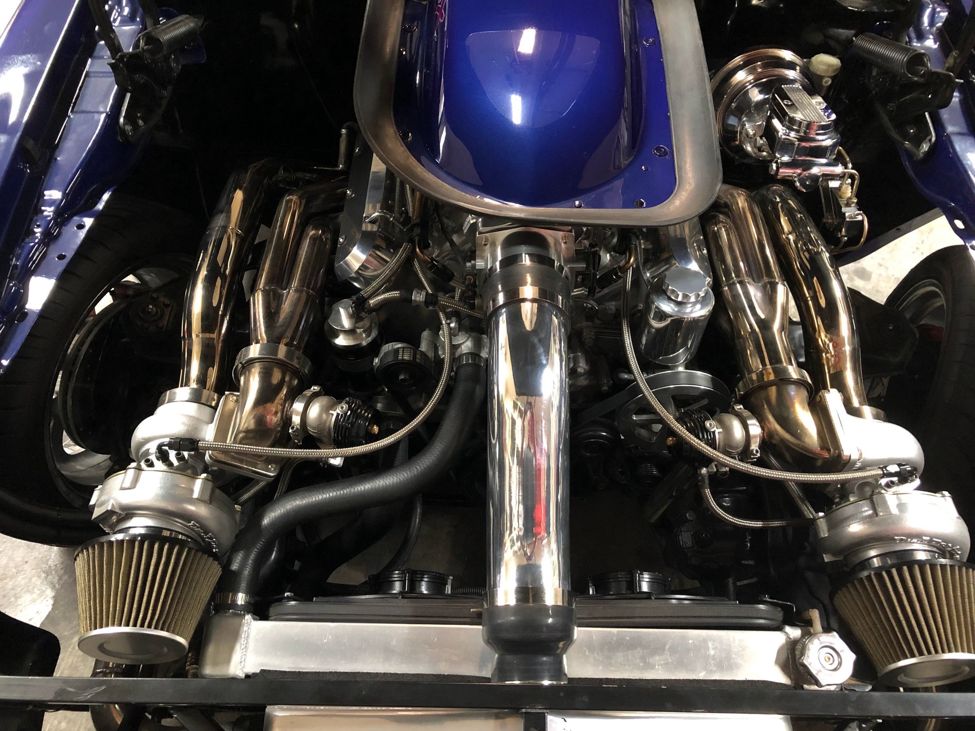

I have a 2000 LS1, sbe, TFS 220 heads, FAST 102, cam, twin turbo 14psi on E85.
It's making well over 700 wheel I'm sure, haven't had it on the dyno yet.
It made 430rwhp N/A with ported 5.3 heads and a LS6 intake. With the better heads and intake, it would have probably made 450+.
Add one atmosphere of boost on top of that with cool turbo noises.
Best thing ever.
