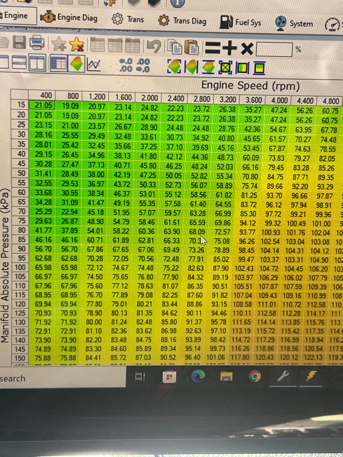

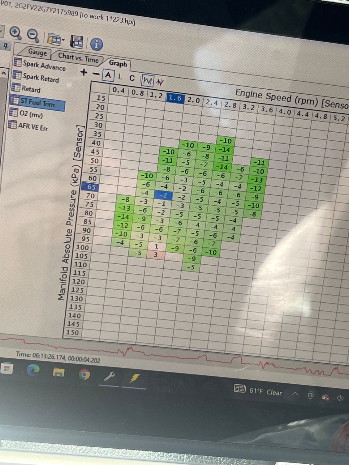

Got laptop in my car at work, this is on a log to work, slowly reshaping my VE table back up. Attached is my log and photo of the changes I made according to the log.. VE table only done to 3200&100KPA. The rest is just roughed in and multiplied for safety. Once I get it bashed out and my meth kit on I’ll do the whole copy paste interpolation to reshape my boost side table and start to push it further…been chewing on it, my cam is a NA max effort setup, it’s a whole different animal with being fed the air that it would have to normally be trying to scavenge at lower rpm. Possibly why I am having to give it so much more fuel so much sooner..either way. I’ve never tuned a forced induction car from scratch so be gentle on that VE table. LOL. It’s so odd to me, spent hours dialing in my NA VE setup only to have it be COMPLETELY wrong now. Possibly the inefficient cam characteristics are being pushed away by the motor being force fed as much air as it wants and not have to vacuum scavenge it?..I’m highly considering having frost build me a base tune for me to have SOMEWHERE to start but I’m unsure of his abilities to do that comfortably on my oddball setup..note my .8 rpm column is what I’d call dirty data. Picking up rich decel into idle and STFTs hang negative..don’t know how to get rid of that besides running DFCO

You keep saying it's pig rich, but also say you have to keep giving it more fuel...lol. I thought you had a wide band in the car? Why not set up a histogram for afr error and tune using the wideband in open loop? You would be done with the VE table real quick then.
Stop worrying about what the VE used to be before the blower and give it what it wants now. Are you planning to use a maf as well or staying in speed density?

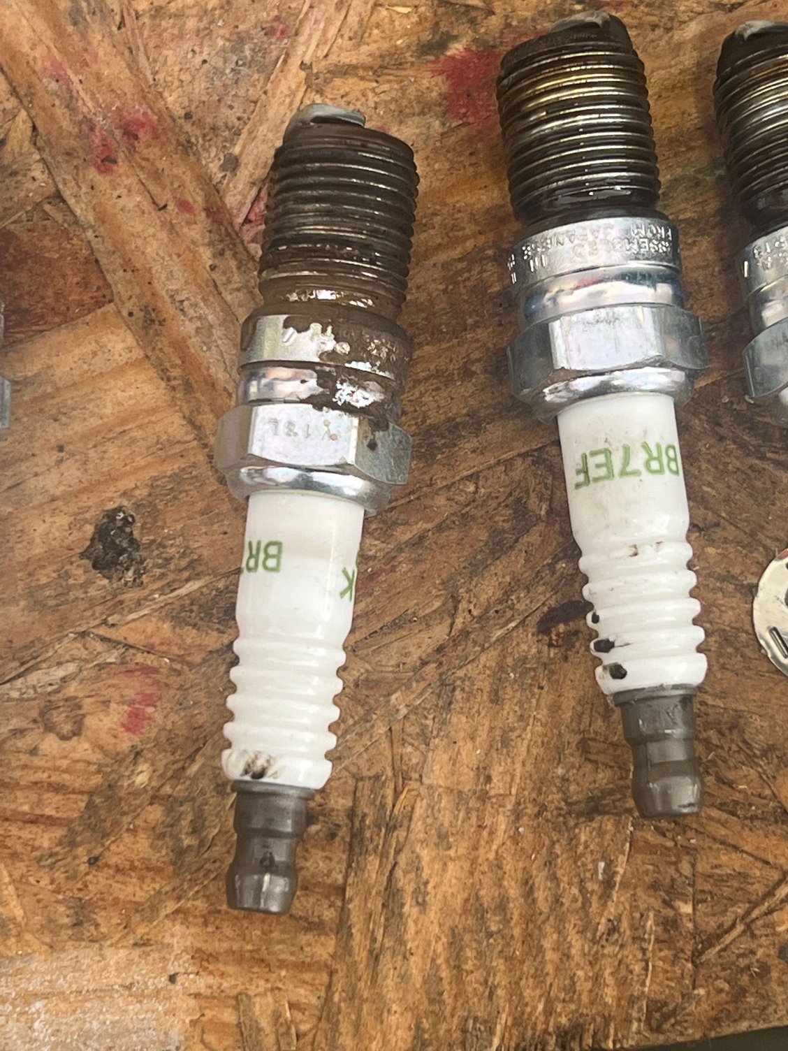

**UPDATE**
Seems I found my miss. I guess I’m a dumbass. This spark plug was noticeably much looser than the rest. You can see the blow by headed up the plug…Don’t mind the horrid looking stuff on all of the threads. I always antisieze and it seems to help but looks horrible lmao but without that gooo I guess I wouldn’t have seen this so easily.. I’m here hoping that was my problem. That being said I’m Still going to gap a fresh set a little looser than .022ish now that I think this is my issue. Gonna try and get about .25ish. Realistically I bet I could’ve just tightened that plug down a little snugger and been fine! Got my meth fittings and nozzle installed today. Primed the meth pump up. Took a while to actually get fluid going through it. Will update again later.
