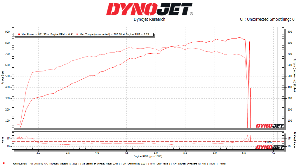

Update on this.
Dyno'd the car the other day. This is max speed D1SC to max speed D1x comparison (62k rpm vs 62k rpm). Old setup, 383 all-bore at ~16 psi to 418 at ~21 psi car went from ~700 RWHP to 851 RWHP (same static compression, very similar cam). Had to swap the motor to larger cubes to bring the boost down on pump gas - was running 24+ psi when it got cold out (too much) on the smaller motor with the D1x. Also, ran out of fuel up top (capped out 2x 340's, upping it to 2x 450's) and had a little belt slip, so car should have put down closer to 900 RWHP.
Overall, decent little blower that seems to be worth ~150-200 HP increase over the D1SC.

Nice! I absolutely love the D1x probably the most impressive centri as far as power at its size with low IAT's. I moved on to the F1a-94 and definitely gained significant power from the mid-range all the way up over the D1x, but I don't dyno my car so I can't say how much it actually picked up.
