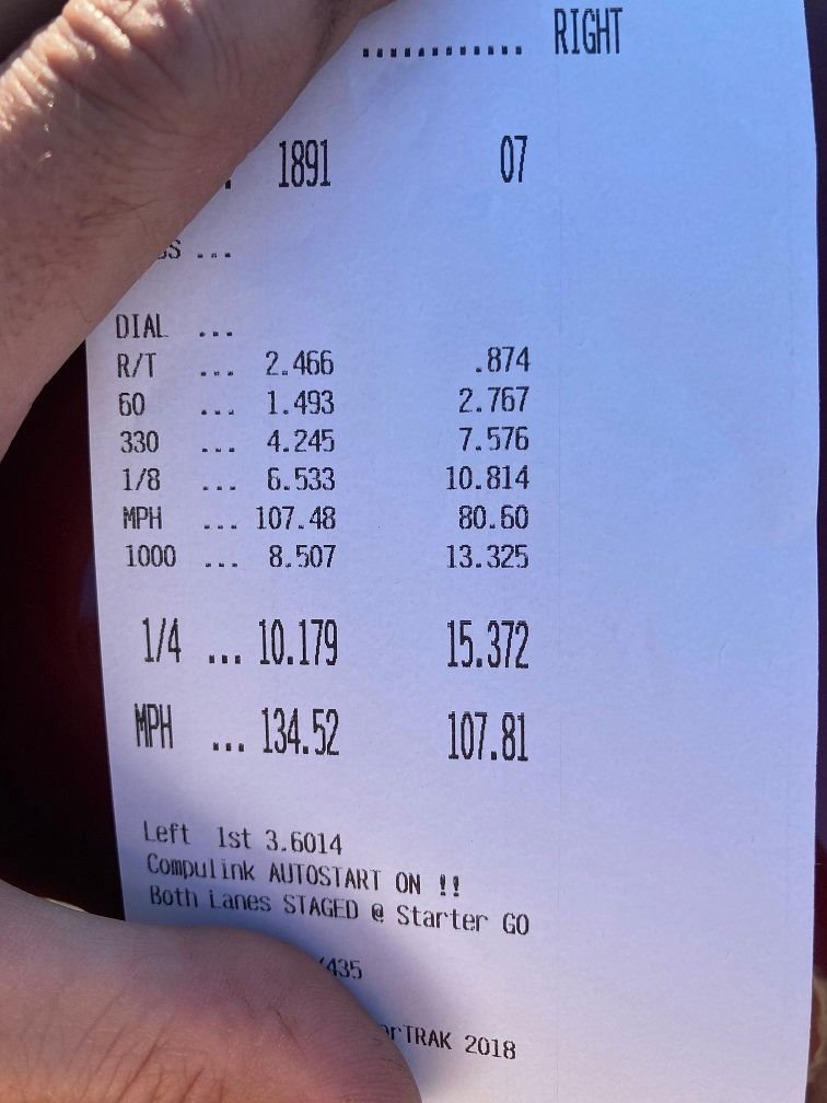

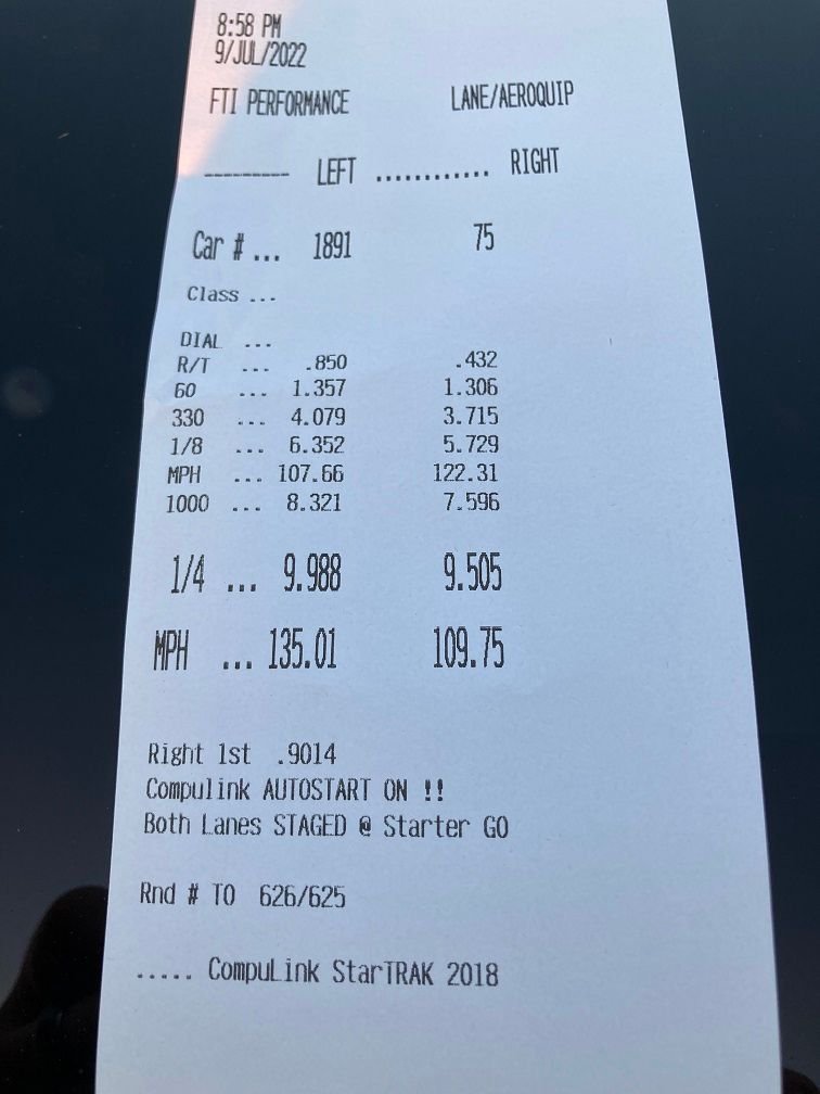

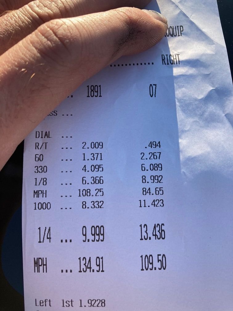

The car is running on e85, 14psi and I just double-checked the logs 12.5* of timing.
1st pass was 3000rpm 2-step 0psi launch off the brake
2nd pass was 3000rpm 2-step 1psi launch off the brake
3rd pass was 4000rpm 2-step 10psi launch off the brake
4th pass was the same as the 3rd just backing it up
1st pass
2nd pass
3rd pass
4th pass
