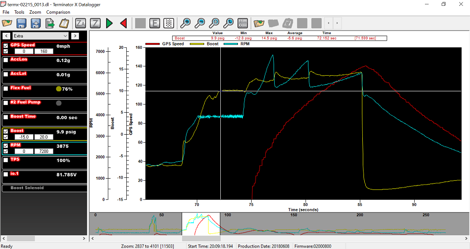

Just going through the data logs and figured I'd share this - check out the boost plot. This is on gate without boost control - my 9.90 pass. Leave on 10psi, 12.5psi in 1st, 13-13.5psi in 2nd and 13.5psi creeping to 14psi in 3rd.

Put an EBC on it and that will change, I have mine set for low boost right now at 10lbs. and it hits 10lbs. in first gear by 4,000 rpm if I roll into it and holds it there through every gear until I lift.
Comes in way quicker too.

I've got boost control setup through the Holley. I'm just waiting for bigger injectors before I turn it back on. It's in one of those weird spots, one spring in the gate + controller wouldn't be enough boost and 2 springs plus the controller would be too much.

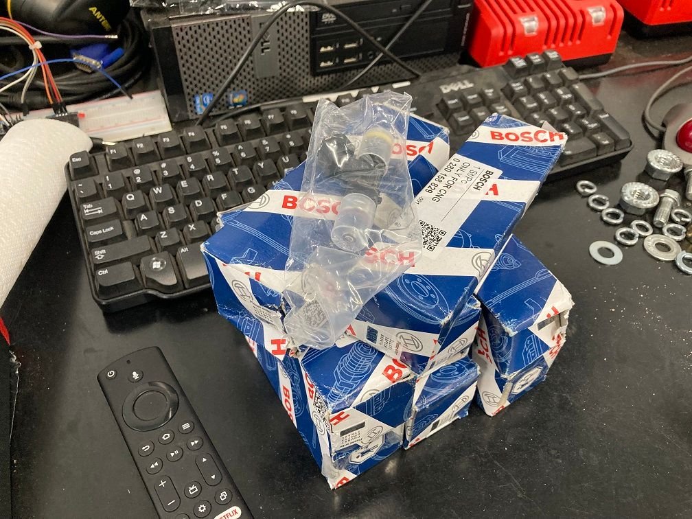

Old Nov 7, 2022 | 03:11 PM
  #39
nocooler's Avatar
Posts: 607
Likes: 62
From: Mid Michigan
Just a small update. These finally arrived, but they were held up in customs for a week. Probably time to order an engine diaper, now that I'll have enough fuel to make enough power to actually hurt something.
