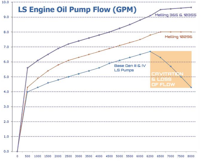

They do. So semi recently I went through a L33, and couldn't get the idle oil pressure to a point the owner was happy with, and the long and short of it was I swapped to a Melling M365 pump. It's a DOD pump. So it's not considered a high volume or a high pressure pump, but the gears are a little deeper. Here's a pic comparing a M295 vs M365
I'm thinking I'll probably run these M365 pumps from now on, definitely in aluminum blocks.

The m365 is basically a stock replacement dod pump and you can get it for 99$ on Amazon hard to beat
althought I went with a melling 10-355 aluminum 6.2 aftermarket crank, rods and pistons

I would guess you have a 10295. But nothing more than a guess. Little more expensive pump.

MEL-10296 Melling Oil pump
