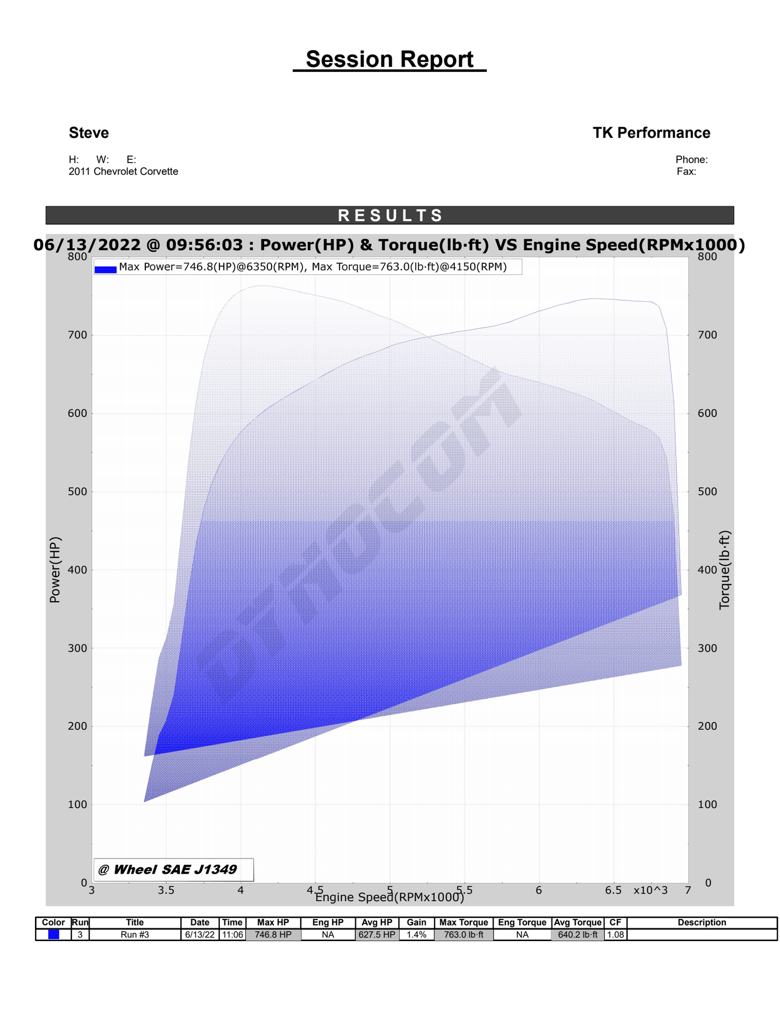

I Googled for V-3 Ti LS dyno sheet images and not found another one quite like this.
HP and TQ rise quickly. Max TQ is at 4,150 and increases 600 lb-ft over less than 1,000 RPM.
HP hits 600 at that RPM and continues to climb but at a much slower rate.
HP and TQ are about 700 at 5,250.
I'm not complaining. It pulls great.
I'd be interested to hear your thoughts.

Avg Torque is 640 ft/lb? Wow.
What does it run?
Dyno numbers mean absolutely nothing to me (though BSFC is pretty insightful).

Well, we have no idea what this graph goes to and what the full combo is so it's kind of hard to comment on much of it. I will say that it looks like a torque spike or an artificially high torque peak from a torque converter because a typical curve of a V-3 blower setup does not produce a peak torque number higher than horsepower due to the nature of how a centri blower works.

The engine is a LS3 in a 2010 Corvette.
V-3 Ti w/billet impeller, Comp Cams cam and spring kit, HD pushrods and lifters, factory rockers with trunnion bearings, LT headers, 3" exhaust, Borla S-Type II mufflers, E85, conservative tune, boost controller to limit boost to ~12PSI, 3200 stall TC, 4l65e

Dyno rpm source wasnt set correctly of they flashed the crap out of the converter. Its also showing a 1.08 CF which isnt normal.
