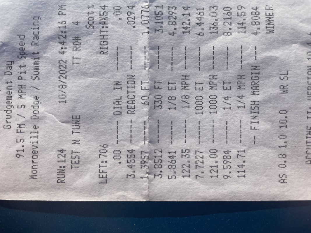

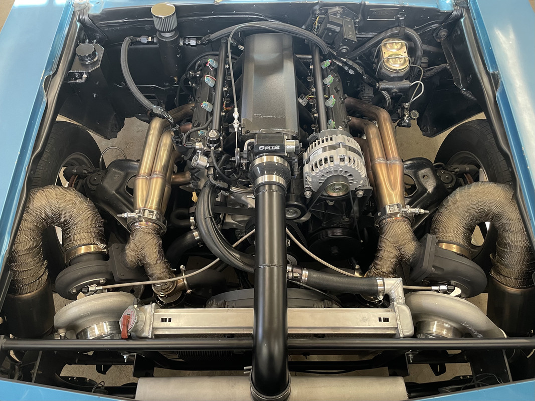

I don’t post much on here but would like to thank the group as a whole. Mainly for providing good info and help with issues. I feel like I’ve hit some goals so I’d like to post my junk lol.
Car is a full interior 68 camaro , rod and piston ly6, twin FI billet 66’s, 4l80e with a brake, circle d converte,r 3670lb race weight, Holley dominator 4.11 gear and focused on 1/8 mile.
Best pass to date is 5.86 @122 on a less than stellar track. Trying to dip into the 8sec territory which I think I need something in the 5.70s which should be no problem on a good prepped track or a little more testing at my home track.

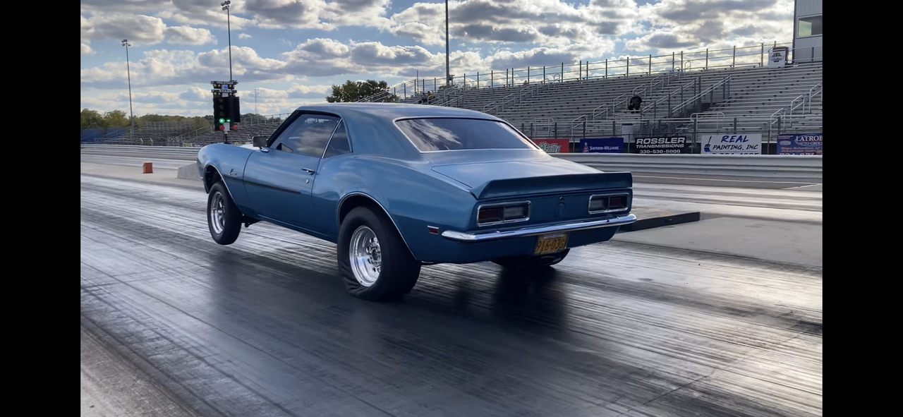

Yeah definitely…. I do a second gear leave and 4.11 gear…. My limitation right now is shock adjustment…. The rear separates very violently and front comes up too fast….. a little better shock and I’ll be good…. The 5.85 pass was a 50/50 bias with 160 on the trunk so car was roughly 3800lb…
The goal for this year was a 1.3x 60ft and a 5.xx 1/8 so I’ll call it a win for the year!

A few upgrades this winter including a better set of shocks and a bigger or additional fuel pump are a must. Also would like to note that a stiff sidewall slick (or radial) is a must for how hard these leaf spring cars separate. The stiff sidewalk 28x10.5 slick was the game changer. I wish I could run a radial but our track will not support it.

I ran a standard Hoosier slick and just couldn’t get it to work. It smashed the tire so hard when the tire would rebound it would spin. Switched to a Phoenix stiff sidewall slick and it’s been good. The Phoenix tire was smaller than the Mickey and Hoosier so I was able to fit it with stock wheel wells with some persuasion.

that’s what I needed but I didn’t have the adjustment…. It wasn’t even close….. I will never run a regular slick ever again…. Stiff sidewall or radial
