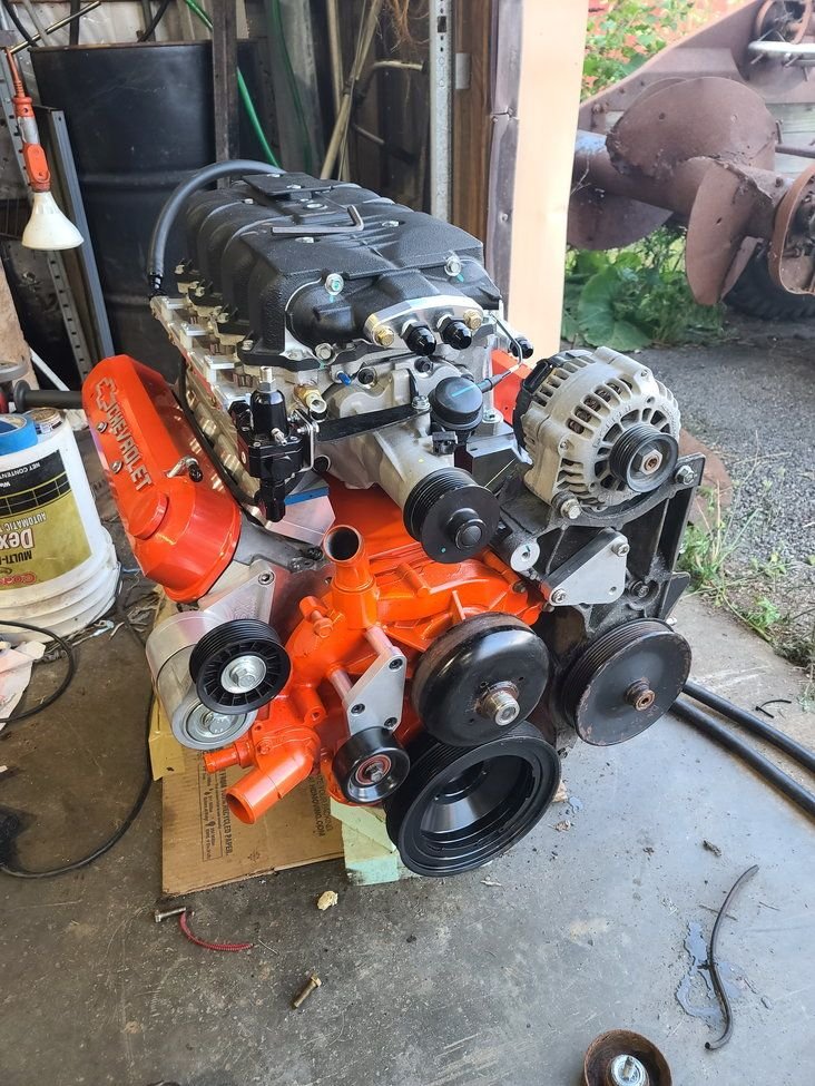

the 5.0 whipple has 1500+ hp potential just as the 8.3 whipple does. they are the same blower. you see a whipple has a male and a female rotor and one is larger than the other. the 5.0 drives the smaller rotor and moves 5 liters of air per drive pulley revolution because the larger rotor does not even make a full revolution. the 8.3 drives the larger rotor and the smaller one makes more than a full revolution moving 8.3 liters of air. I went with the 5.0 so I could run a faster drive ratio. the 8.3 version would have needed a much larger top blower pulley to slow the blower down to the same boost level. the larger pulley on top would not be as pleasing to the eye. the 305 has a higher max drive rpm. the max drive rpm difference is proportional to the difference in the rotor rpms, larger to smaller. at max drive ratio for each blower, the hp, airflow, ect is the same for the 5.0 and the 8.3.
I have never owned a whipple til now. not sure how it will sound. the noise from a roots come from the belt and pulleys. I expect the same from the whipple plus some rotor noise. again, we will see.
I am currently waiting on a .875" shorter drive snout the make things work out. I could space the lower pulley out .75" more, but that adds leverage on the end of the crank thus more wear and tear on the front main bearing.

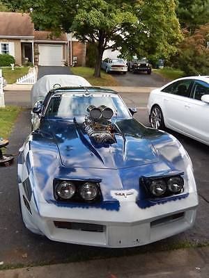

I did the exact same thing with my BDS blower on my boat and my vette I had the pulley inverted and ordered the custom length snout for a corvette water pump so the snout was as short as possible to eliminate as much deflection as possible...
I do have to tell you that whipple will NOT sound like the typical 6-71. 8-71. 10..12...14..16-71s you may have heard in the past they scream like no other and to me its blissful music to my ears. To each their own I guess. I also did the inverted pulley for asthetics as well as minimal deflection
Best of luck with your project and you must post a video or 2 when you fire it up..... I want to hear your reaction to its screaming when you do your initial fire and give it a little fuel to break it in.
Jay
Pic
Paint job is God awful isn't it???
Jay
Pic

I am running the 8mm htd drive belt and pulleys. it should still make the typical gilmer belt whine at cruise rpms. I expect it to howl at wot. we will see.

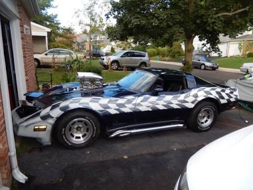

And for those of you that care or whatev's this is my vette with the BDS blower, Still love the whine but its COMPLETELY different sounding from any Whipple without question.....

@SR-71 back to your build, so you'll be running some sort of cogged/ribbed belt setup with a manual tensioner? Is there a point where you worry about the crank and main bearing wear?
still running the same 8mm idler and pullies. had to have a 1" shorter snout and 4" longer belt. I don't worry about crank or bearing wear. the belt should be snug when at operating temp and everything warm. that makes it pretty loose when cold.
41ApacheWarParty, if the headers are glowing red, something is wrong in the tune. mine have never glowed red.
not sure when I will fire it again. fedex drug their feet all last week delivering my new snout while it was in the mid 70's. this week has turned off cold in the mid 40's for highs....not a good time for an initial start up on e85 since the bypass valve will change the idle tune up. not sure by how much.

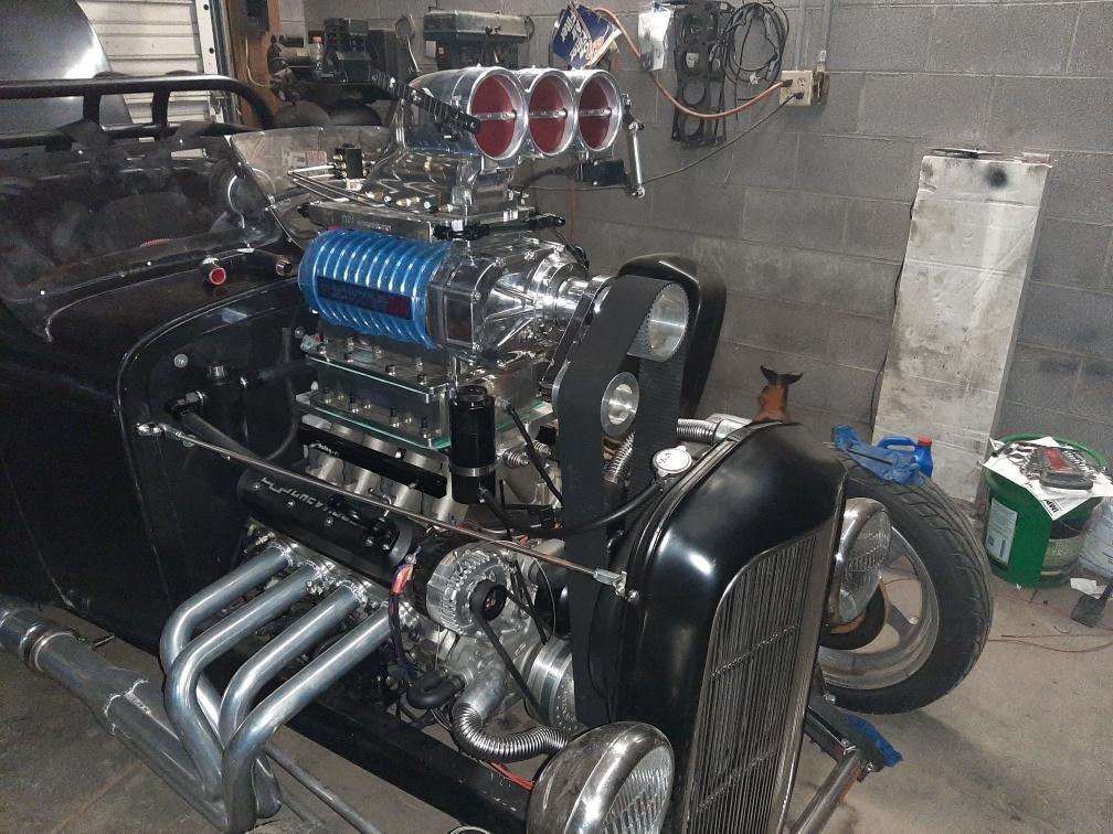

I used the truck accessory spacing to tuck the alt and ps in front of the engine so they did not stick out of the sides of the narrow engine compartment of the 32. then I just put a straight edge on the front of the lower pulley and measured to the face of the blower front cover. I prefer the dished pulley look too. it is much nicer than the flat faced look.
