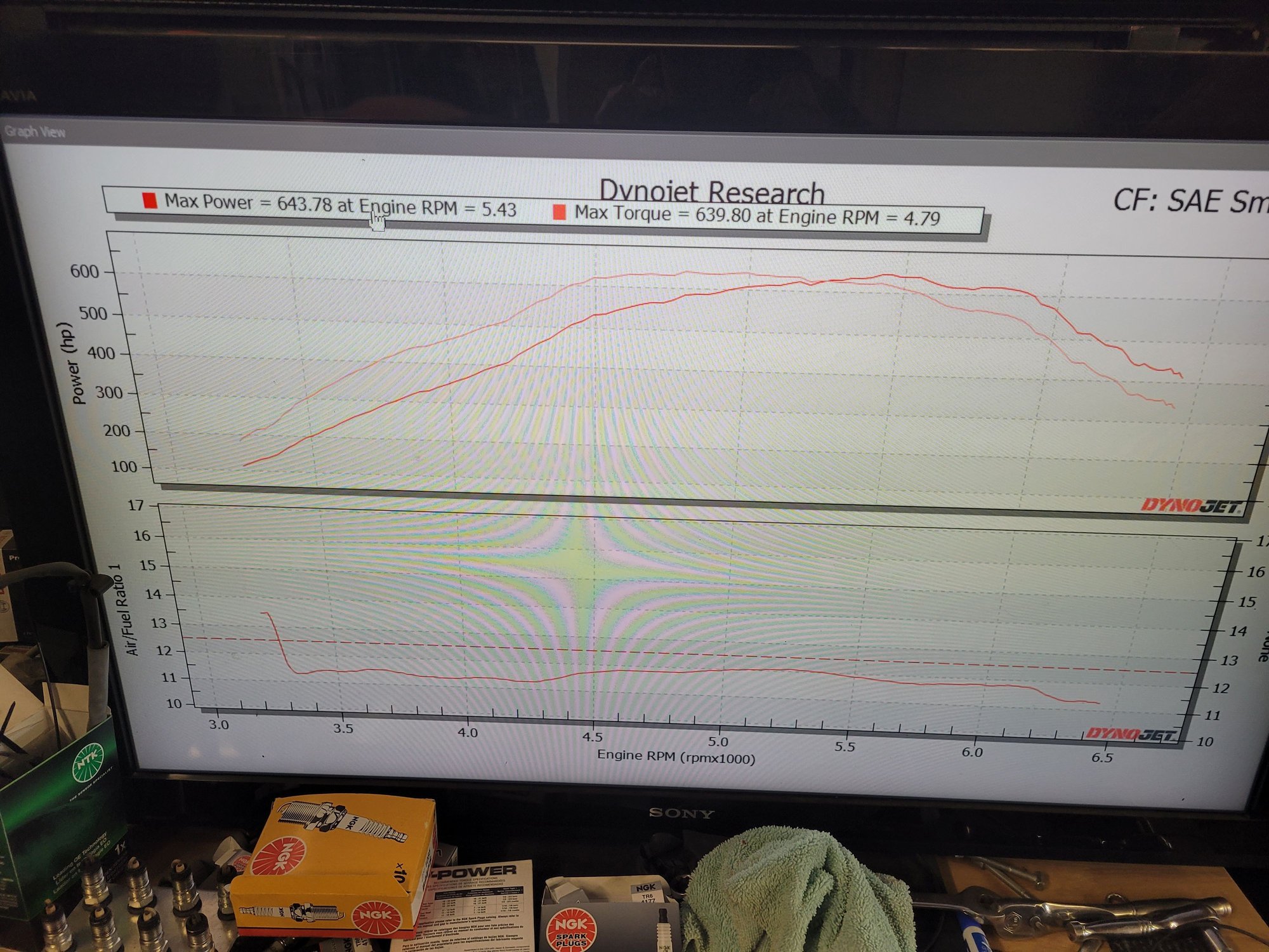

This was the dynosheet on 17 psi

That was on pump or E85? How much timing were you running there? Your peak power is REALLY low in the RPM band. Torque/HP crossover is at 5252 RPM, so you're only a couple hundred RPM above that. Get your torque to carry up to 6000-6500, you'll be over 700 RWHP easily. That's why I asked about timing. If you're not adding a bit of timing above 5000 RPM, you're probably leaving power on the table. It would be good to log fuel pressure as well, just to make sure your pump is able to keep up. I'd love to see a boost pressure overlay as well, because I have a feeling you're running into a falling boost curve due to excessive backpressure.

First I'd figure out why it peaks about 5500 RPM then rolls the **** off.
That graph looks terrible.
Pump gas 94, i kinda thought the same about the low rpm but im nee to this turbo and tuning **** lol i just put it all together, was told around 11 degrees
I thought the same thing, cam claims 5200 to 5500 but still seems to die off low in the rpm
Personally, I wouldn't start throwing parts at it yet. That cam should peak higher than that and carry out way further than that.
If the power trended up like it should at higher RPMS, you would be making at least another 100hp if not more.

If his tune was carrying 11 degrees all the way out, he's leaving power on the table right there. I'd get it back on the dyno and add 2 degrees above 5000, see if it likes it, and sneak up on 14-15 degrees. This is assuming there's not 3:1 backpressure to boost, however.
Agreed. I was thinking either valvetrain is unstable, all the timing pulled out or excessive backpressure.
Is backpressure a big problem with these, right now it's just the downpipe dumped, was going to run it to the back this summer.

Exhaust to the back will hurt power a bit, I'd run a cutout too.
What valve springs are you running and intake manifold? I'm surprised to see it not pull up top a bit more. But 643rwhp with a 5.3 and some meth sounds pretty solid.

you need to know: pressure loss through cooler, air temp pre*/post cooler, boost/backpressure ratio, exhaust temp. otherwise your shooting in the dark. what does the boost curve look like? whats the afr and max iat? 11° points to some fundamental problems of the setup (even more so with meth).
*edit: this with boost pre cooler will give you an indication of what efficiency range your compressor is operating in (find the formula for 100% adiabatic efficiency and compare you temps at 3 points around max. power).

Holdener has probably a dozen videos with that cam and turbos. I'd look at that to give you an idea of how your graph should look.
What valve springs are you using?

What intake manifold?
I've seen a few S400 turbos pull to 6200+ before leveling off with an LS6 intake, they were running the BTR 660 valve springs.
Ls1 intake, btr 660 dual springs
