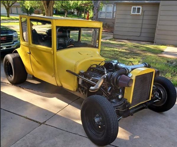

78/75 over the gt45 for sure. The GT45 is a dinosaur... heavy, huge, and performs poorly all around. Honestly a T6 S475 (or knock off s475) would be better than either of those IMO. T4's don't belong on any "drag" LS IMO. As long as you have the converter and cam setup correctly you'll make more power per pound with less back pressure on the larger housing. "Spool up" isn't an issue if setup w the correct parts in my experience.
Summit STG2 8706 would be my pick. Worked REALLY well in my 4.8. The 4.8 wants to rev in my experience. Should plan on 7k minimum and you have to cam it for that rpm. The cams you listed are too small IMO and focus on a low RPM window the 4.8 will never shine in. My super mild SBE 4.8 with stg2 and S480 in my 3100lb car was going 8.70's 7300ish RPM (and thats low) shift point.
At 2400lbs you could hit those numbers with a S475 easy IMO. Just depends what you are trying to build. The converter is also key. Go loose... REALLY loose. Esp at 2400lbs. You won't hit any of the rated stalls on the cheap converters. Unfortunately you almost need to spend money on a good converter for a combo to work well. I run the 9.5 PTC 20-5. Which should stall well over 5k. On a 2400lb 4.8 you'll be lucky to see it flash to 4k. That converter street drove great and I saw less than 5% slip up top. Also run the same converter in my 2400lb Model T.

Thanks for the insight forcefed86 !! That's a nasty little 4.8 how did you find it driving on the street with the convertor mate ? It's good to get this info from guys that have run combos that work it makes me pretty excited to see what it can do ! And yes the car is light so should run some good times hopefully although tire size isn't big that I can fit under the guards so getting that power down will be interesting 😂

It was great! Never heated up, and would smoke a 28x12 slick rolling into the gas with any decent amount of boost in it. I had to take power out. Ran 7lbs (gate pressure) to 50mph or so then slowly ramped boost up to 19-20lbs by 100ish mph on the street. At the track I’d be all in boost wise but pull timing at the TB release over 2-3 seconds to keep it planted. You don’t need much power at that weight. My 2400lb Model T is an SBE cam only 5.3. 5.50 car @ 128 on 14-15lbs. (no intercooler).
But getting a PTC converter may be an issue. I hear they are back logged quite a bit, then there’s the whole international shipping thing. Can’t imagine its magic, I’m sure any good local converter company can take the Nissan 9.5” core and put a decent 20-5 stator in it. The motors don’t make diddly down low, so you need a converter that’s rated at like a 6k stall. At 2400lbs with a 4.8 you’d be lucky to see 3800-4000 on motor I’d bet. The thing with PTC is somehow they get them nice and loose down low, yet still maintain 5% or less slip up top. Which never happened in the “old days” when I was racing turbo cars. If they were loose down low I’d see 16-18%+ slip up top.

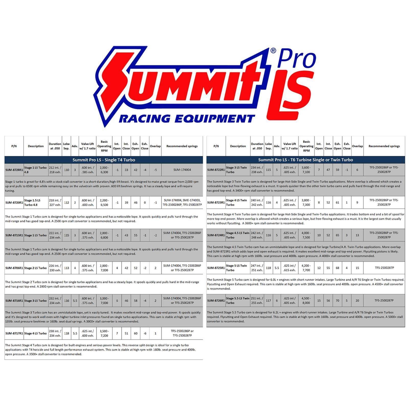

We wouldn't hesitate to put the SUM-8720R1 in this 4.8. Check out the Sloppy stage 2 vs. the world video from Richard Holdener below with a 4.8 as the test mule. He compares numerous "turbo" cams mostly in the stage 2 realm along with our smaller 8720R1 "truck" cam. The 8720R1 made right near the same peak hp as other cams. More importantly, it made more torque under the curve. The 8720R1 would be daily driver friendly but then not miss a lick at the track running it out to 6,500+. You can see Holdener ran it out to 7,000 in the video.
Sloppy stage 2 vs. the world video. See 16:30 to 18:45 in the video to see our 8706R1 and 8720R1.

Not harping on summit’s response above, I’m sure that cam would work well. Its not exactly “small”. Just wanted to say the thing I don’t’ like about Holder vids is he doesn’t race the motors. And always preaches about “low end”. I’ve built dozens of turbo LS motors and I can tell you the last thing any turbo LS needs is more low end! At least not in weekend warrior trim with a healthy converter. I’ve run the baby cams that make tons torque under the curve. Super tight LSA cams similar to the “Truck Norris” that made the 4.8 darn right snappy out of boost… but it didn’t perform near as well out at 7500 where these motor want to be IMO.
The OP is setup in a 2400lb drag toy. IMO He shouldn’t care about torque under the curve. He will be doing all he can to get any sort of traction on the street, I’ve been there… many times. At the strip, you want to be at 4k+ on the trans brake and never see below 5k once you let go of that button. The small bore motors like RPM. Shifting them below 7k usually causes them to fall on their face and lug back down in the danger zone where pistons/rods/HG are more likely to be damaged.
And I’m not talking about all out drag cars. This is SBE budget weekend hot rodder stuff.
