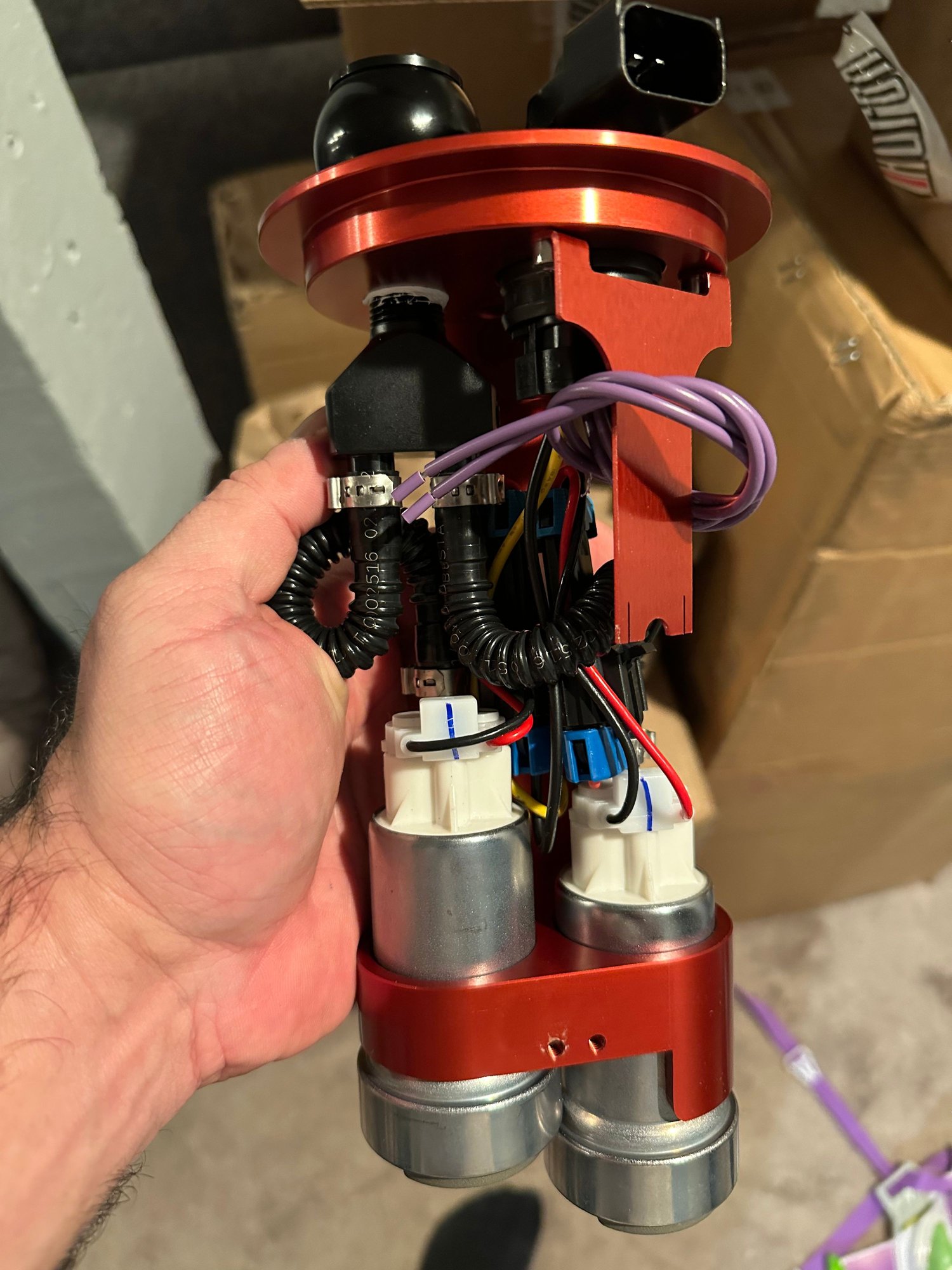

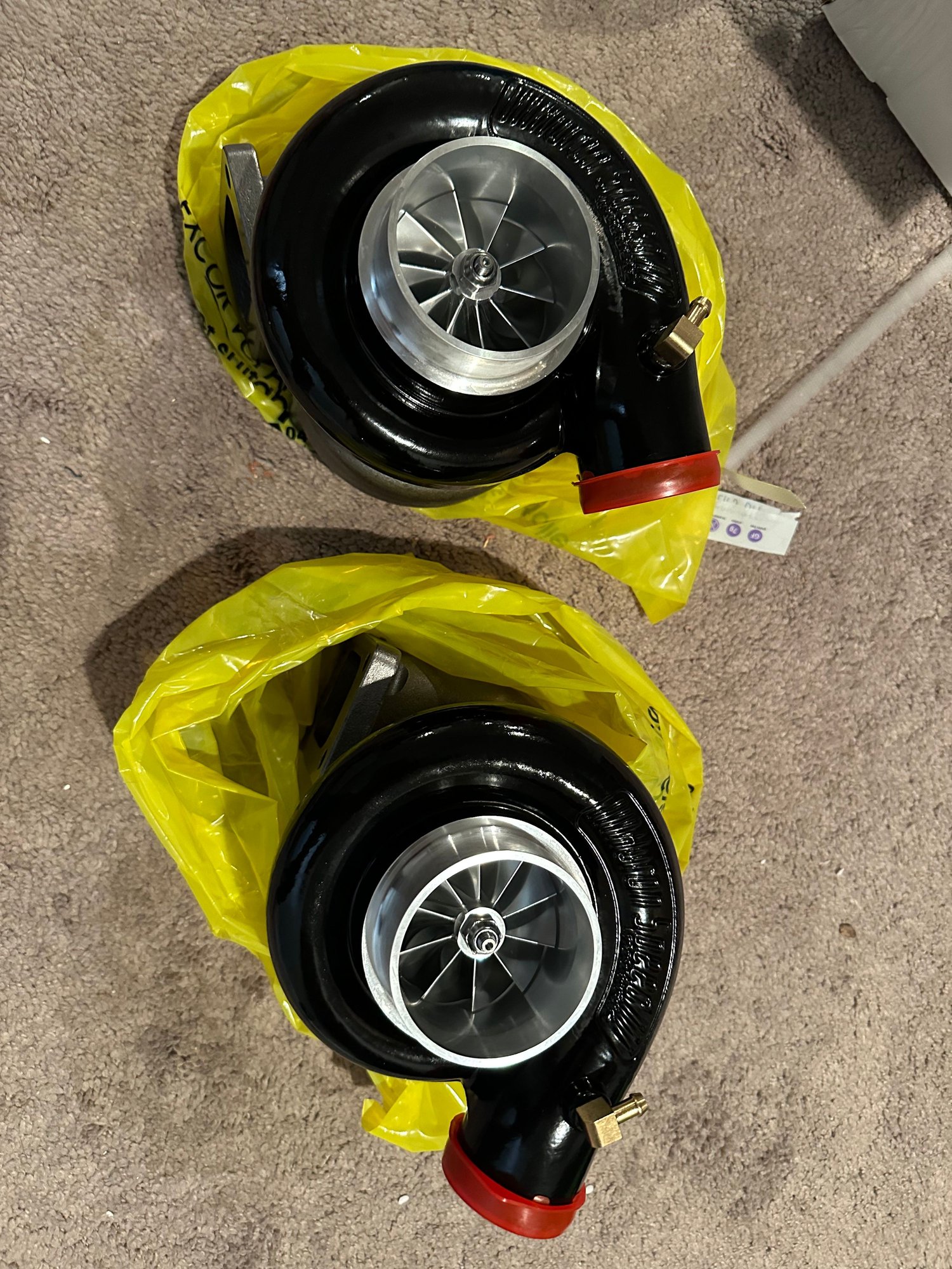

01 WS6, 93 pump, oem ecu,
stroked ls3 to 427 (4” crank), medium turbo cam (not mild, not radical), LS9 ported heads. 10.1cr
525 dual pumps, FIC 160#, LS3 intake, NW 92 TB
twin 6766, FMIC
